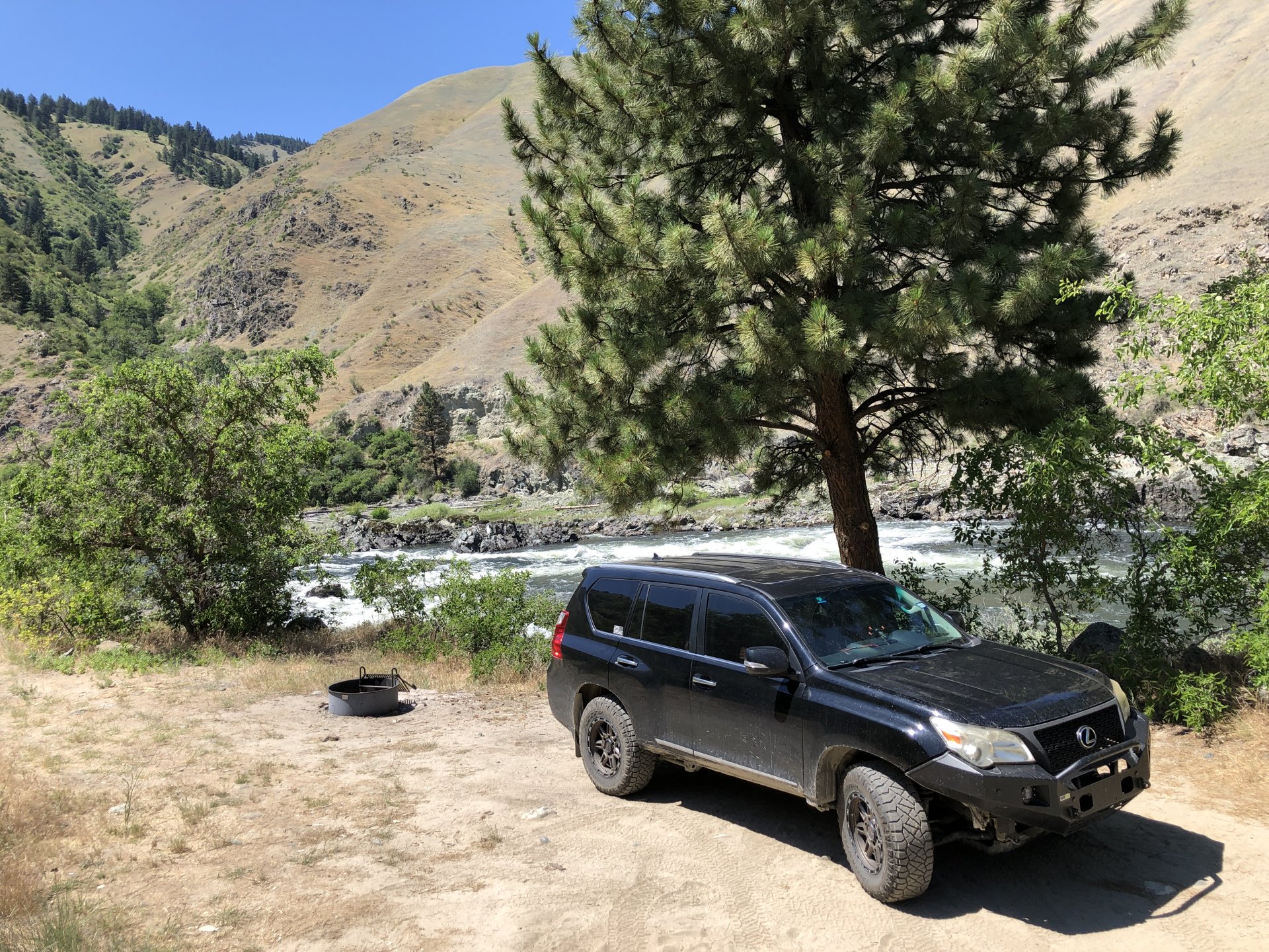

I’ve done very well on off-road trails without a lift. An off-road front bumper+265/70/17 tires+no running boards.
I would like a lift but so far I’m doing well enough without one. I wouldn’t worry about the air bags, you’ll eventually replace them with coils when they fail. Do the lift at that time.
How’s the ride with the weight of the bumper on the factory suspension?
It added about ~95lbs and I honestly cannot even tell it’s on there. Only when I panic / emergency stop do I feel a slight increase in nose dive. It is almost non-existent. Driving on the highway or around town I do not even feel that extra 95lbs. If you add a winch though you may feel a bit more nose heavy during directional changes.
