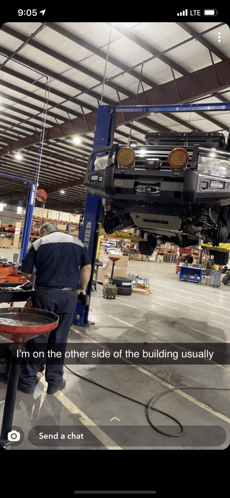

ECGS did my regear. Here's a pic of their shop from Google.
Not the best picture. But here’s the new shop. See the massive difference in size
