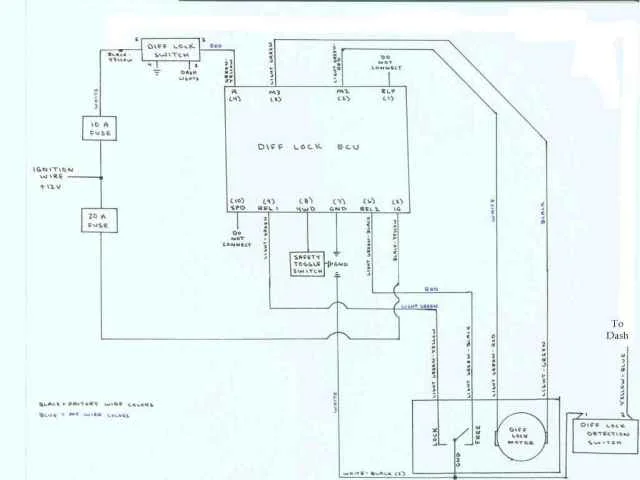

I was under the impression that the Toyota locker ran as a closed loop circuit (needs to send feedback to a controller, not just a hot wire). It may need the locker ECU from a donor truck. When I saw an 80 switch removed it looked like it only had 3 connections. The switch could be mechanically designed to make you lock the rear first. If you can part with the factory switch running the lockers independently seems possible. I wanted a T100 rear w/factory locker and found this grainy picture in my search. I think the unused connections were meant for the front diff. Sorry this picture sucks, gotta squint to read it.

The ECU that they put in the Taco/4Runner will only run one locker. You can also get one for the FZJ80, it will run both. But, those things are unobtanium in the junkyards, and a new one from Toyota is mucho $$$, like around $300 last I knew. Not worth it.

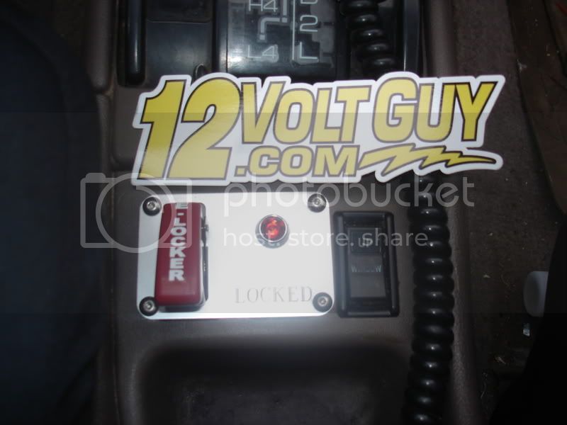

I had 12voltguy make a switch panel and harness for the TRD locker I recently installed in my front end...

The actuator has a set of limit switches in it, and a big coil spring. When you hit the switch to lock or unlock the diff, the motor really only torques up the spring, which tries to spin the gear that moves the locking cog in the diff. It's actually a very clever design. It provides for the condition that the cog splines are not in perfect alignment and can't engage. So, the limit switch inside the actuator tells the motor to turn off (so the motor isn't stalled and constantly on, burning it out). The factory wiring (and the relay systems) have a low and high current side of things, the switch on the dash and the limit switch inside the actuator only see low current, just enough to fire the relays (100ma or so), whereas the high current side of the system is the current that goes to the motor, this can get see up to 10A of current if the motor is getting tired or is cold.
The non-relay system like Inchworm sells sends high motor current directly thru the switch on the dash, and the motor limit switches, there is no low current side. I'm sure the dash switch he sells is fine with that much current, but it's the limit switches inside the very expensive actuator that aren't. I just don't think it's a good idea to be sending that much current thru those limit switches, eventually they will burn out.

You'd need one of these relay setups for each locker. The FJ80 switch is just a combo switch. RR closes one of the prongs, FR/RR closes both prongs. SO theoretically, you could also have it wired to allow the front e-locker to turn on and then both instead of the typical rear ,then both lockers.
