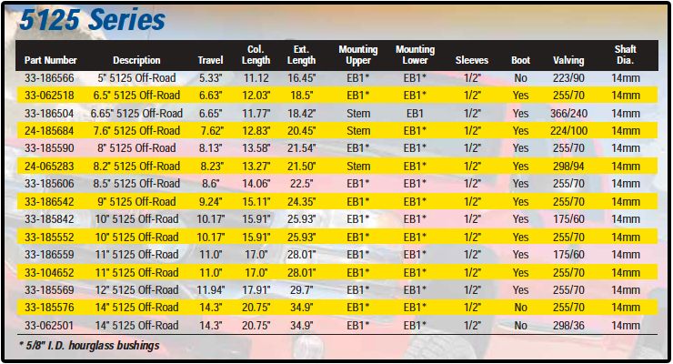

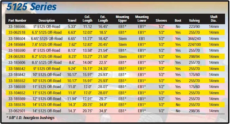

I used this chart to order my 5125's waiting to be ridden. I think the 175/60 valving is softer and meant for dual shocks.

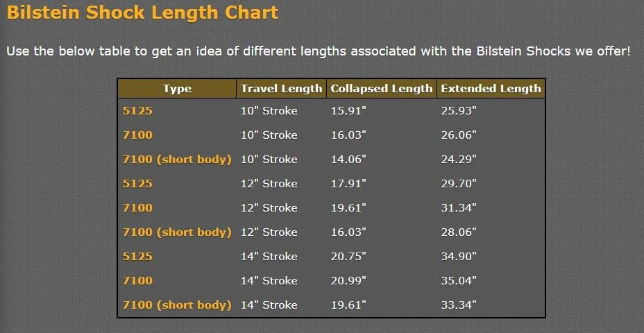

Yea, I saw the one on marlins page but it doesn’t list any valving options. What are you doing to your truck? Ok so I’m down to 2 options and would like some input... either a pair of 5165s with 255/70 or a some 7100’s with 278/75. The only issue is the 1/2” heims on the 7100’s... using the stock frame mount on my 84. Anyone know if I can swap out the heim for a bushing?? I know on the 5/8 bushing shocks you can press out the bushing and insert a bushing of your choice.

255/70 is Bilstein's ages-old standard valve stack for leaf springs. Low friction springs like the GM 63's don't have enough internal damping so the damping in the shocks needs to be increased slightly. That is what I learned when I put 7100's on the rear of Patch. They came to me with the 255/70 shims and when those weren't quite right I tried the 275/78 shims and I think that those are about as good as it gets w/o spending gobs of time iteratively building a custom damper tune.
