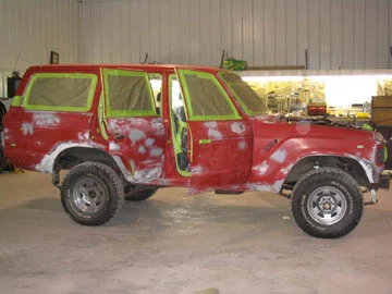

Thanks for the input. The springs are used BDS and in talking to BDS it appears they may have been early models while they were working on finalizing the specs for the current springs they offer. The numbers on mine don't match the current models. If I switched front and back shackles I would be a little too tall in the front/short in the back based on the current measurements. The end goal is to have it 1" higher in back which should give me about equal hub to fender lip measurements. At the moment I'm knee deep in trying to finish the body work and paint change from red to tan so I'll tackle this next week. There's a lot to be said for keeping the original color! Door jams, rear gates, etc are a pain to sand, tape & paint. Under the hood will remain red.

Yep, no more red! I actually like the red but a friend providing the tools and a ton of labor wants tan. I've always liked tan 60s so here we go!
gulp3000,
Nice pic ! It's kinda hard to argue with good quality *free* labor ... :D Your takin' your time ... it will come out great ! At least under it's *new* coat ... it will still be red.
