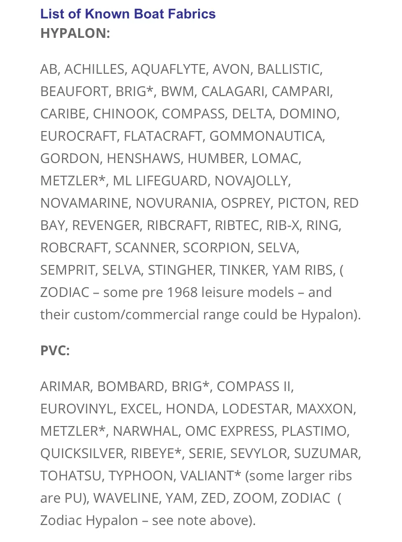

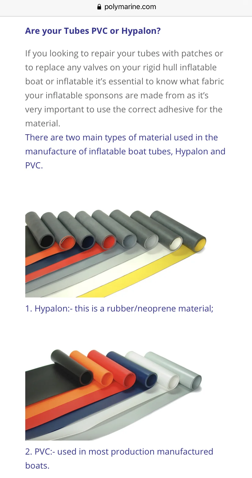

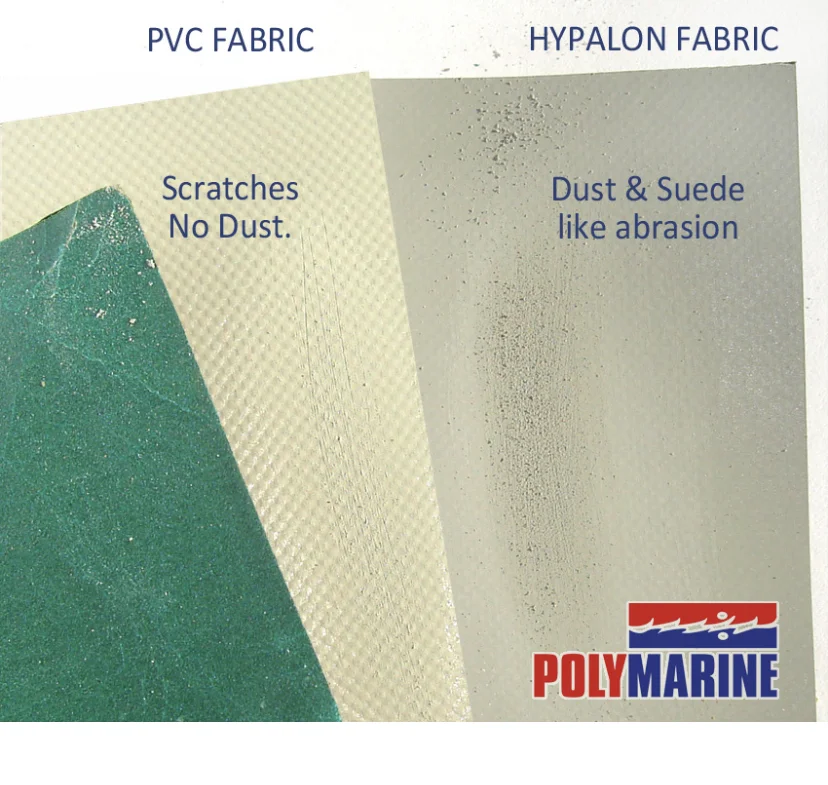

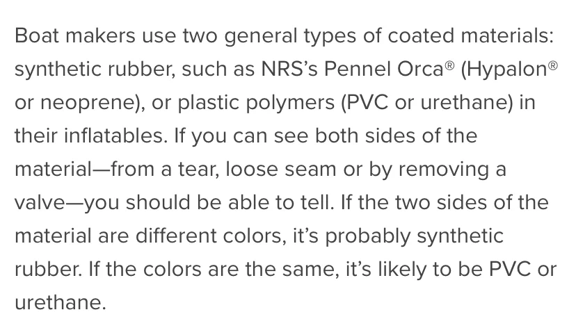

View attachment 2781737View attachment 2781738View attachment 2781739
Looks like PVC from two independent sources. Apparently I’d been asking google the wrong questions.

It’s PVC according to all the literature and factors. Haven’t sanded it yet, but both sides are the same colour and Sevylor are made of PVC. Actual Zodiac changed through the years as listed above.
