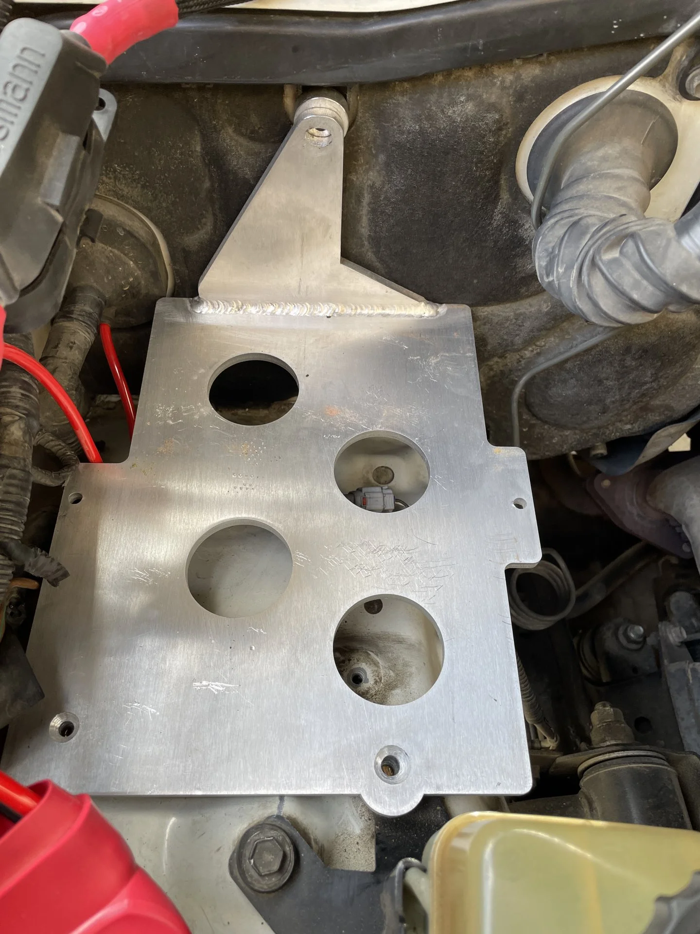

My fabricator buddy recently shared with me the site Sendcutsend and I feel like it could benefit the mud community. He owns a plasma cutter but he still found it cheaper and easier to use their site. You load a dxf file, choose your metal and instantly get a quote.
I was able to get all the pieces for my battery box in 1/4” aluminum for under 40 dollars
Did that come as pieces and you welded it together? Do you have the file for that you could share?
