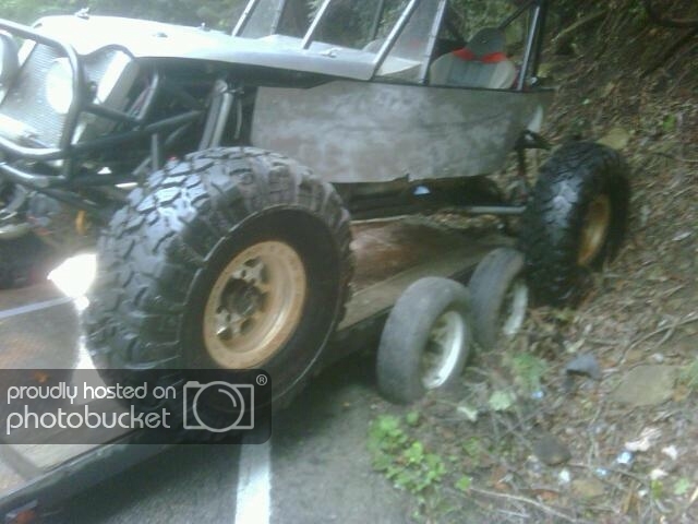

One of my buddies got in a wreck on the way to Harlan last year towing his buggy. He had his straps straight, not crossed. The impact of the wreck shifted his buggy sideways a little over a foot, almost knocking it off the trailer. It ended up cutting the inner sidewall of that tire on the edge of his trailer. I'm pretty sure crossed straps would have prevented this. He crosses his straps now!
After seeing that I am thinking I should go back to cross strapped.
