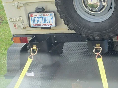

My beloved huz bought a trailer last week - just for Jane. He's committed to the 40 as much as I am.
After a stressful day at work, I came home to discover these added to the bumperettes. He says they are just for securing the 40's rear on the trailer.
Without offering any of my opinions on this - (and without insulting the man of my dreams, please :D ) How good or bad of an idea is this?

For your consideration SOMEONE mightve suggested (after the fact) that the bumperettes were a poor choice for hanging them on and that having anticipated trailering Jane - he probably couldve hung the D rings on the bumper itself (in place of the bumperettes) with reinforcement...

A couple zip ties, safety pins, rubber bands and you are set :p
That's not how i'd secure a 40 to a trailer, but then I prefer the overkill approach on everything.
Are you securing it in any other way than now it is shown in the picture??

For clarification - He is going around the axle too.
Securing to the axles will be sufficient to hold the vehicle. Securing to any point above the springs will have a tendency to loosen and pop off given the right bump in the road.
Front and rear axle. I normally cross the rear
No way would I trust the bumperettes as a tie down point. In a collision, I do not believe what is pictured would retain the 40 on the trailer.
The debate about tying down a vehicle being trailered is ages old with the two sides being tie the frame down (compress the springs) and tie down by the axles or wheels. I fall into the second category.
The key is at least 4 separate tie downs. On a solid axle rig with a simple suspension, I go with J hooks and/or axle straps. I use custom length (for the application) fixed straps on the front in order to position the rig at the same spot on the trailer every time (for weight / balance) and ratchet straps on the rear. Typical loading process is:

I have been towing off road rigs for almost 20 years and a boatload of miles and this system has never failed me. Crossing the straps on the rear helps prevent the rig from walking side to side on rough roads.
For IFS rigs, I use a wheel strap through the front wheels.

Can I mention one key point about putting straps around the axles .
Make sure you do not crush your brake lines please. Unless you really want new brake lines. I just got done replacing a line on a fj62 because of this for a customer. And he had not had it towed while in his possession .

That's exactly his reasoning for using the bumperettes.. generally he over secures towed vehicles..he is worrying about the old brake lines..he has some ideas. We shall see..thanks for all the awesome advice!
