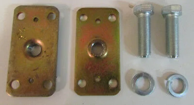

Look at these plates and notice the threads are formed in the plate and the area to spot weld them is well away from the threaded section, they should be an alloy plate and those threads will be hard ( think grade 8 nut ) and any welding close to the threads would change the heat treat.
