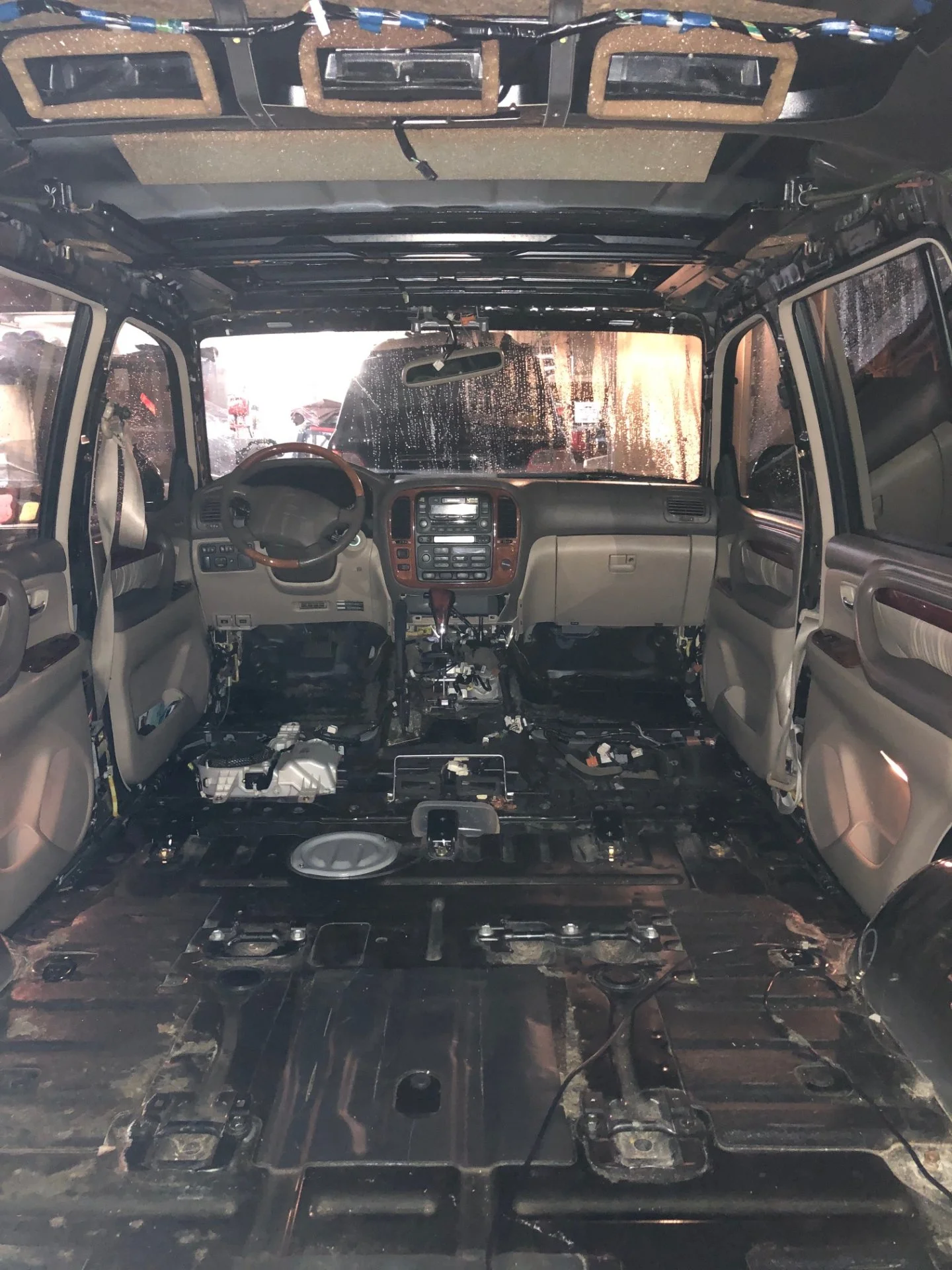

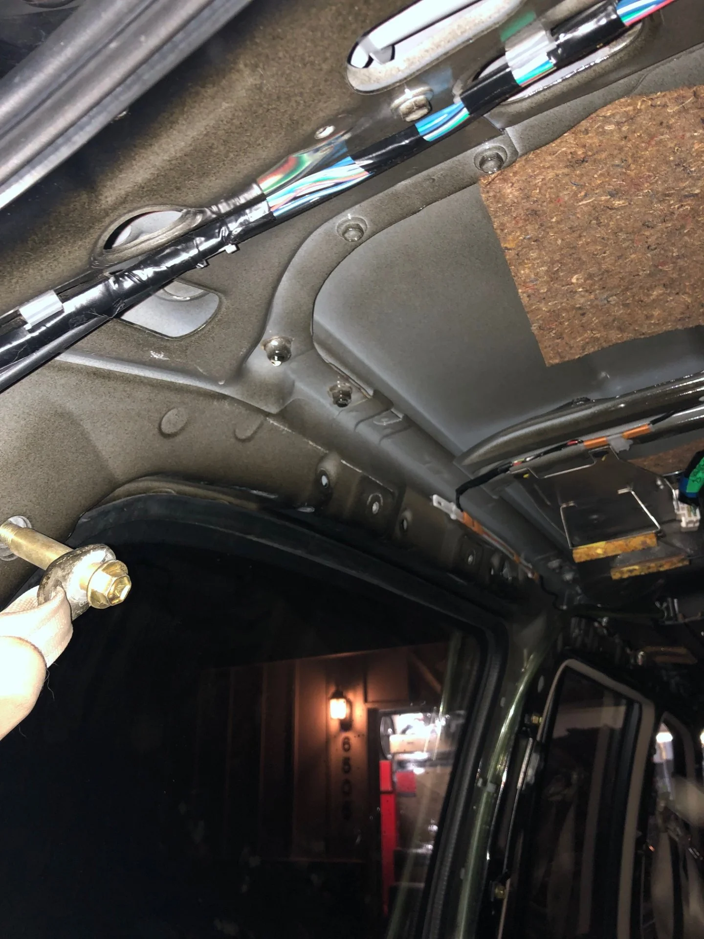

I have a serious water leak coming from the roof racking mounting bolts on my 2000 LX 470 and I'm having trouble finding any information on the best way to seal bolts. Any help is greatly appreciated.
Also, the trim piece around the base of the rack mounts needs replacing and I can't find the part. Ideas?
Thanks.

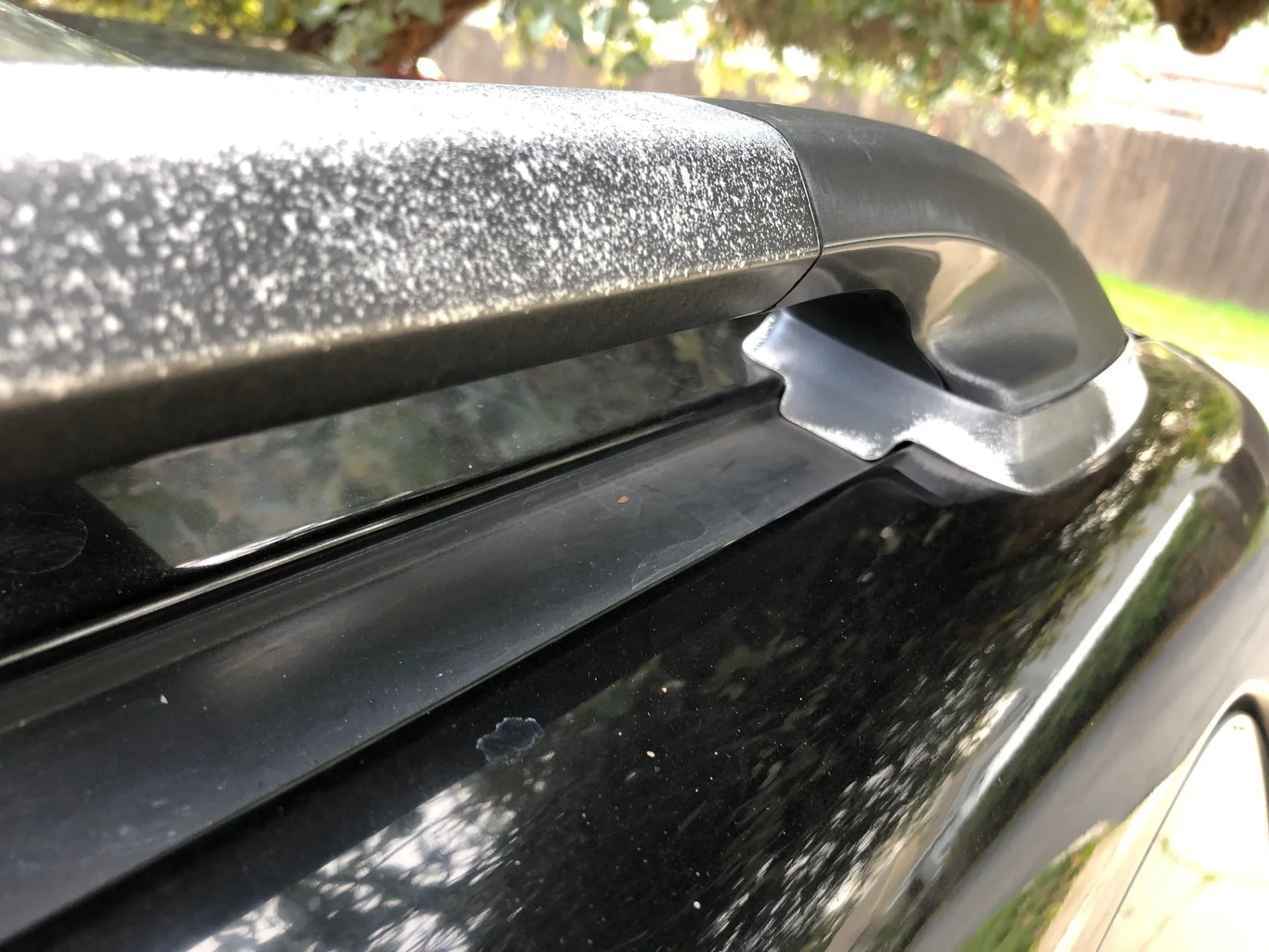

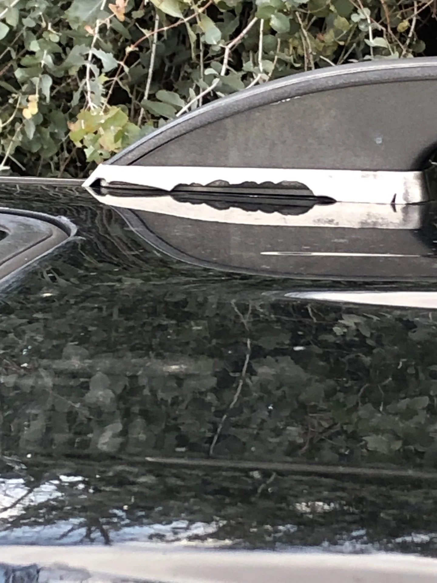

Thanks for all the great information. I'm hopeful I can just remove the driver side rack and reseal the two mounting points without too much damage to the rack. Does that sound reasonable? Will I have to remove the Roof Drip Finish Molding?
Before you put the headliner in I would suggest running a garden hose around on the roof to test for leaks, especially on the sunroof area-the pic showing the sunroof looks like it is either open part way or may need some adjustment?
Thanks for the advice. I agree, the sunroof looks like it's sitting a little low. However, I don't think the seal between the sunroof and the body is leaking at all as the drip trays are completely dry after running the hose. I believe the seal between the glass and the seal is leaking at the center seems in the hard plastic. I've applied some "fillable" glass silicone in hopes that is will stop. As for the roof rack, the sealing surface is very small on the mounting bolts, but I applied a generous amount of silicone and have let it set for 3 days due the cold weather. Tomorrow I will run the hose on the roof and see what happens. If it still leaks at the sunroof, then I'm going to replace the sunroof seal or sunroof/seal combo, not sure yet. If the roof rack bolts leak, then I'm going to have to find a better sealant. Lexel was my first choice for a sealant until I determined the seals on the roof rack are rubber...which is about the only thing Lexel doesn't stick to.
Garden Hose test completed today. No leaks detected. Time to start rebuilding the interior.
