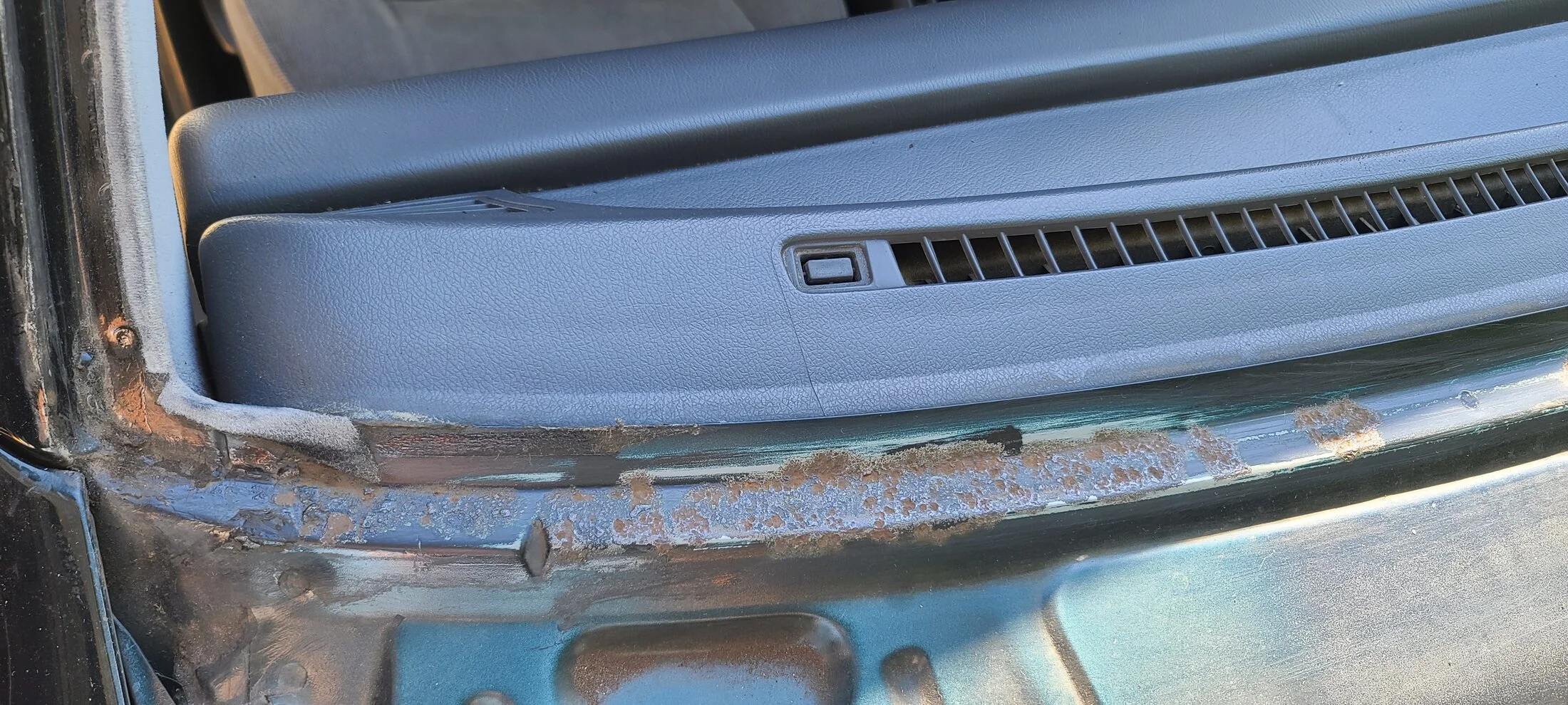

I have a windshield that was installed improperly, a little rust under the corner and the gasket isn't super tight. It's not leaking yet, but I'm waiting. Unfortunately, I don't have the money or space to pull it, take care of the rust, have it reinstalled. it's winter and it's not in the cards financially.

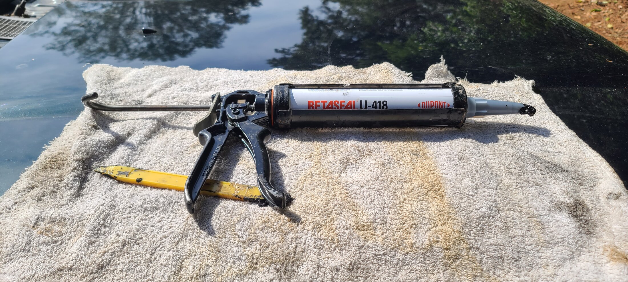

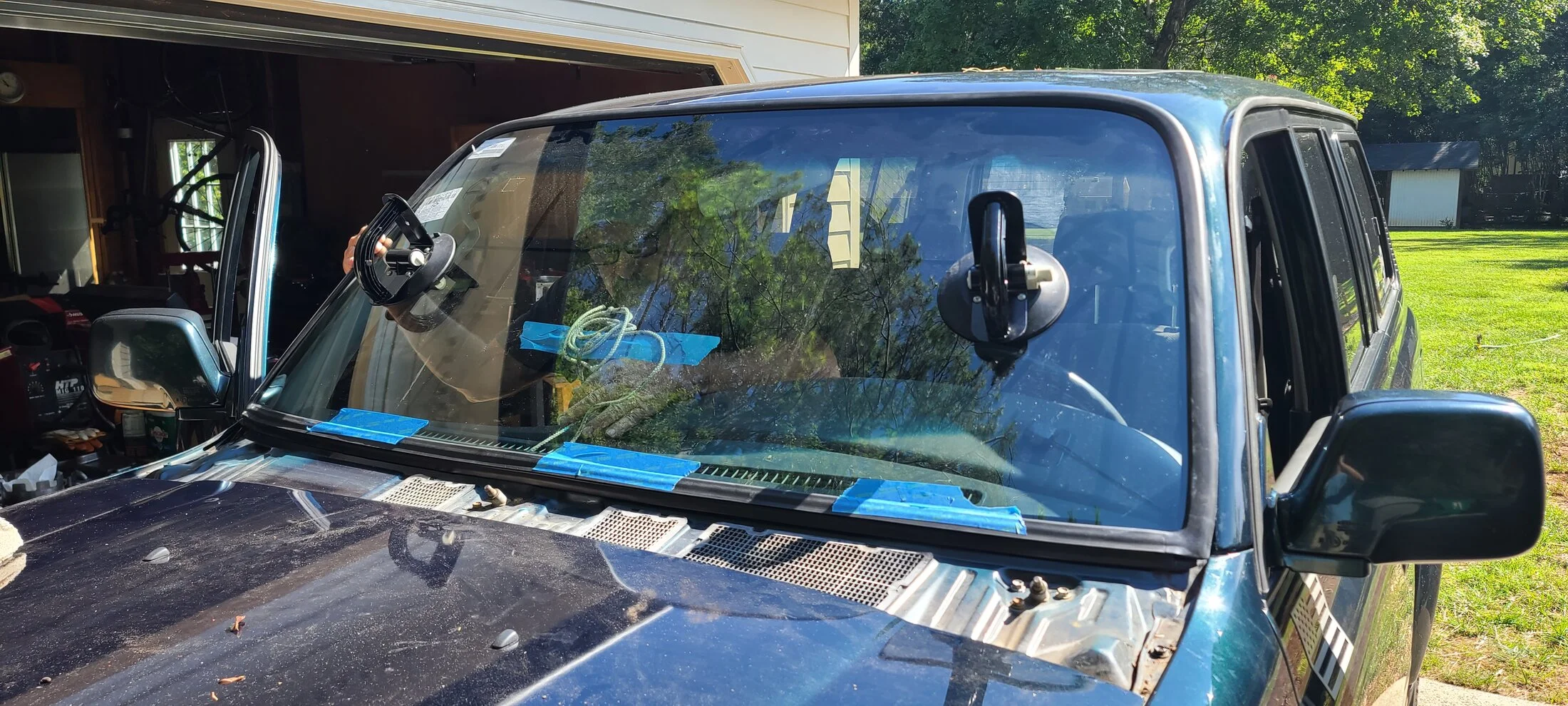

Agreed. The gasket is $50-ish. You can get two suction cups at an autoparts store on loan. You can use a shoestring (literally) to remove the gasket, if you're really on a budget.
Use this and be done with it:
Dupont BetaSeal U-418HV
Takes an hour, without bodywork; this took me two, to clean, derust and apply Oshpo:
