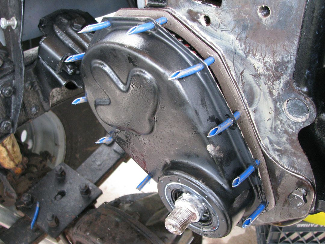

I happen to hate scraping gaskets so I’m a big fan of never seize. I only use sealants in a very few select places. Like between the valve cover and the gasket. The gasket it glued on to the valve cover with Permatex and then never seize on the bottom of the gasket. I can take the valve cover off numerous times and use the same gasket over and over with no leaks. Differentials and covers, side cover, water pump, t-stat housing, timing cover, transmission top plate, pretty much everything gets never seize and I don’t do any gasket scraping and get to re-use gaskets if I don’t have a new one handy. I’m not cheap. I just like the speed of pulling a cover and getting it back on quickly without scraping.

You wanted pics so here's a few.
