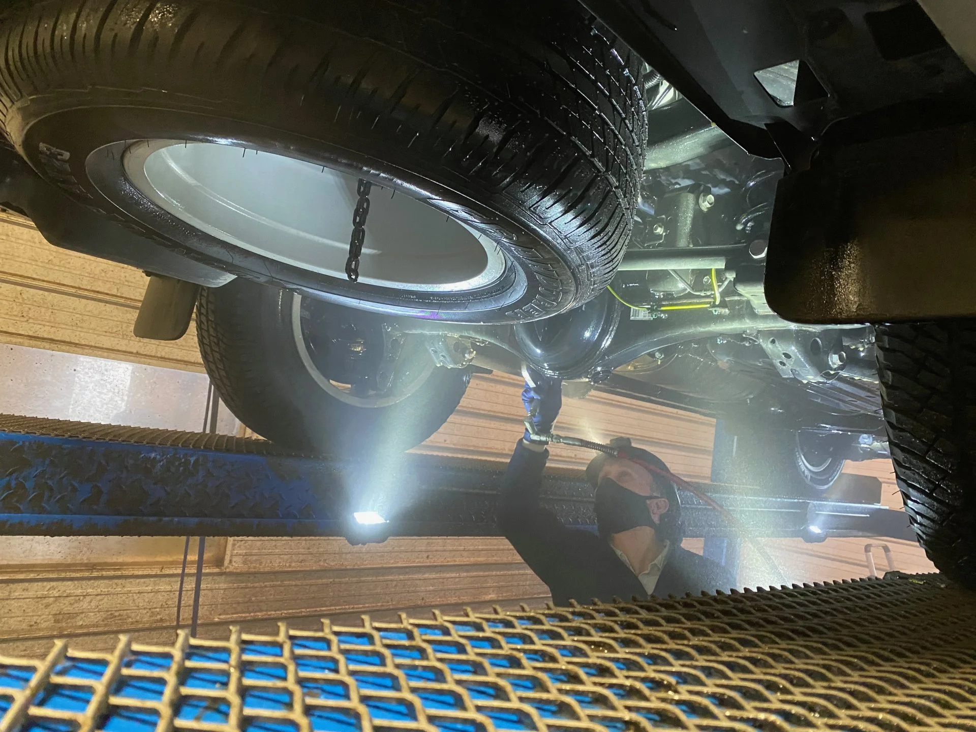

That being said, I had a Krown dealer in Amish country north of Ft. Wayne, IN do a phenomenal job on my '18 200 LC today! Very thorough with great attention to detail. He does it full-time, and I am completely satisfied. Drove 2 hrs. one way to get it done. I will bring my '13 LX 570 in next.
If anyone in Indiana or Southern Michigan is interested, ask for Rufus. Yep, Rufus. He's the man.View attachment 2879462
Thanks for the info on Kanagy Krown! I had my LX done with Rufus today and he did a spectacular job! He has a sweet setup up there in Grabill.
