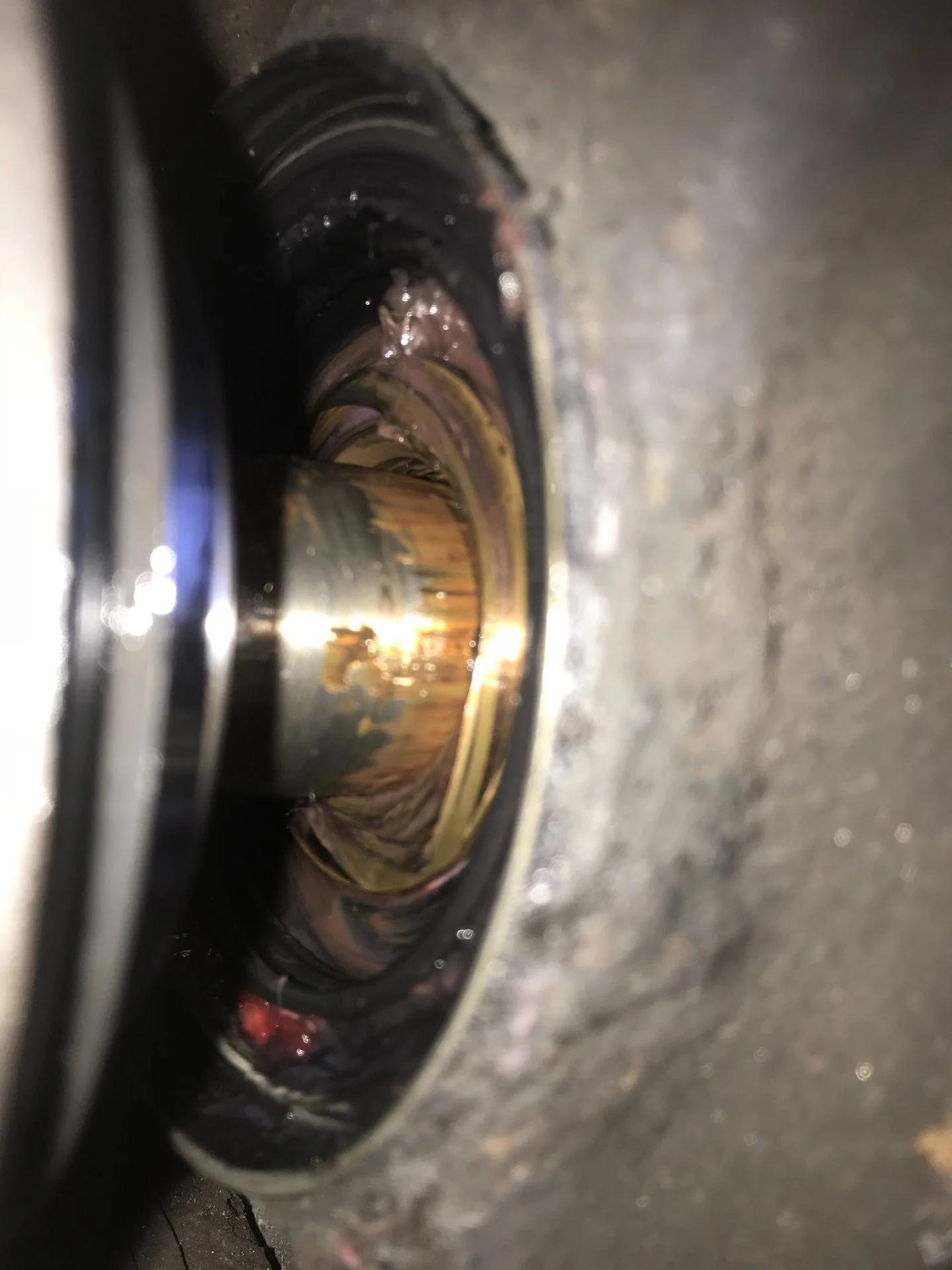

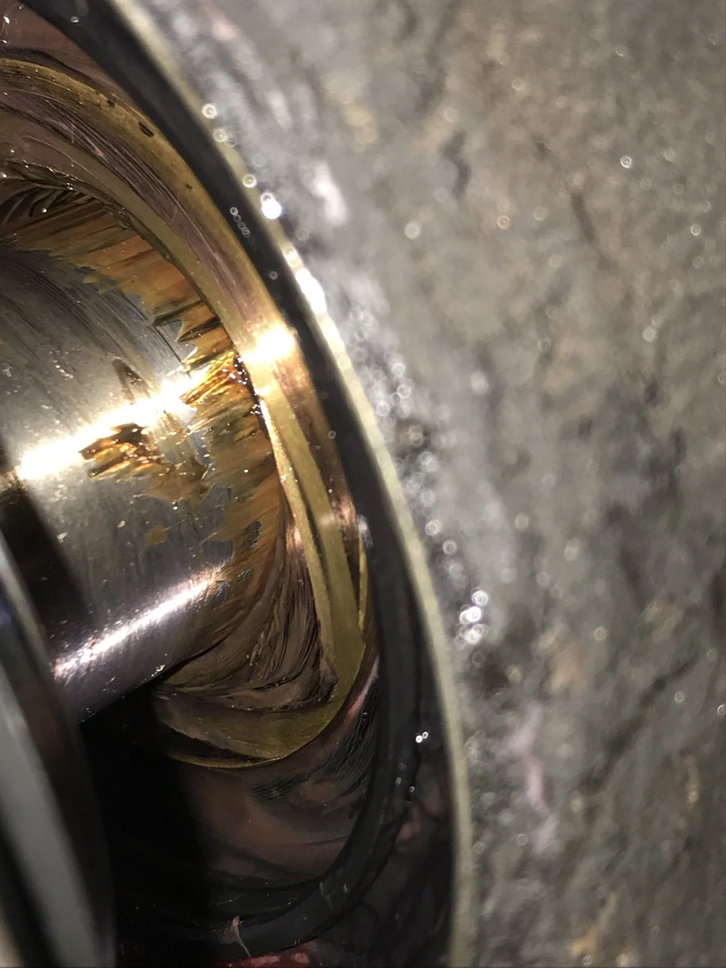

Hello, got my 2006lx with 97k miles apart trying to figure out a scraping grating noise that only occurs on hard left turns and seems to be coming from passenger front wheel. Things done previously are replace pads with all new Lexus shims and hardware. Pry back rusty dust shield to insure not rubbing. Repack bearings making sure preload is good, no play in bearings at all. After repack the noise got slightly worse and since I had used a tighter tolerance snap ring I decided to look at brass bushing. It has some kind of elliptical pattern groove cut into it. Could this be source of noise? Why only on left turns? How do I fix this? Thanks!
Ok great. Any thoughts on the scraping noise that only happens in left turns? Could a cv joint going bad do that?
At 97k OEM CV's should be fine, unless the boots ripped a long time ago and all the grease is long gone. But you'd see all the dried grease flung out everywhere.
Thanks for the reply’s. This noise really has me stumped
I’m starting to put this back together, any other thoughts on what to check while hub is off?

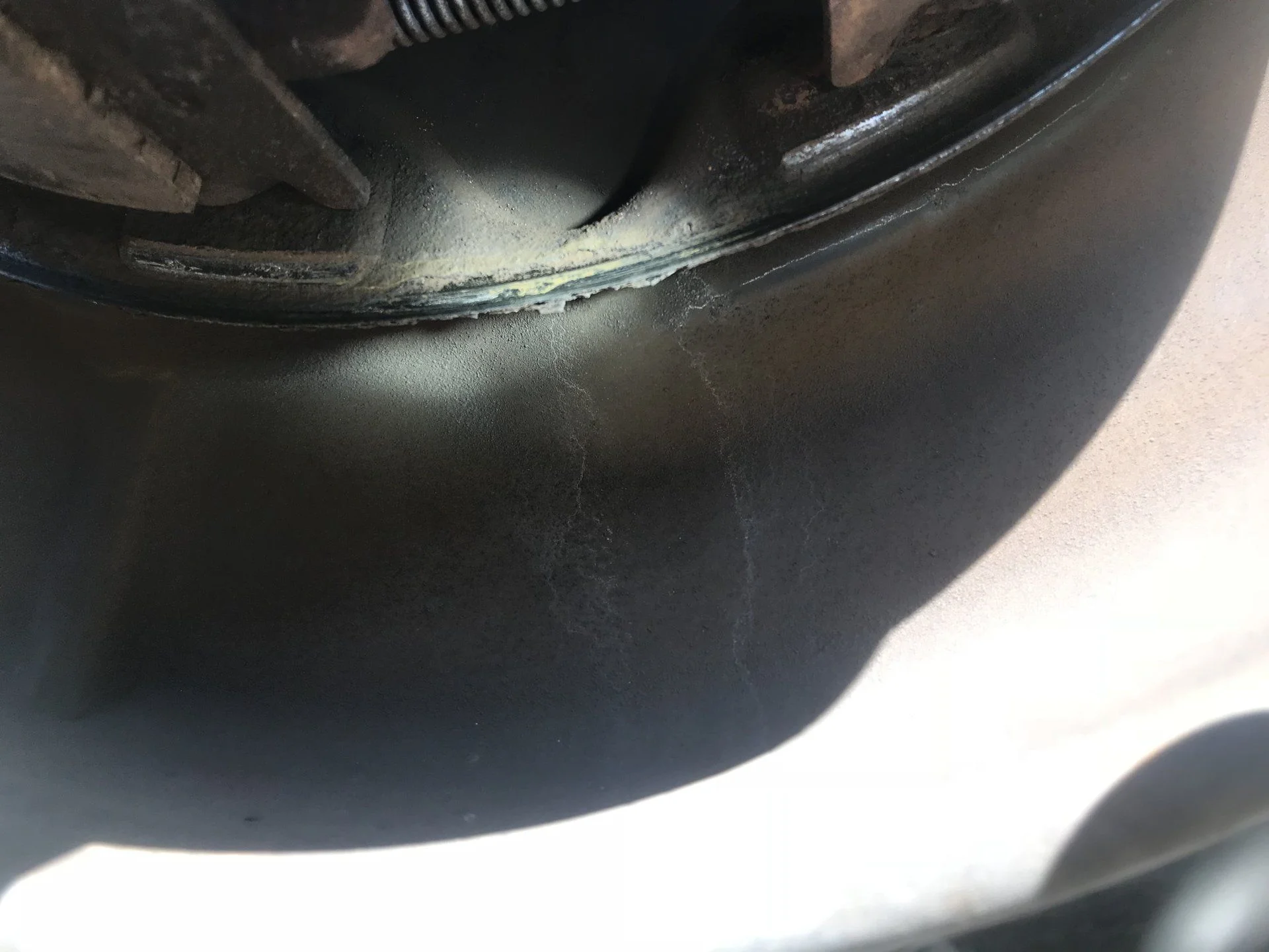

Problem solved. Lower inner dust shield on passenger rear tire was rubbing in turns. You can only see this once rear rotor is removed. You can see the shiny parts on bottom where it was making contact. Some gentle persuasion with the brass drift and all is good. Thanks for all the help!
Glad you figured it out! And no $$$ spent!
