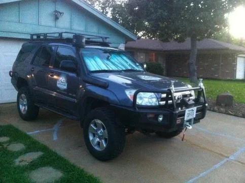

I'm getting to the point where I need to put together our rig tool kit and I'd like your feedback. A little back drop for you... Our rig will be in the remote mountains of primarily Honduras and Guatemala and although we won't likely be days from help it could be several hours. So I would like to be prepared but I don't want the whole rig to be tools and in fact I'd like it to fit in about a 2'x1'5"x10"tall case... I don't have the case yet I'm just giving you an idea of a good size. Our first rig is a 2005 4Runner V8, so what size wrenches, sockets, etc. are needed? I am planning on having a ARB compressor under the hood. Thank you in advance for your help!!!
-Daniel
I guess I should add that we already have a winch, high-lift jack, shovel, axe, pick axe, solar panel for battery charging, gps... Plans for compressor, inverter and dual batteries. THX!

I've done 95% of the work on our rig myself and am building our expo trailer so yes I feel confident on working on it if I have too. I defiantly realize that there are a multitude of sockets and what not for everything... Which is why I said I don't want my entire garage of tools and fab EQ on every trip with us.
I'm looking for a "What have you taken on every trip with you and what is needed most of the time"! Thanks!
I would like real time experience answers of OMG "I wish I had brought..."!
Oh and yes tire change gear is actually already on our rig. Plus we will almost always have 2 spares with us.

I choose the newer rig cause for me I don't want the time when we first get there to be wrenching on our vehicle. :) Since when we first get there my time will be consumed with building our house/ store front and lining out our land with coffee... Whew I'm tired already!
Good input so far...keep it coming! Pictures of your recovery, tools, supplies, etc... I'm going with Pelican cases to house most of our gear.
