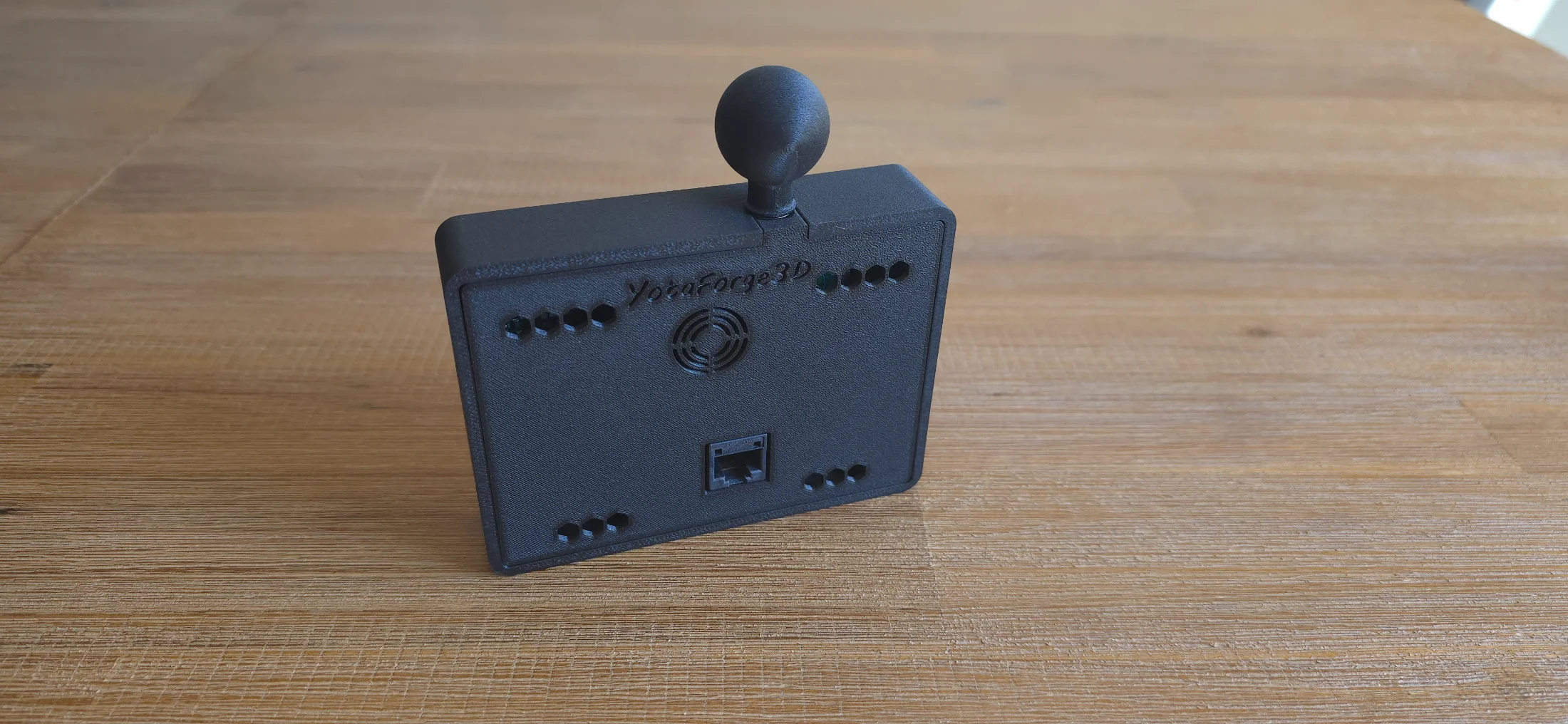

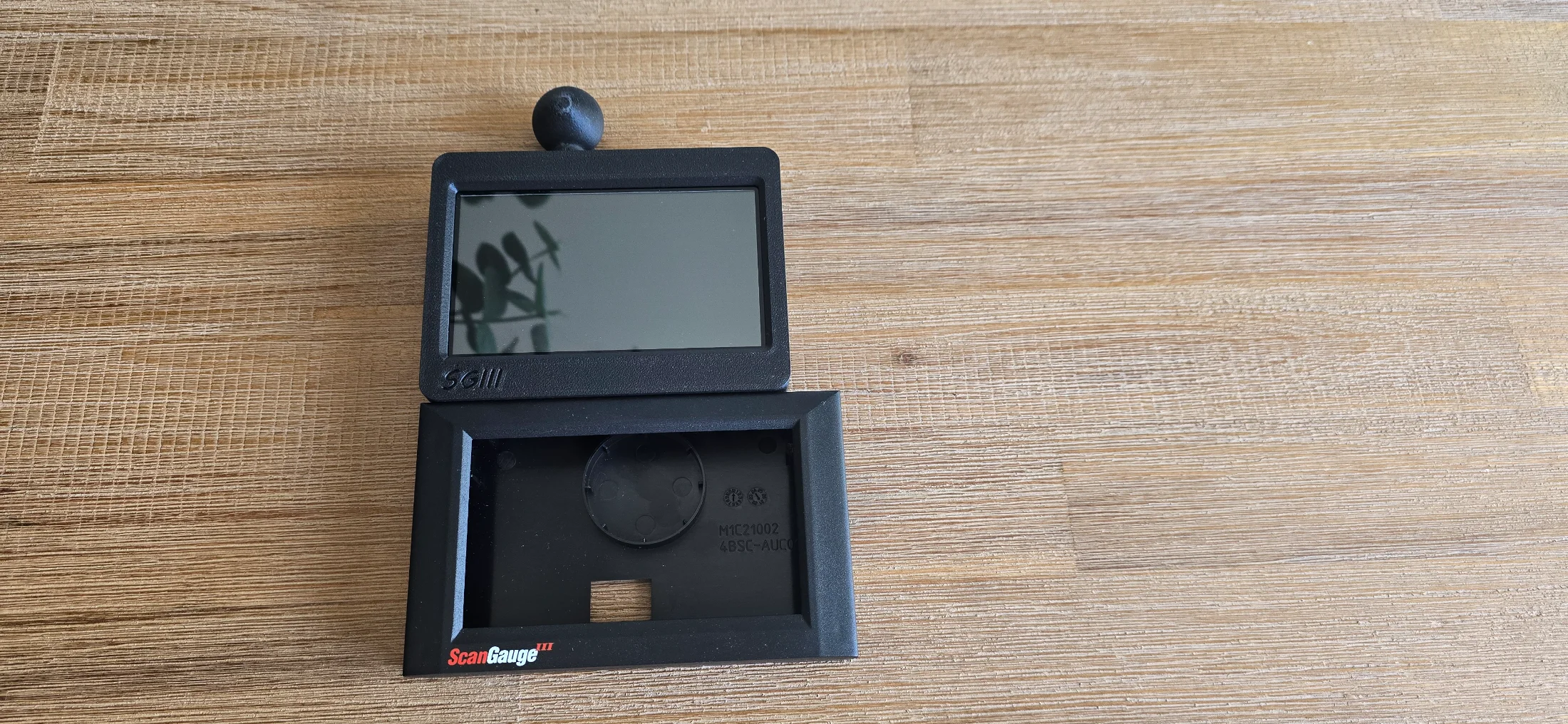

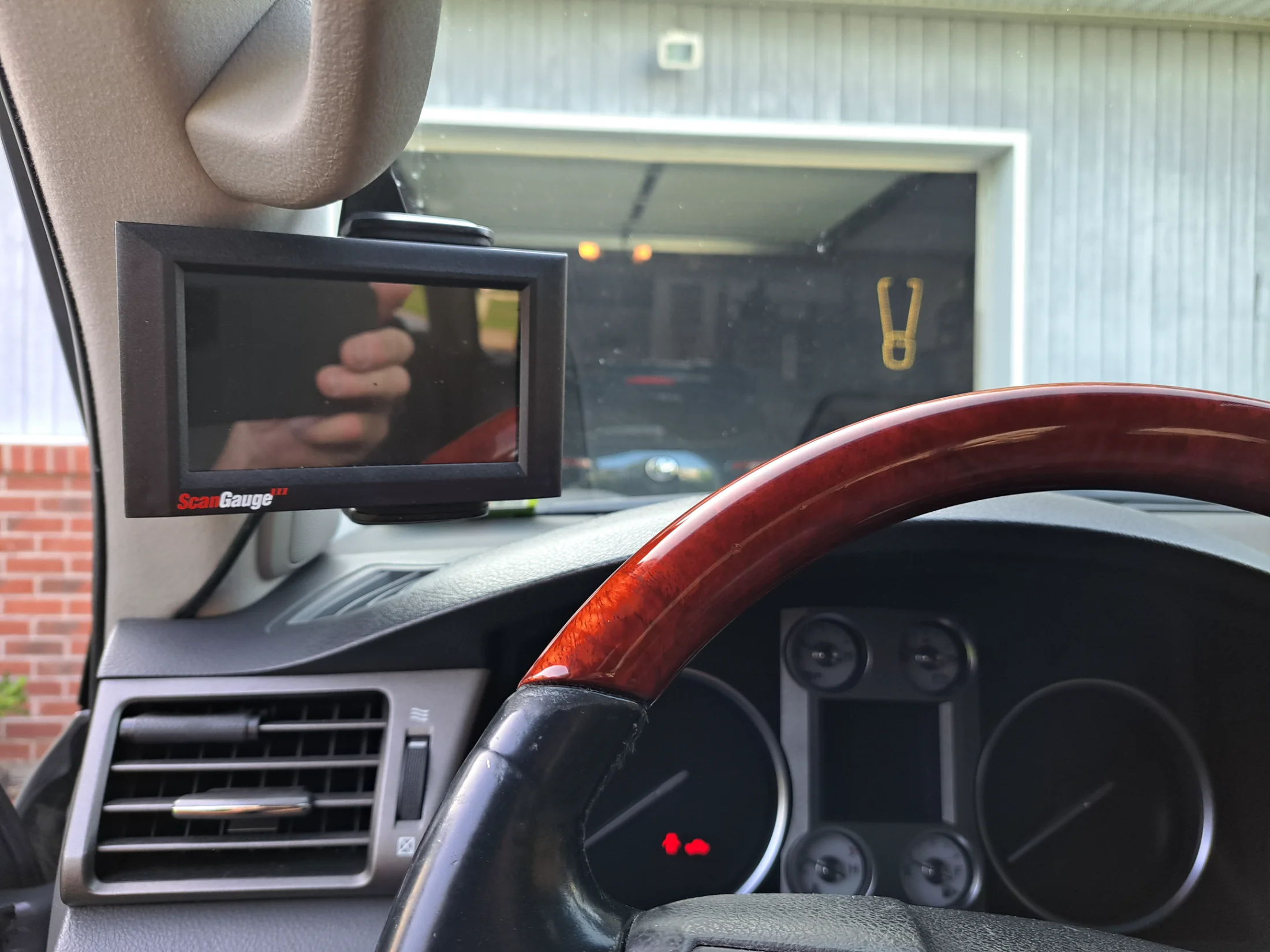

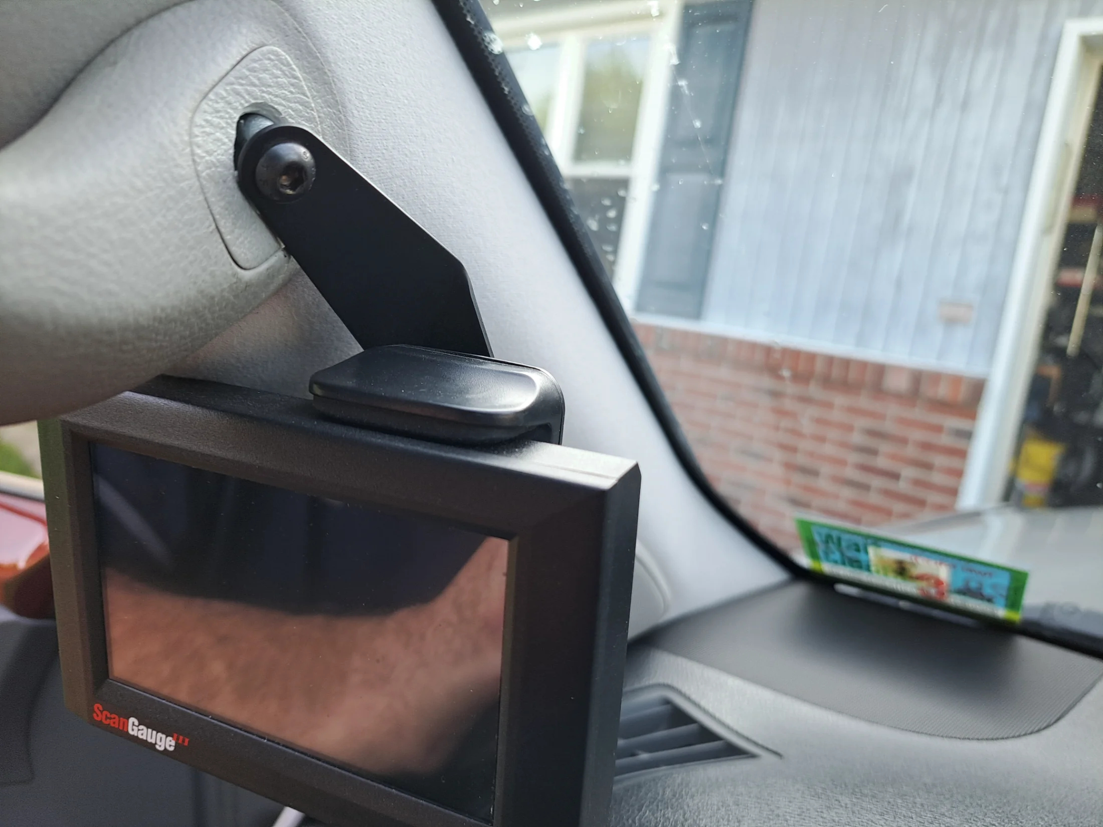

Looking for some feedback. I got tired of the wobbly windshield suction mount that came with my scangauge 3 so I designed up a new case that has an integrated ram mount and cuts .6" off the overall width. This is a direct swap for the sg3 housing, it takes 4 screws on the back to separate and swap the screen over. Same 4 screws are used to secure the new mount. Will be sold by itself and as a complete kit with a modified dual swivel ram extension and the A pillar ram mount.
This setup doesn't block any personal or defroster vents and puts the scangauge further into the corner than any other hard mount option. Technically I've found a dual swivel ram mount thats 6" long (compared to this 4") to tuck it even closer to the windshield if needed.

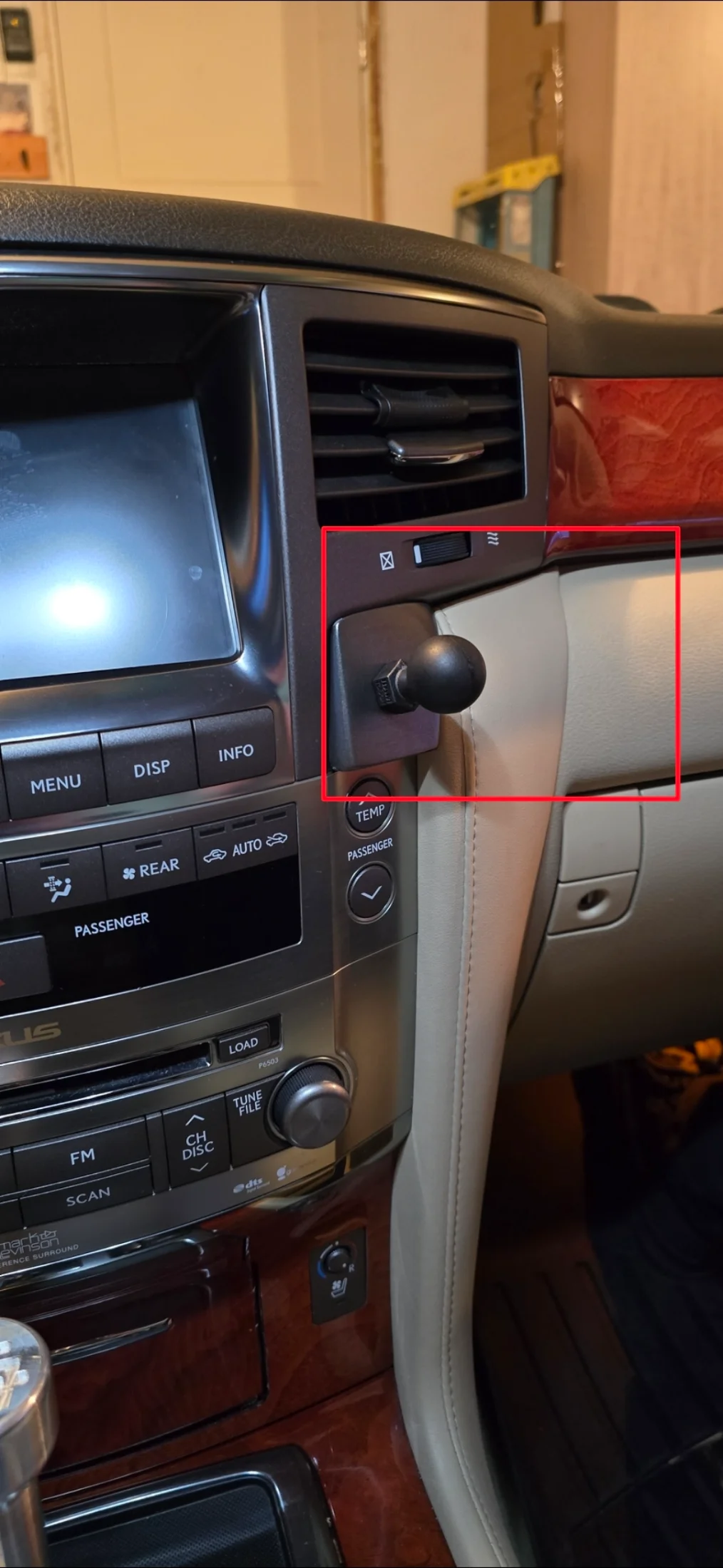

I could modify the design to be mounted on passenger side of LX dash where my phone charger option currently sits. Is there anywhere else people would want a mount designed?

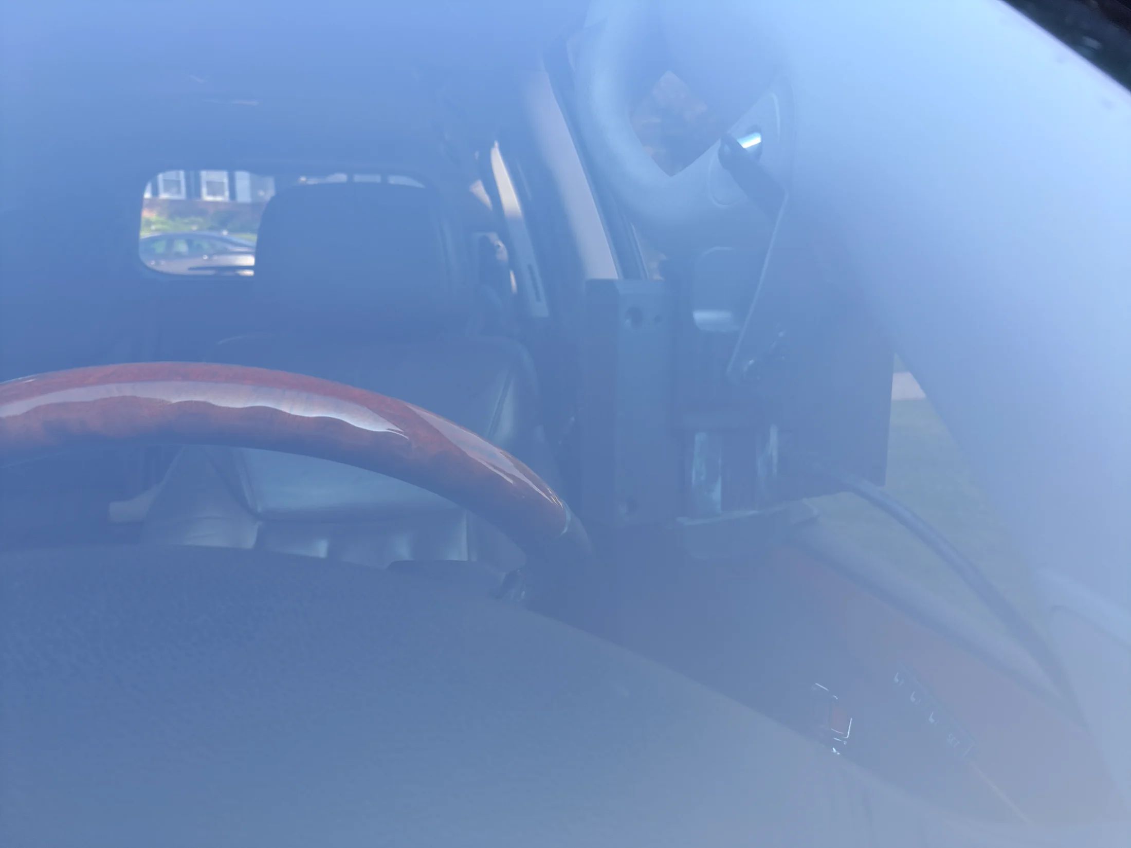

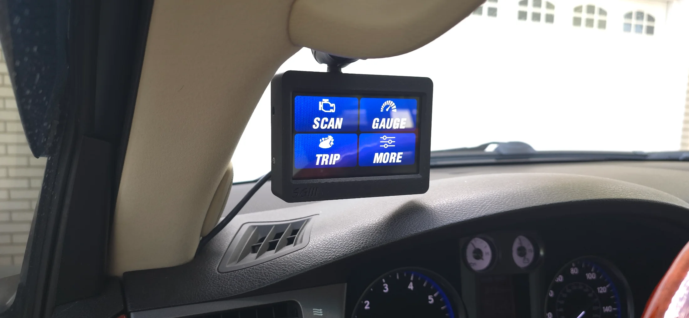

Will I be able to touch the scanguage with the 6 inch? Here's what I cobbled together for the past year which isn't bad but I like your option better. Can you update me with Pictures so I can see the difference between the 4 and 6 inch. Either way ill be buying one or the other. Thanks

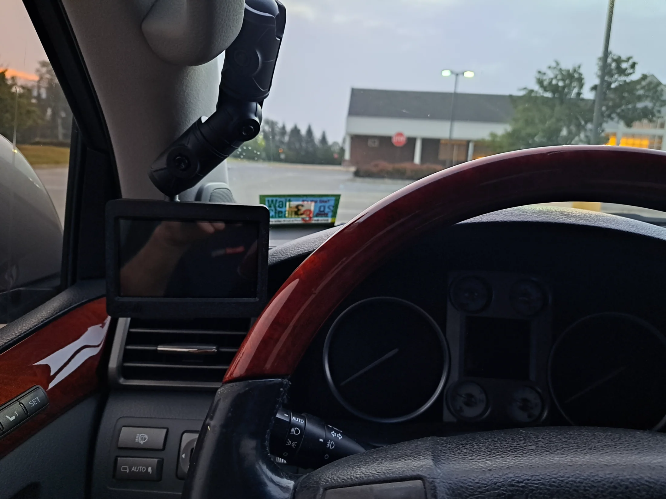

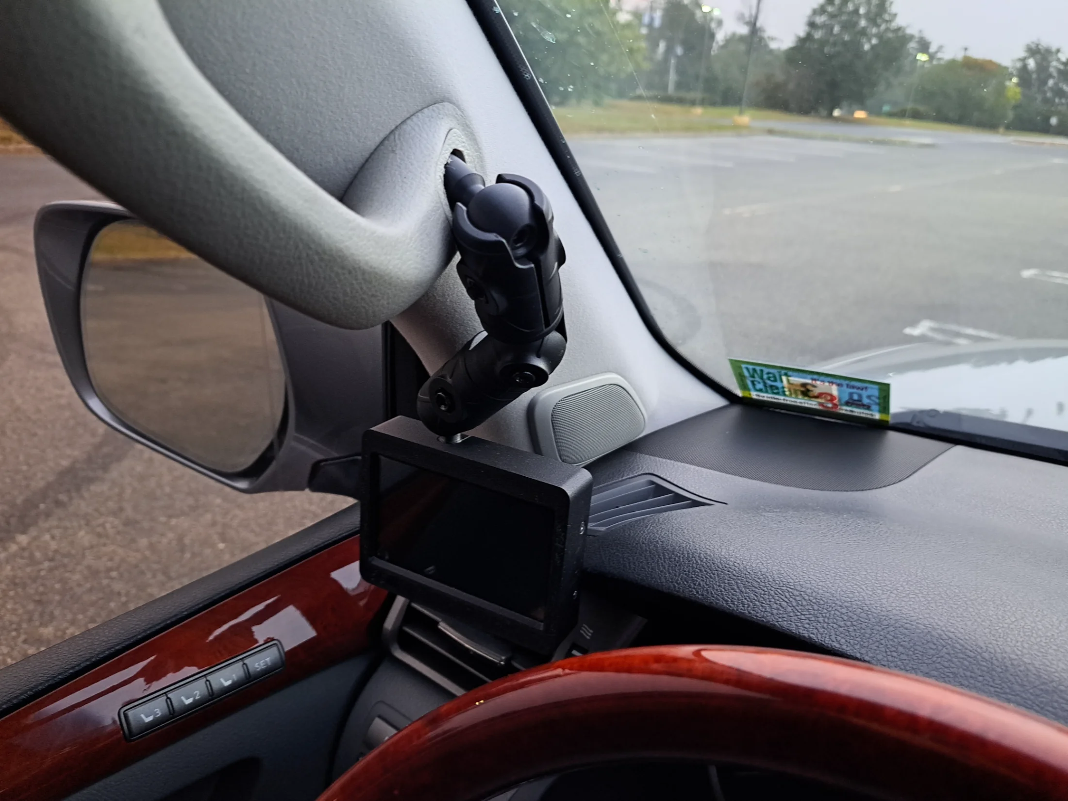

Just wanted to say how impressed I am with my new scanguage case and ram mount. Uto8lx570 puts out a nice product. I decided to adjust mine so it's lower on the dash and not sticking up over it like it was as seen in my earlier pictures above.
