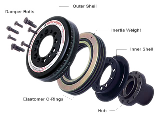

not surprising at all, and it's not the part that atttaches to the snout with the key in it, it's the ring that's on the outside that is attached to a rubber band that is attached to the hub - that rubber breaks down and allows the outer ring to spin on the hub.
Here is an SFI approved balancer, outside of the cover and bolts it's the same as your balaner
it's the inertia weight that is spinning. You see the rubber on the inside? they build them like this because that ring has a nasty tendency to come off. Worse is it's not neutral balance, so it beats the snot out of your main bearings when it's off.
With all that said, take a paint marking pen and draw a line across the inertia ring and the hub - if it moves again, you'll be able to see it.
