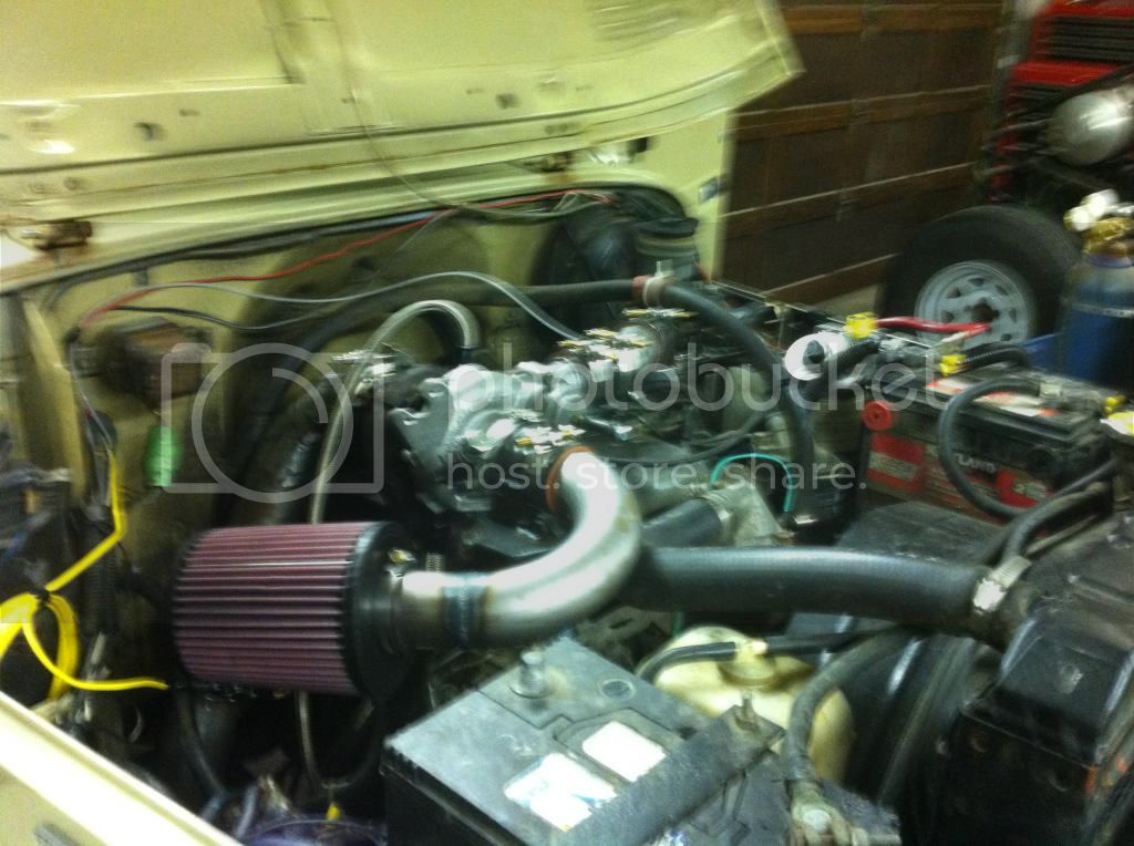

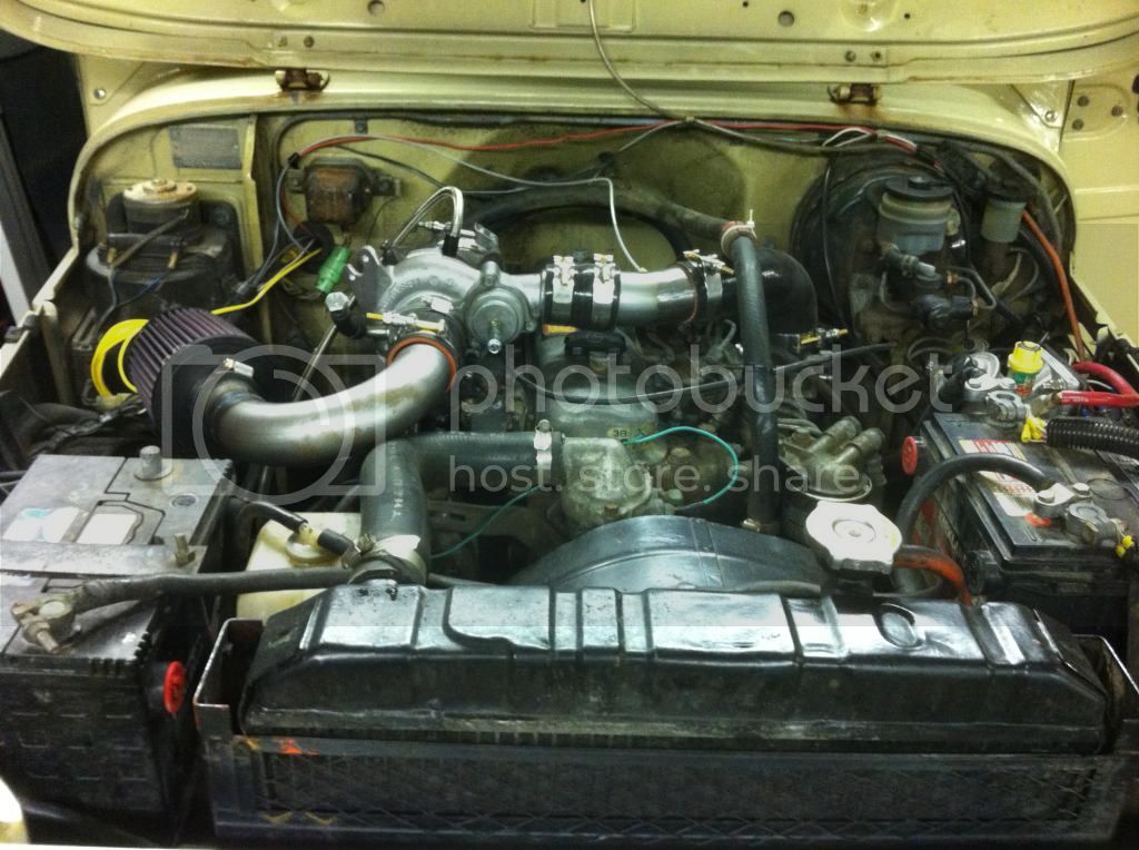

A front-on shot.
From the side.

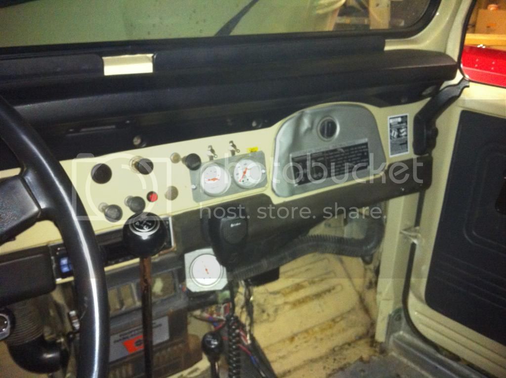

My gauge locations. The boost gauge is below on a simple sheet metal bracket, and pyro/oil pressure fit nicely where the ash tray was.

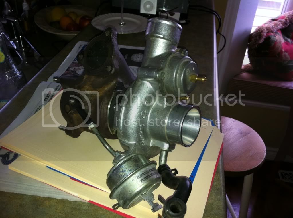

Here's where it all started, a Garrett GT2052S
t
This is a turbo that I think came off a 2004 SAAB 9-3, which I purchased on eBay for $130. It was nice and clean, imperceptible play in the shaft. Now looks great under the hood!
At First I was very worried about it being too small, but at this point it seems like the right choice.
The wastegate is currently wired shut, and the bypass built onto the turbo (compressor side) is also sealed. It makes between 12-13 lbs max, and cruises at my normal speed of 90/95km/h at about 8 lbs boost and 800*F on the pre-turbo pyrometer. I haven't noticed any bad compressor surge so far, with the lack of BOV or bypass, but I imagine I ought to do something about it in the future. Didn't get over 1100*F on a long hills. (99 Hwy from King George up to 24th Ave overpass, and Gaglardi way up to SFU)

Glad to hear of your install. Looks like it fit nice and tight. You might want to header wrap the down pipe as I think that relay will get cooked in the summer on a long pull. Turbos shed enormous amounts of heat into your engine bay. You can get some wrap most anywhere, and you wouldn't need that much. Enjoy the hills!
