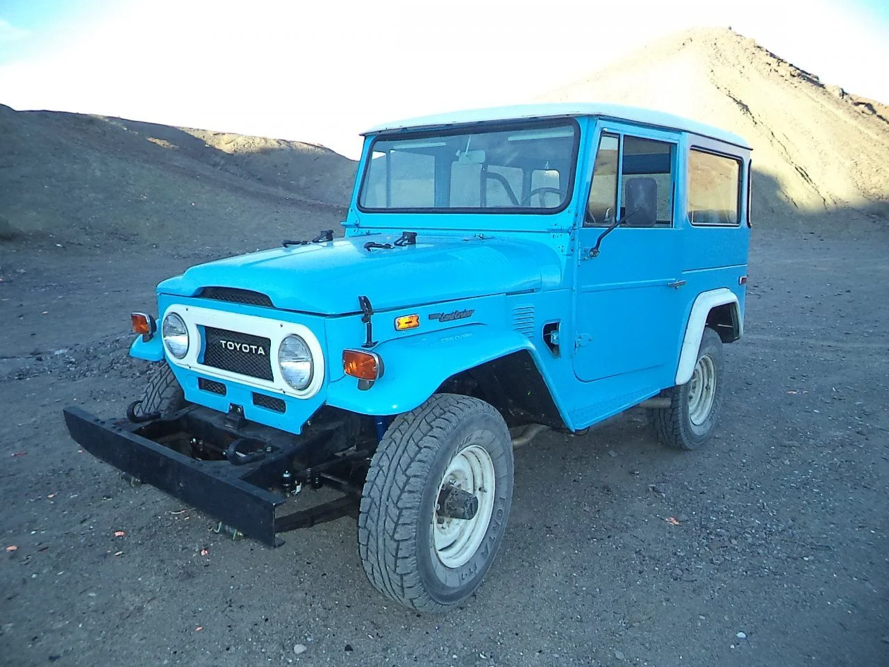

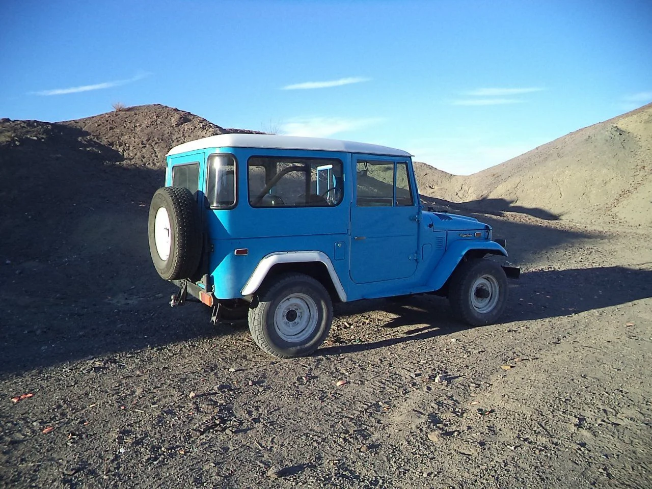

Anyway I'm in Santee and would like to see some other rigs eventually-photos of mine below.

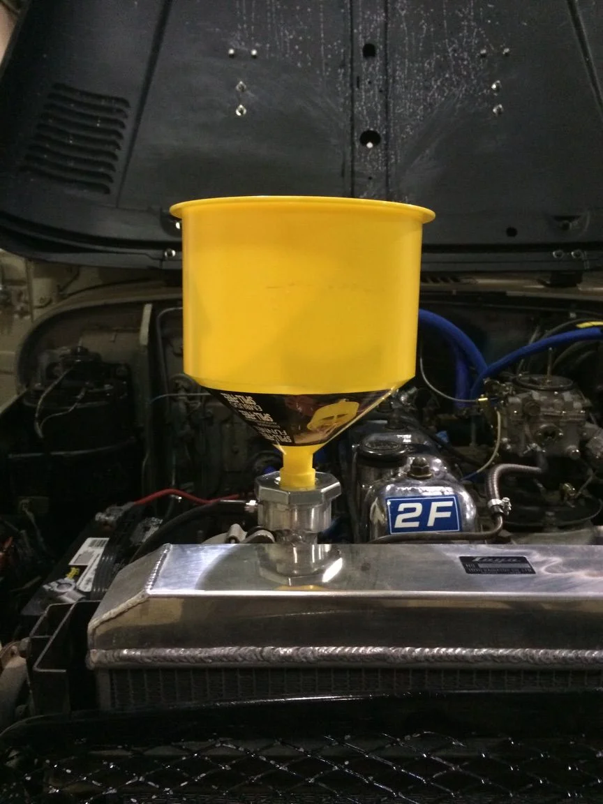

Just went through this issue after a drain and long dormant period. My T-Stat was good. Bought a burp kit for about $25.
Install kit as per direction. There are pics so it's pretty straight forward. I disconnected the upper hose at the radiator. Added fluid until I had a small dribble coming out of the radiator. Reconnected hose, continued to fill. Added fluid to over-flow tank (1/2). Start your TLC and add fluid until you have a few ounces in the yellow hopper. Let the kit do its job. You will see air bubbles percolate out of your system as it heats up to op temp.. Plenty of You-tube vids to assist.
