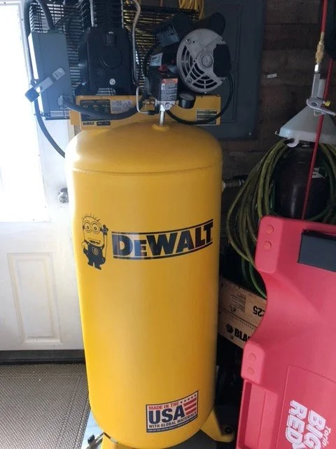

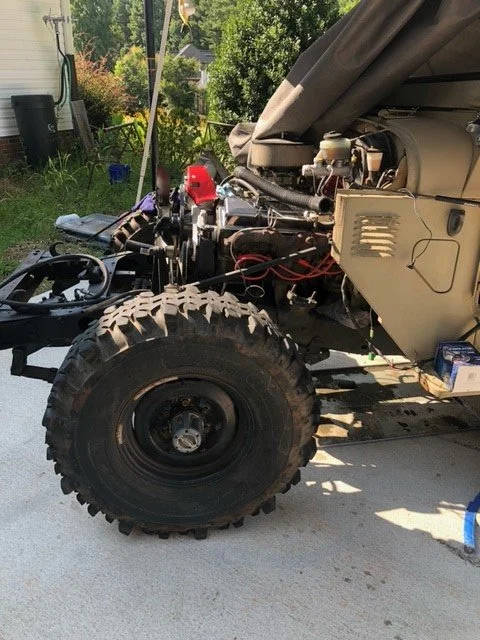

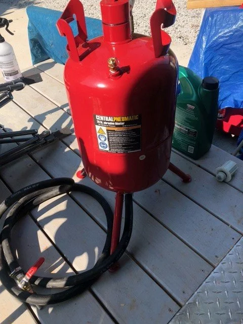

I am restomoding a 75 FJ40. I just bought a Harbor Freight 20 gallon media blaster for 74.00 ( coupon would make it cheaper). I run a 60 gallon vertical Dewalt compressor that is used for plasma cutting and welding. For 75 bucks, it has already saved me that much in labor ( I figure my off time at 10/hr) I shot aluminum oxide through it yesterday and it took 40 years of crap off my tie rods, radiator bracket and other pieces. It's messy, had a lot of sweeping to do to clean up and it gets EVERYWHERE, so wear long pants, long sleeves, facemask, hat and goggles.
I will eventually make a home made booth for small parts and to save the media. There are several designs out there, just look for home made blasting cabinet I found a bunch on Pinterest and Esty. I bought a bunch of walnut shells media from Tractor Supply, fine medium and course. I feel better about doing that in the driveway because it really wont mess up the environment, its will decompose. Just my 2 cents, but I think it is definitely worth 75.00.

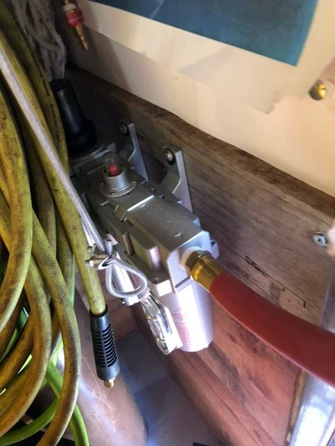

Oh yeah, just to add, you need DRY air through these things or it will cake up and clog. I have a three stage air drying rig (got it from Amazon, wasn't expensive) between the compressor and the blaster ( and really any other air tool) It really is essential and worth it to avoid the aggravation of clogs, rust, general mayhem and prolong the life of your air tools. So if it were me, I would invest in a nice high capacity high CFM air compressor (I got mine a few months ago from Tractor Supply on clearance, $600, but it really kicks a$$ and can run anything I throw at it) and a decent air drying system. Some plasma cutting folks go way down the rabbit hole on this as plasma doesn't like ANY condensation, but for all around stuff a 60.00 desiccant dryer would be fine. Then on the tools themselves, you can get by with Harbor Freight stuff, check out garage sales, FB Market
place and all that. Keep them oiled and they should be fine.
