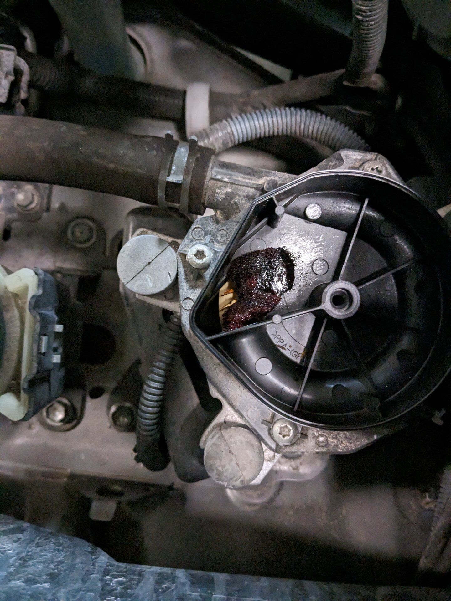

Here is the filter residue I removed
That filter somehow melted and became a somewhat hard chunk which seized the fan below and also restricted the air passage, I was able to pop it free in one piece and remove it. What caused the filter to melt ? This is on a 2012 460 with only 67,000 miles. I'll run it a lot and see if it goes into limp mode or not. Somehow I'll get it to the dealer later next week.
Have you had your 460 in any water? It is usually caused by that foam getting wet and then it gets pulled down into the fan impeller.
No water except the car wash ! We did have a couple of really hard horizontal wind driven snows this winter.
