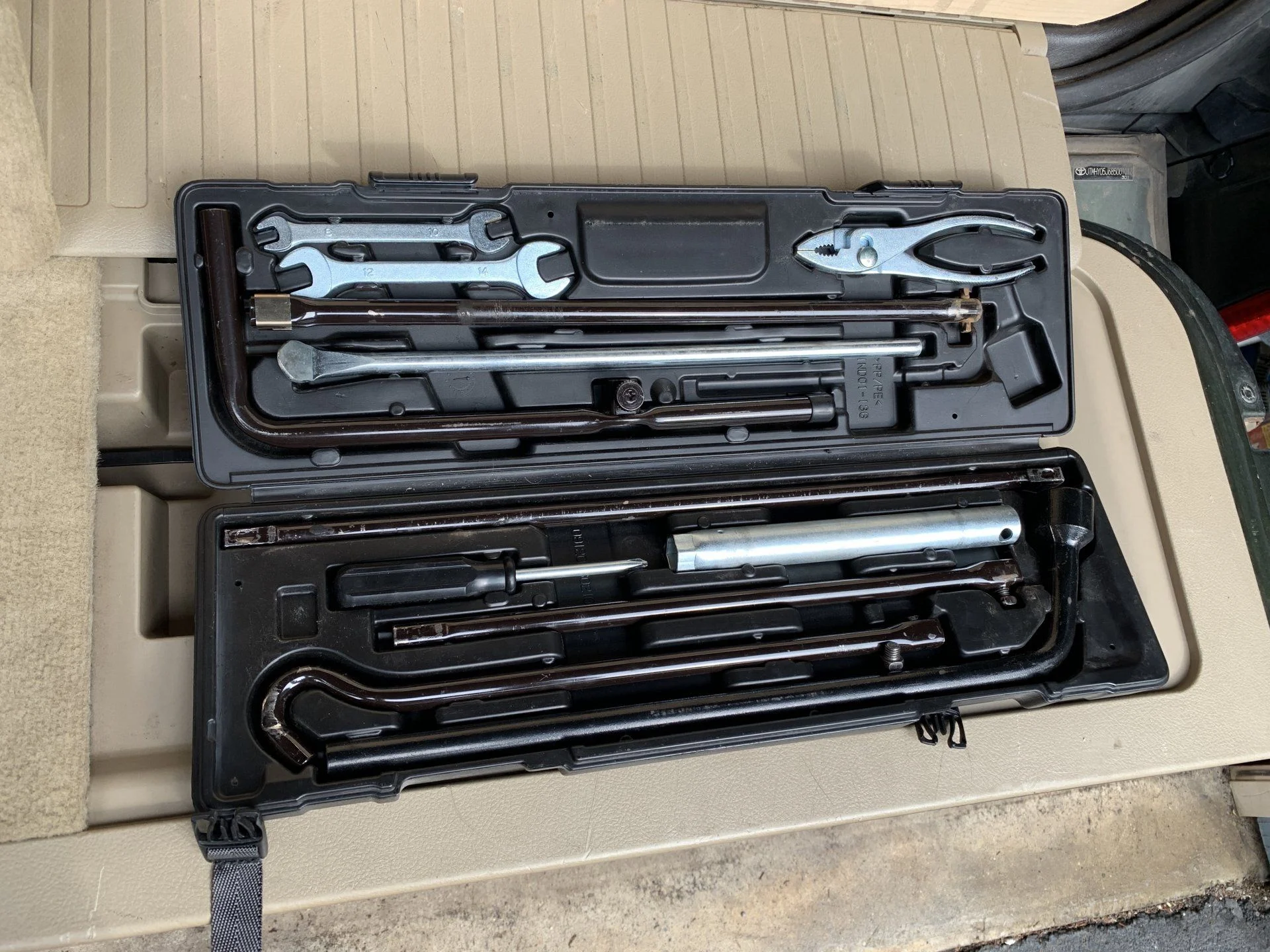

I don’t mean to offend, just covering all the bases. Is the handle not with the tool kit in the tailgate?
No it wasnt. I took a trip today to the junk yard and put A nice one together with some extensions from a bunch of other ones lol. They didn’t have a 200 series in my small town go figure.
is it supposed to have a toolkit too? What else is in that?
Yep, there should be a tool kit in one of the compartments in the lower tailgate. Aside from the tools for a tire change, just a few basic tools. Slip joint pliers, two wrenches, and a phillips head screwdriver.

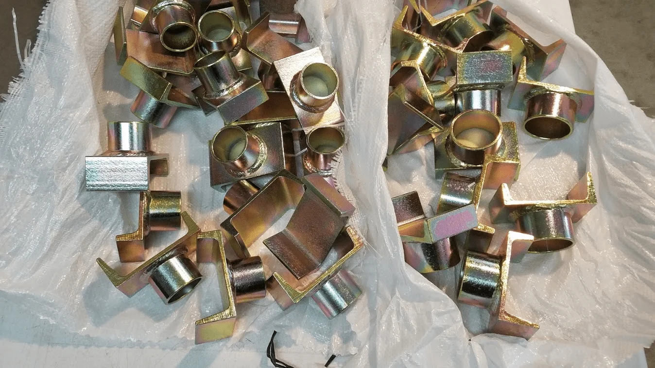

We now offer 4 sizes of Jack Adapter to fit 99% of post and hydraulic. If you dont see what works for you on our site contact me because a couple of sizes are on the secret menu.
