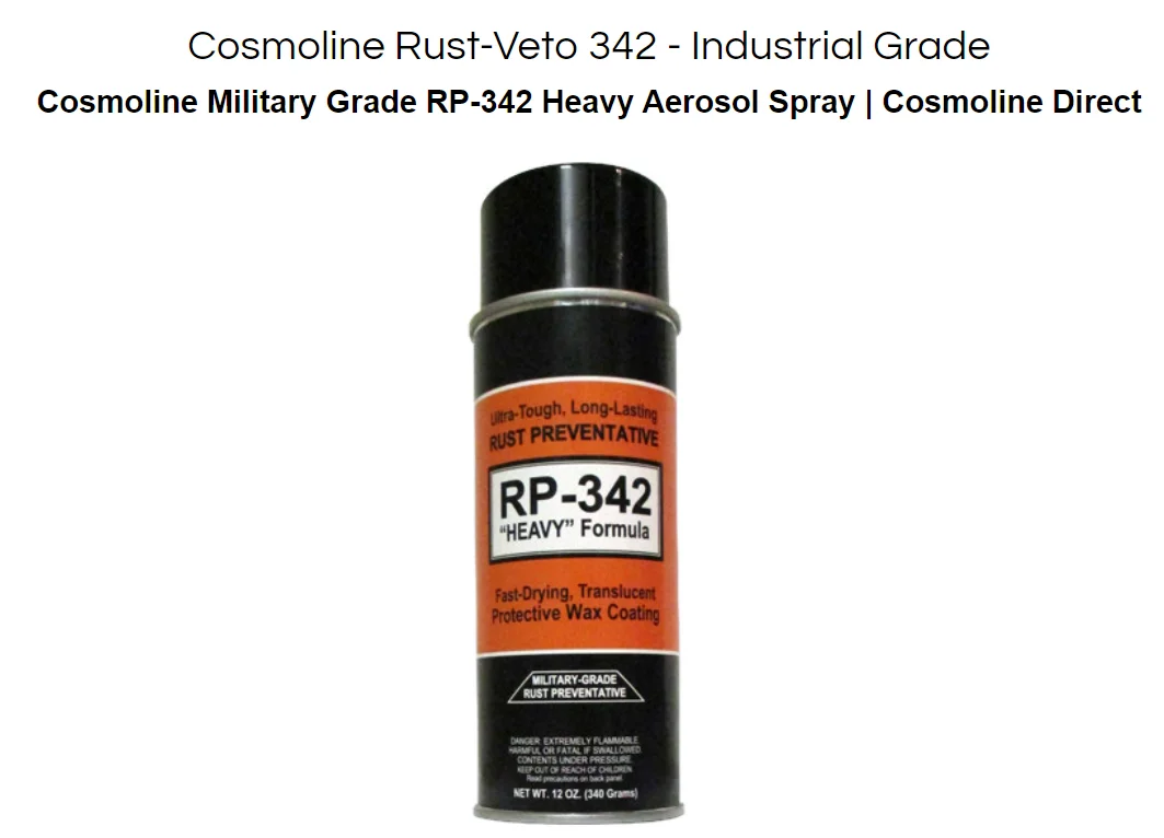

I use RP-342 Cosmoline. It smells for a few weeks, but it lasts a couple years.
