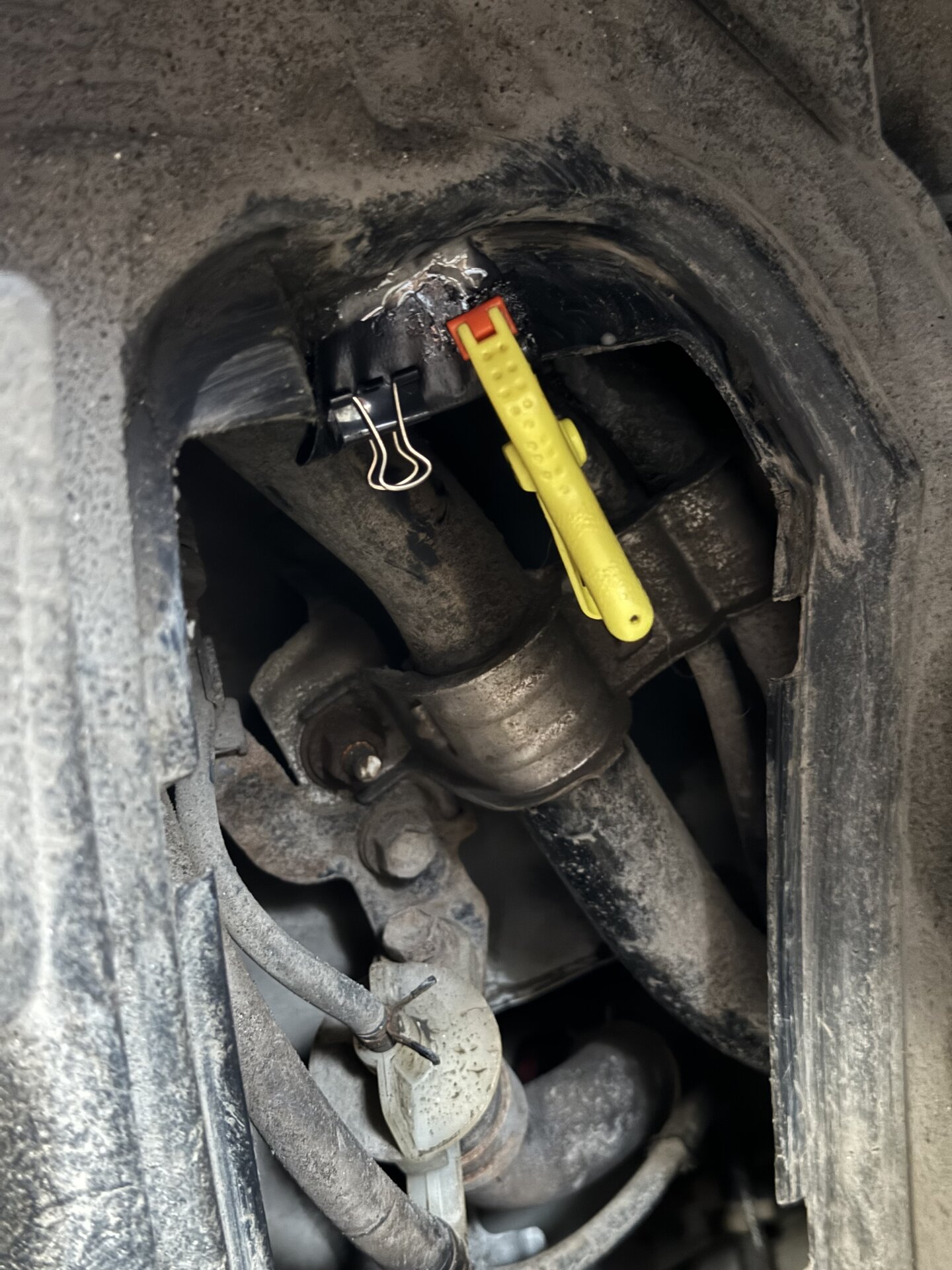

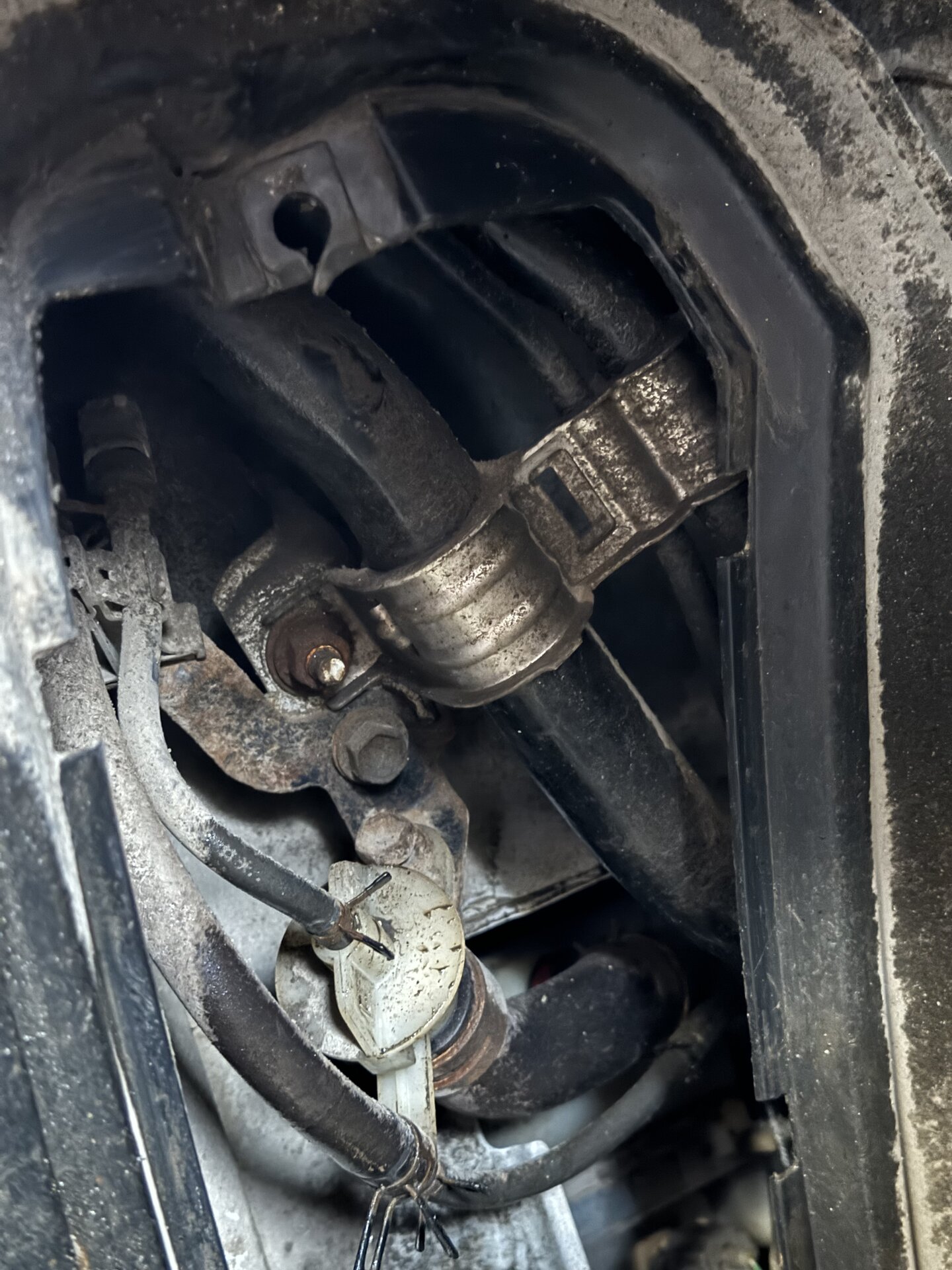

I did have an issue, the bolt that holds the access door was rusted to the nut that was inside the compartment. To get the door off I broke the plastic frame that held the nut. I went to Lexus and they said the wheel well
Liner can’t be ordered? Which seemed odd. But looking at it the entire liner would need to be swapped out. So I made a new reinforced spot with JBweld and duct tape. My plan is to use one of the push retainers that came in the engine covers.

Try 77277-60140
