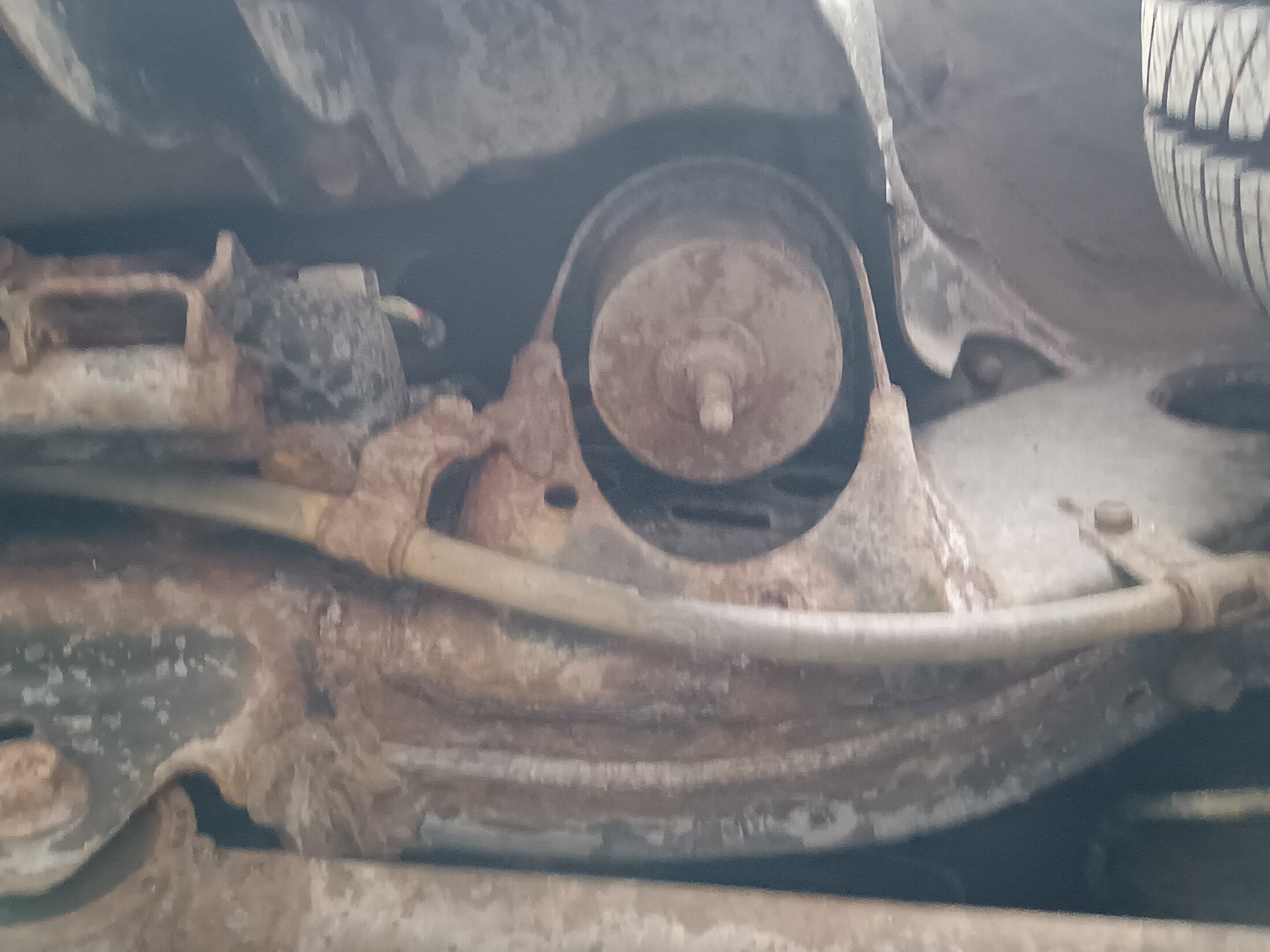

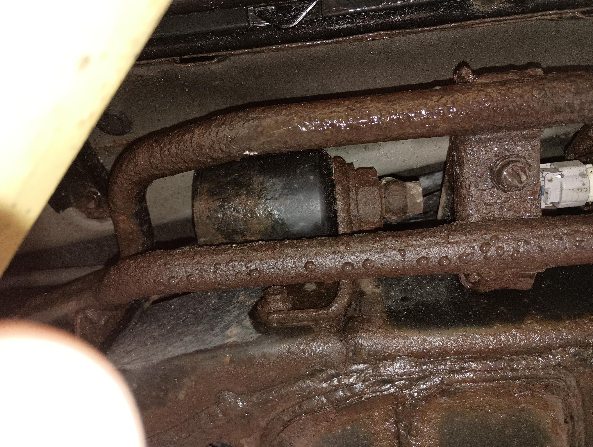

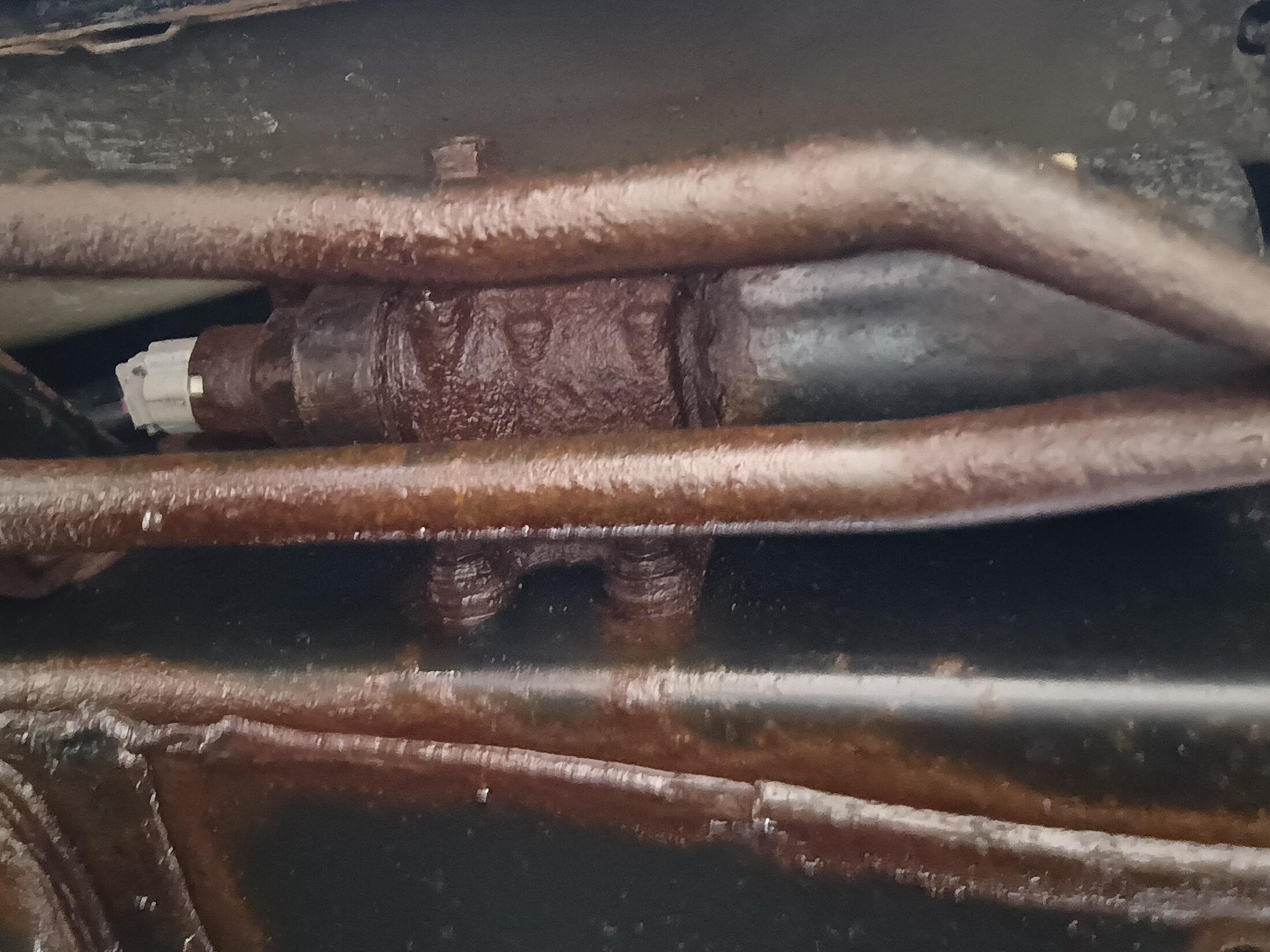

Would you mind showing us some photos of your undercarriage?
I can't imagine rust being so bad that it would take $20,000 to fix the AHC!!
