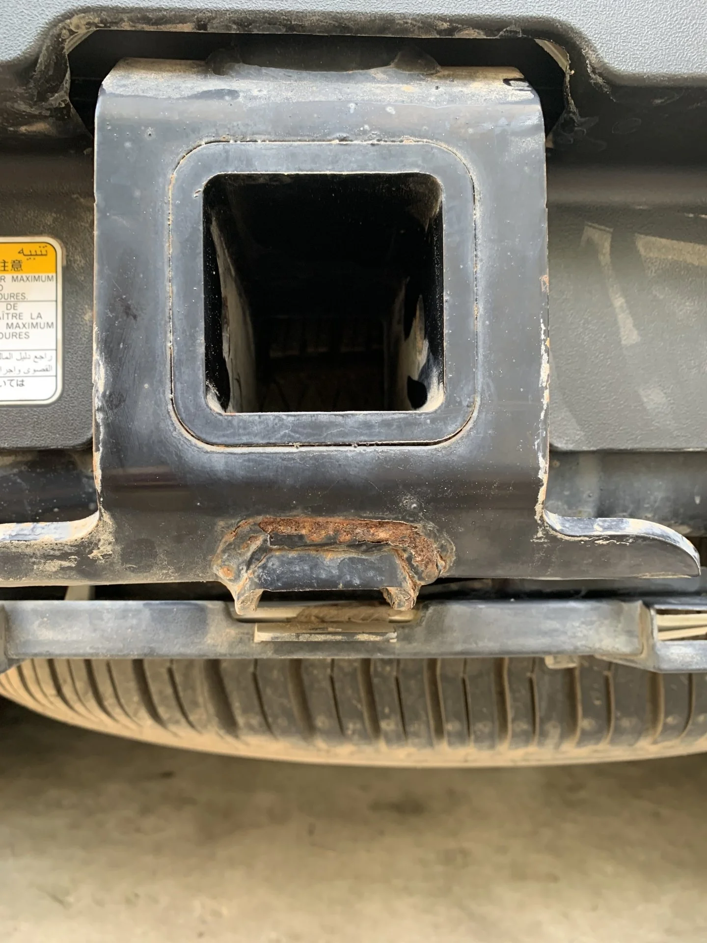

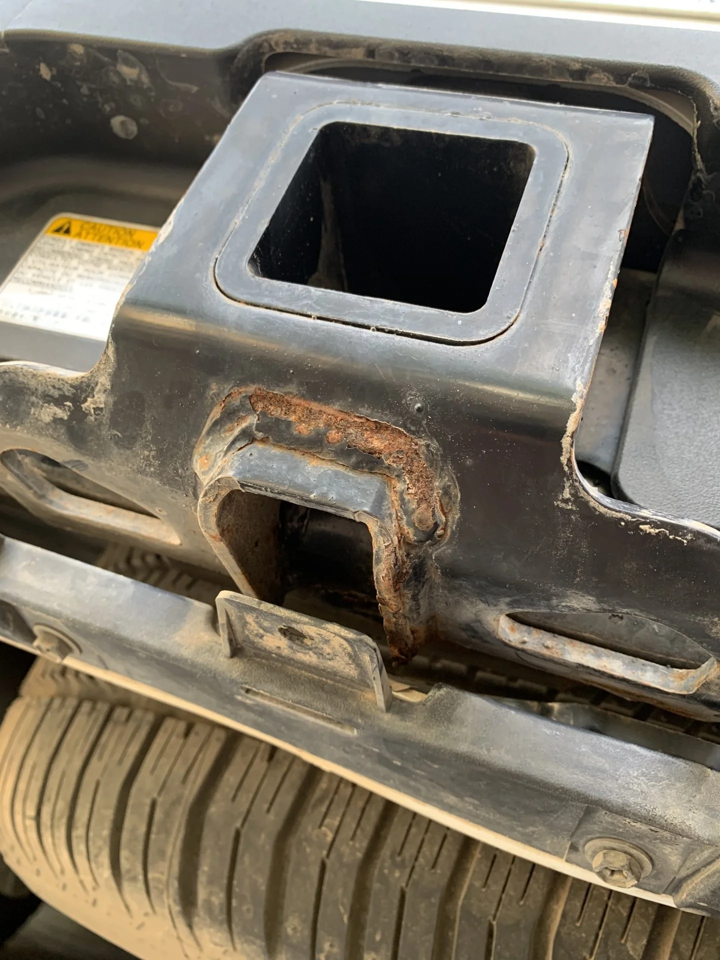

I searched for a general/running rust advice thread, but didn’t find one…sorry for posting another one…
Is this rust on the hitch anything to be concerned about? Or just treat/convert it and move on?
Thanks in advance!
If that’s the worst rust on the vehicle, you’ve found one pristine enough for the showroom floor.
Flip through my build thread for some rust remediation work.
Yup. That is one of the most common places to see flaking rust on a LC. I am surprised the inside is so clean. The tow hitch area will rust in the desert. But as said above that is nothing to be concerned about except for being an eye sore.
Although my LC200 was build Oct 2020, I have initial signs of rust on welds. I opted to spend some time underneath the vehicle following all frame welds and items welded to the frame using Rustoleum Rust Reformer. I think I have been able to cover at least 80%.
I did not apply any additional paint over the rust reformer. It does seem to hold up well, however time will tell.
In your case I would get a dremel and remove some of the rust, then apply something like Rust Reformer.
So beside rust reformer or similar, you may want to get under the car and look at the rest as well.
Thanks in advance!

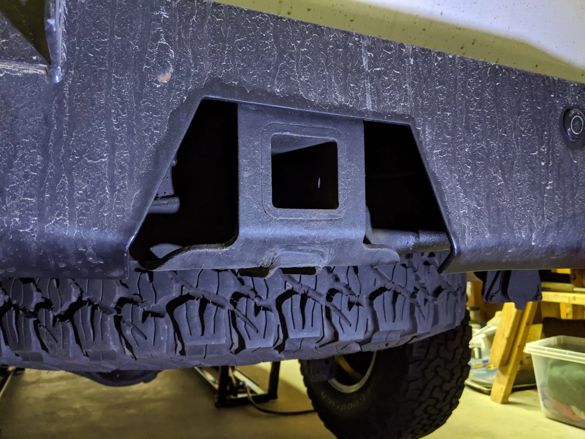

This is what my trailer receiver looks like now, after 6 years in salty New England. Many coats of Amsoil HD Metal Protector, and I recoat every time I swap or rotate the tires. No rust... none.
That looks great! I remember seeing pics of the underbelly of your FJ62. They are scarred into my memory. You used old gear oil to spray it but this Amsoil product looks much better. I'm a dealer so will get some of this to apply before going up North for Christmas this year. Do you use a pump sprayer? What all get treated? Is it harmful for the paint?
