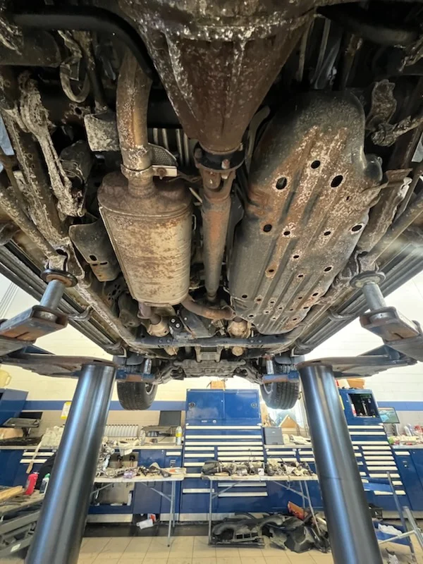

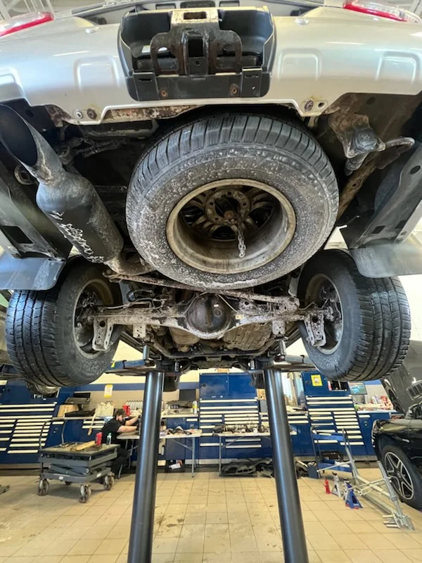

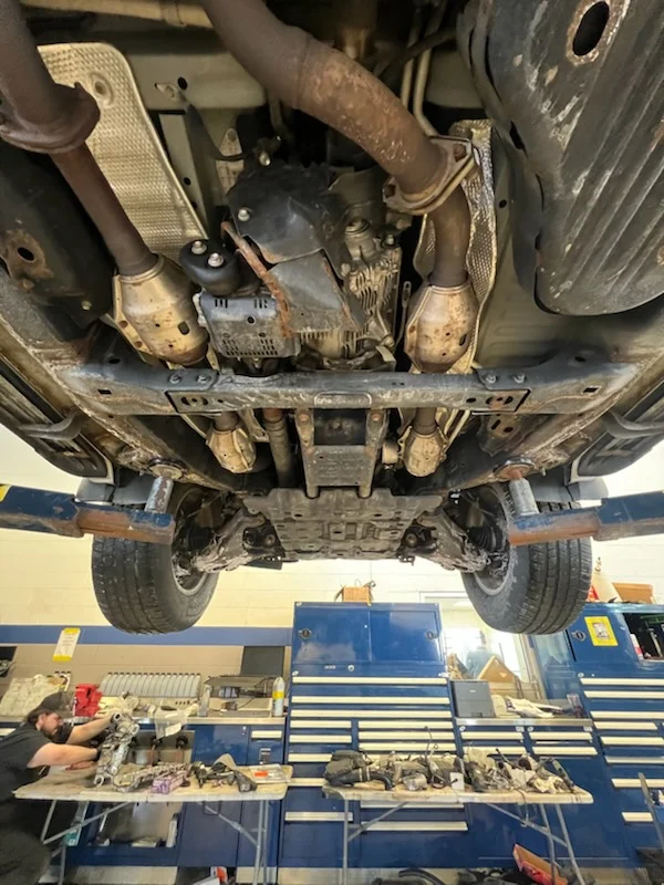

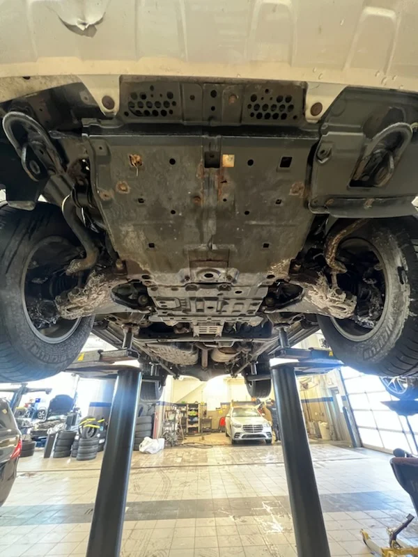

Hi Gang -- Looking at this 2011 200 up in Minnesota; I'm in NC. It's got a 152k miles on it. Got the dealer to send over a few of the underside, attached. I can make out some surface rust and superficial scratches, but wanted to get the opinion of the group. I've inquired on the service records as well and specifically asked about the valley plate - waiting to hear on that.

Not at all bad for a Minnesota truck. If I bought it I would wash it with Salt B Gone and then fluid film everything underneath. In its current state the frame only has 20-25 years left in it.
Or I would buy a southern truck.
There’s enough rust that I know everything you need/want to do in the future will be a fight with corroded bolts. I’m sure the KDSS shutter valves will be rust welded closed, making suspension work hard. There are missing bolts on the front engine under covers that I bet have been twisted off due to rust. The transfer case protector plate won’t last too many more years. Your 13 year time frame for ownership suggests maybe finding a less rusty one. If you decide on this, it may be salvageable with lots of work, but it’s hard to tell with all the gunk under there.
That would be a NOPE for me.
