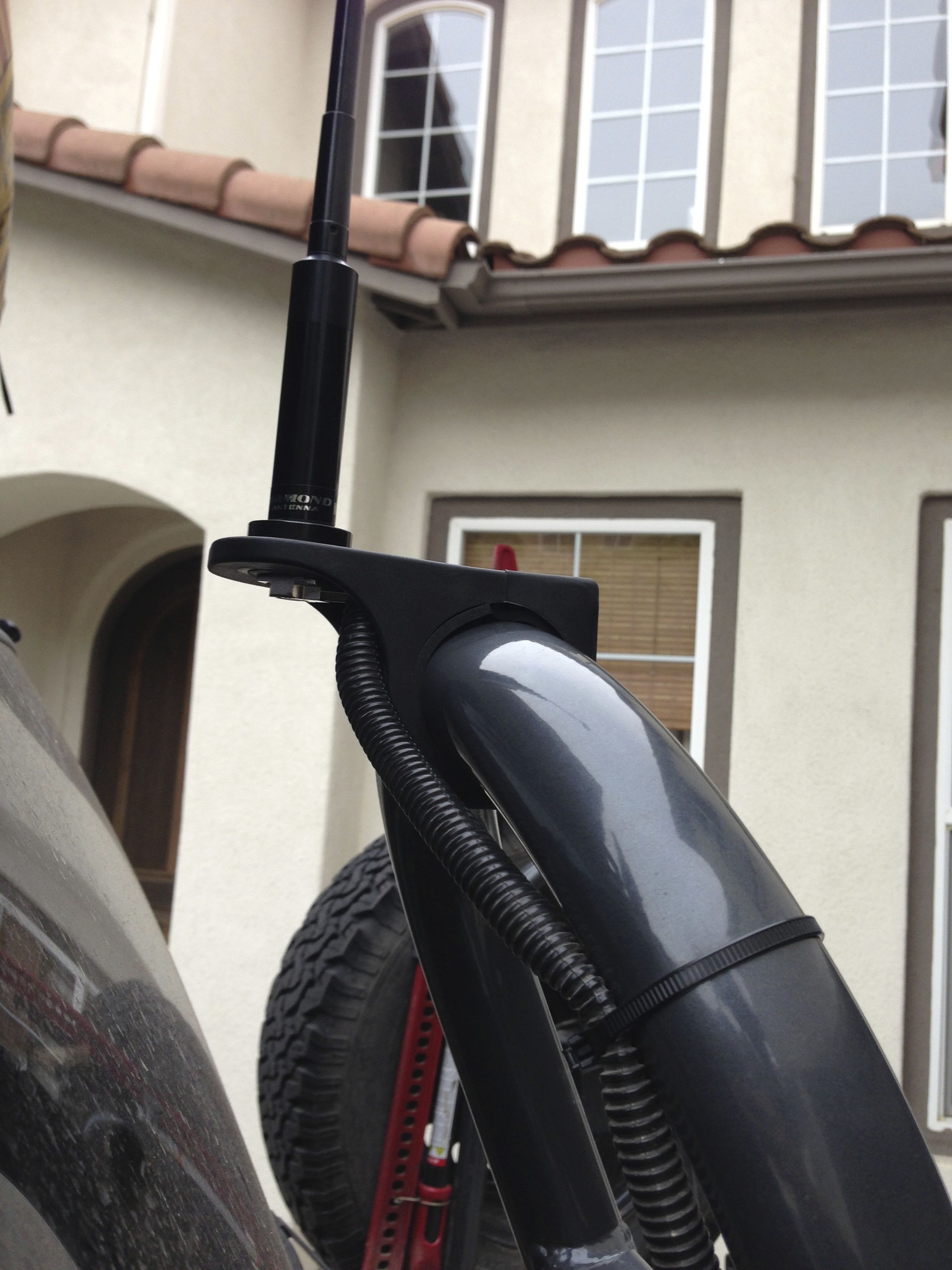

I use one of these...mounted to the swing out on my Slee rear bumper.
