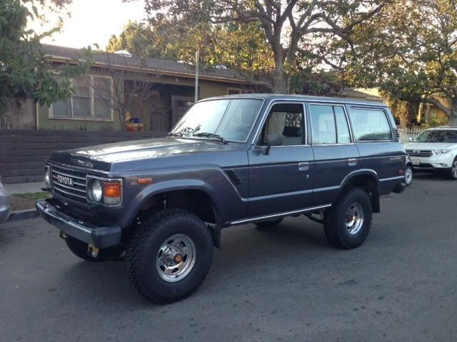

Might as well post a pic
Here she is….!!!
