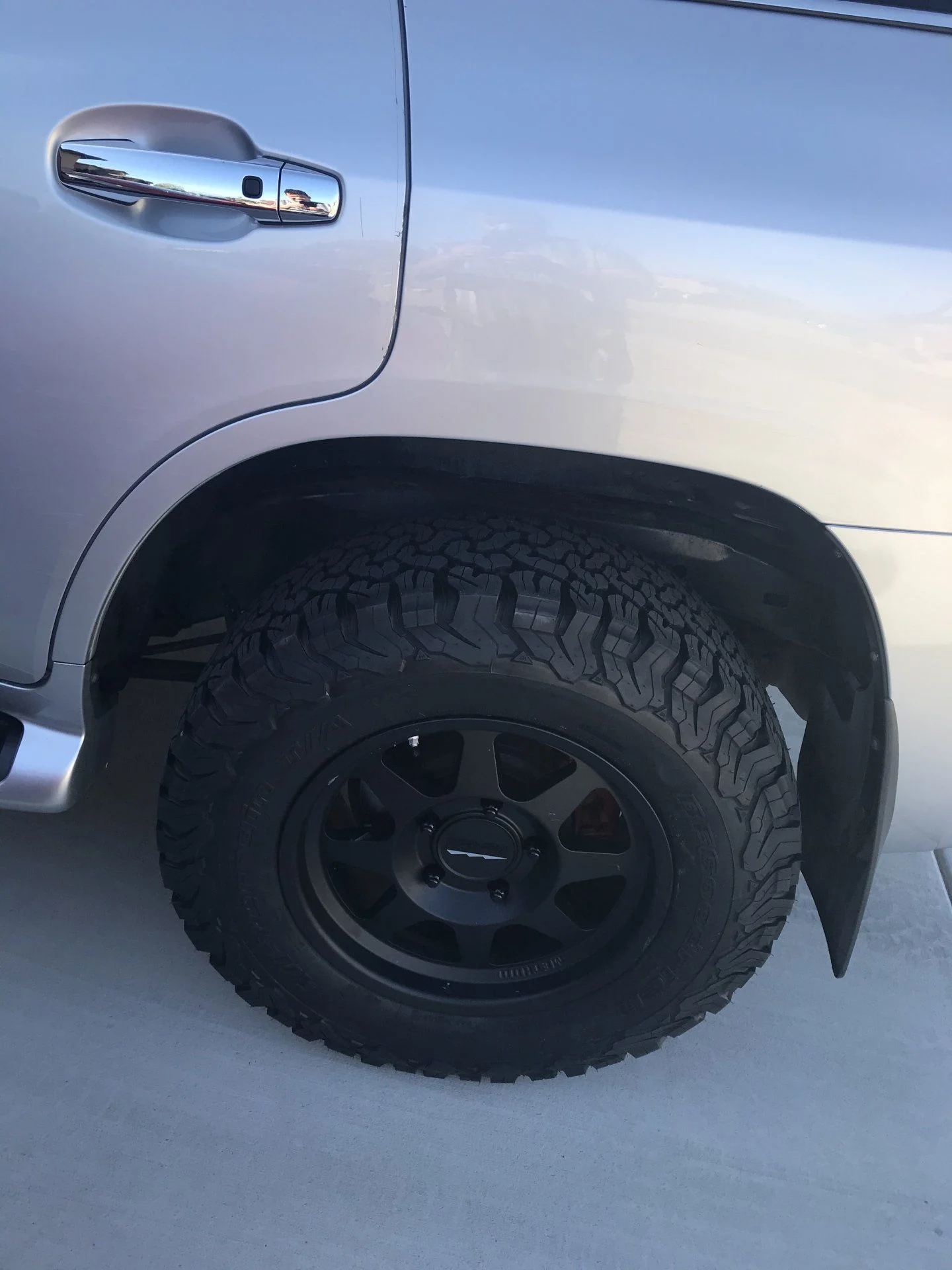

Got new tires and rims. Method MR701 with K02 285/65r18. I love it but got some tire rubbing on front mud splash. Remove mud splash some trimming.

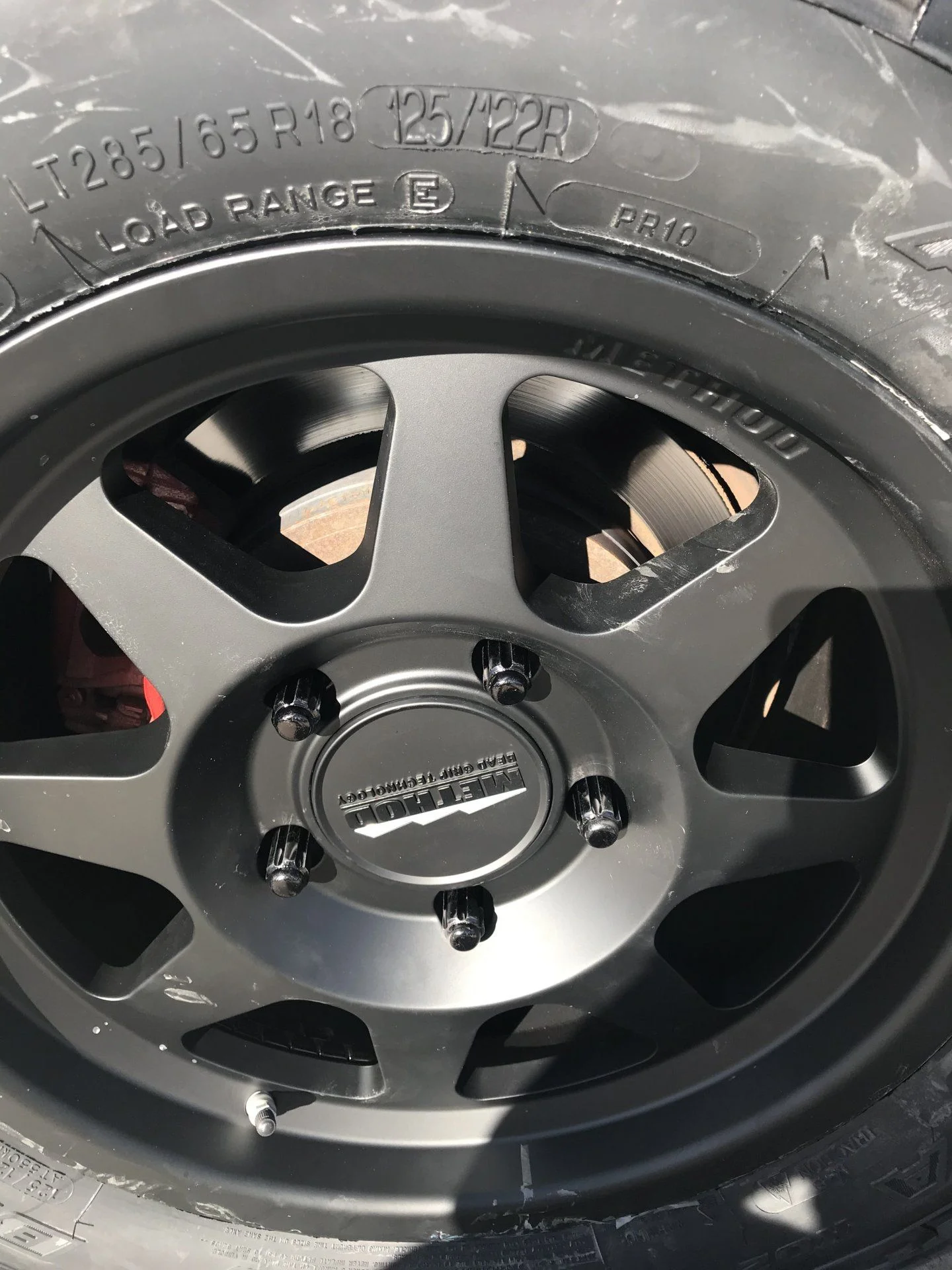

Wheel offset? Looks +25mm ish?
Therein lies the root of your problem. That's a pretty aggressive offset and causes the tire to swing more as it's turned.
No worries though, and the rub is largely on plastic parts. May be able to resolve most of it with some strategies documented here
