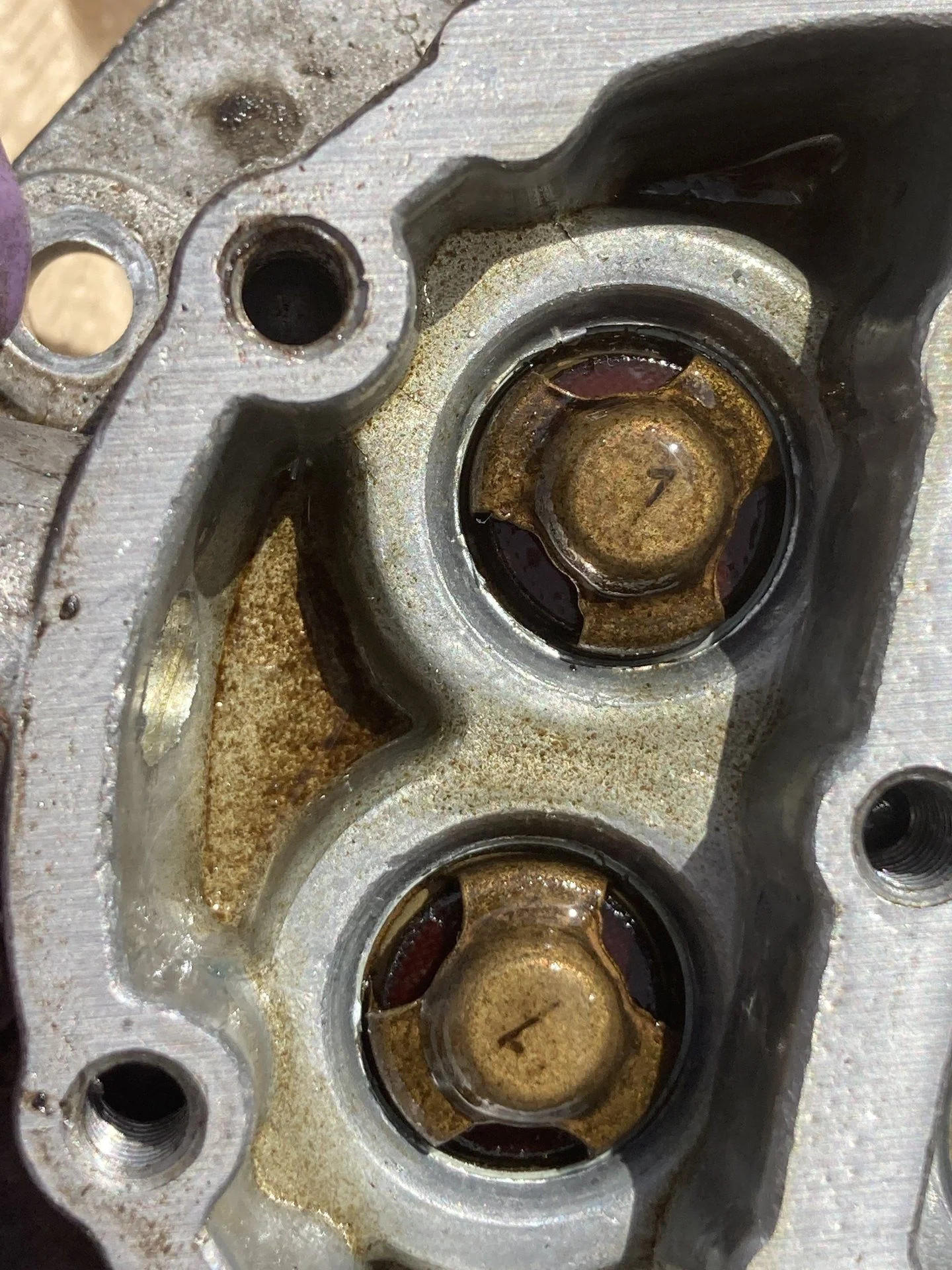

After starting a new thread on this, in which Lionel Ritchie showed up, I decided to open up the fuel pump: Rebuild 2F Fuel Pump? - https://forum.ih8mud.com/threads/rebuild-2f-fuel-pump.1249160/
The verdict was that the pump was functional, so I buttoned it up and plan on running it.
View attachment 2652340View attachment 2652341
I don't think I ever got the pump to seal successfully. I had a chronic fuel smell in the cab when driving, and in the garage when parked.
Time to get a new fuel pump...
Matt hooked me up w/ new pump - so far, so good!
