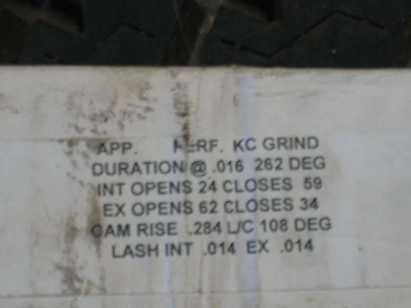

My Cam specs
I am curious what the power band will look like between the stock 3FE cam and this KC859 cam. Are we losing any power or gaining it?
Is that cam for torque or hp?
Had my cam reground by Delta. Specs are below. Great improvement on top and bottom end IF combined with header, shaved head, engine balance etc. By itself I don't think you would gain much.
I agree. I had an old Chevy truck with a straight 6, I put in a hot cam, and had more power at the top end, but the bottom end sucked donkeys with nothing else added to the engine.
