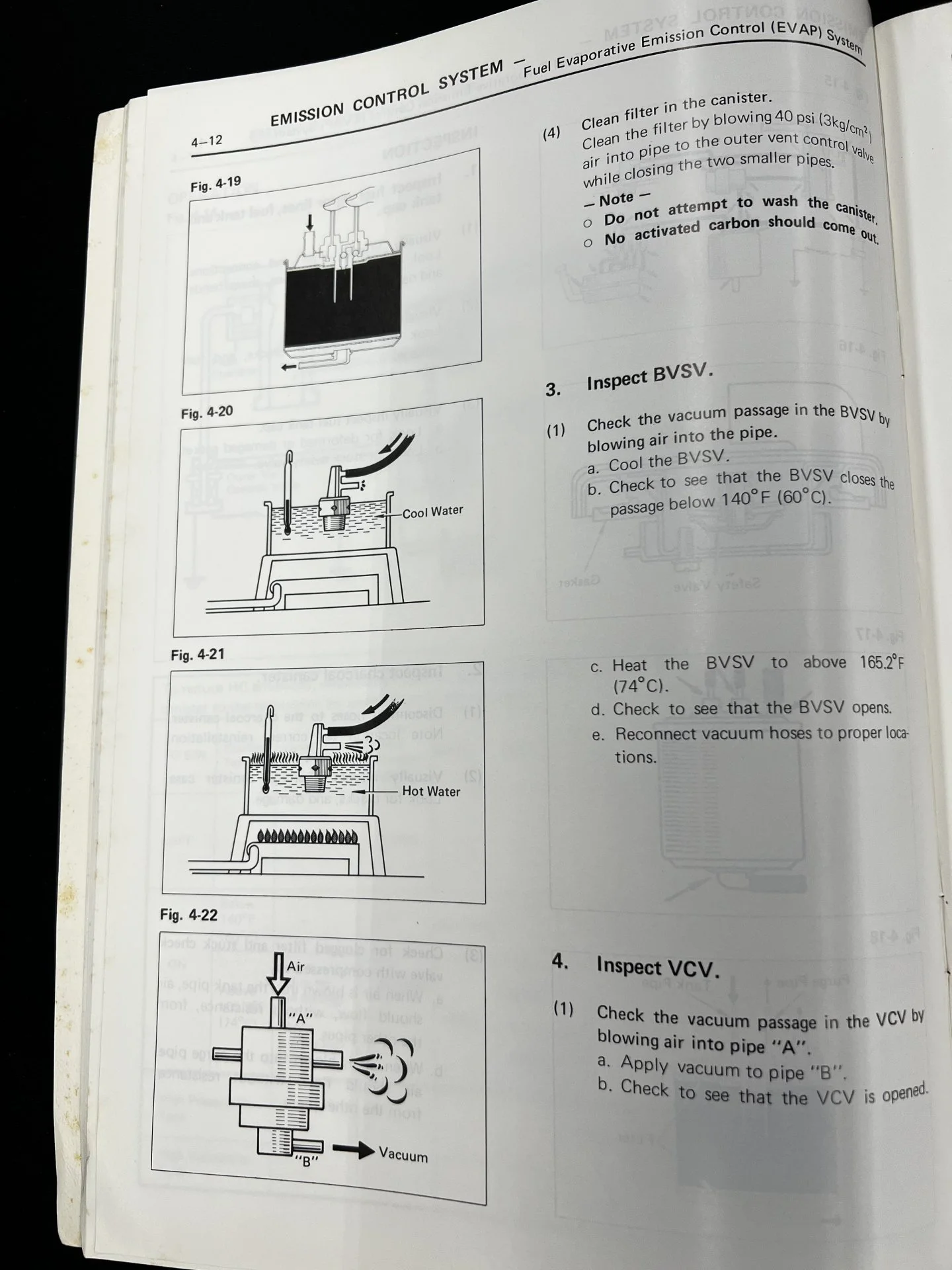

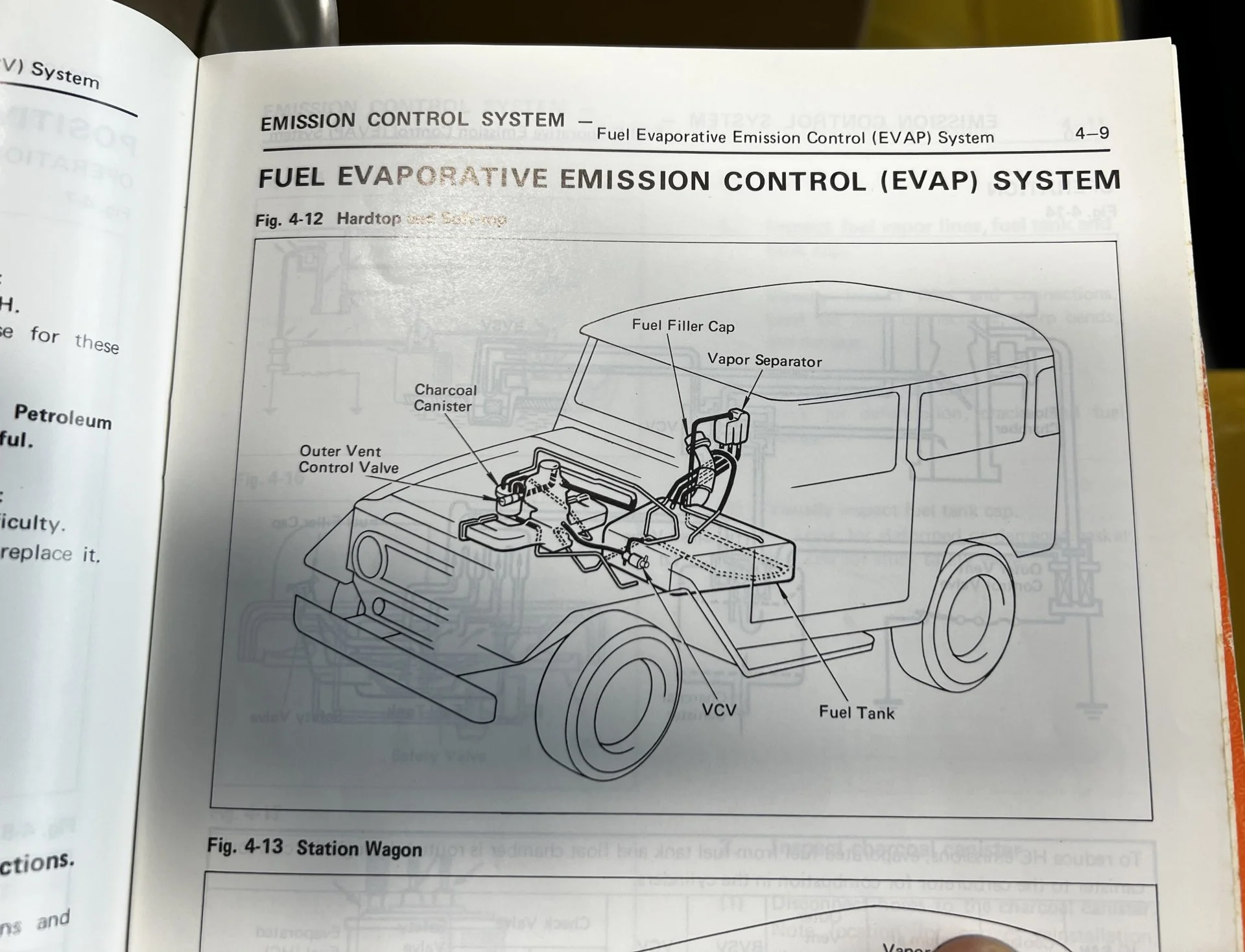

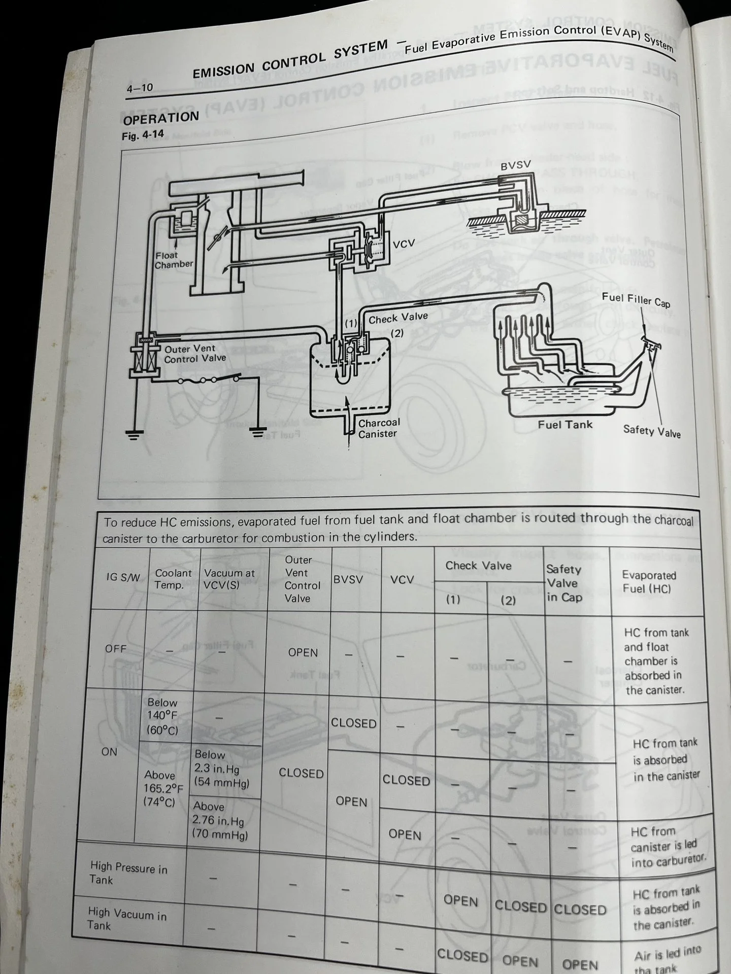

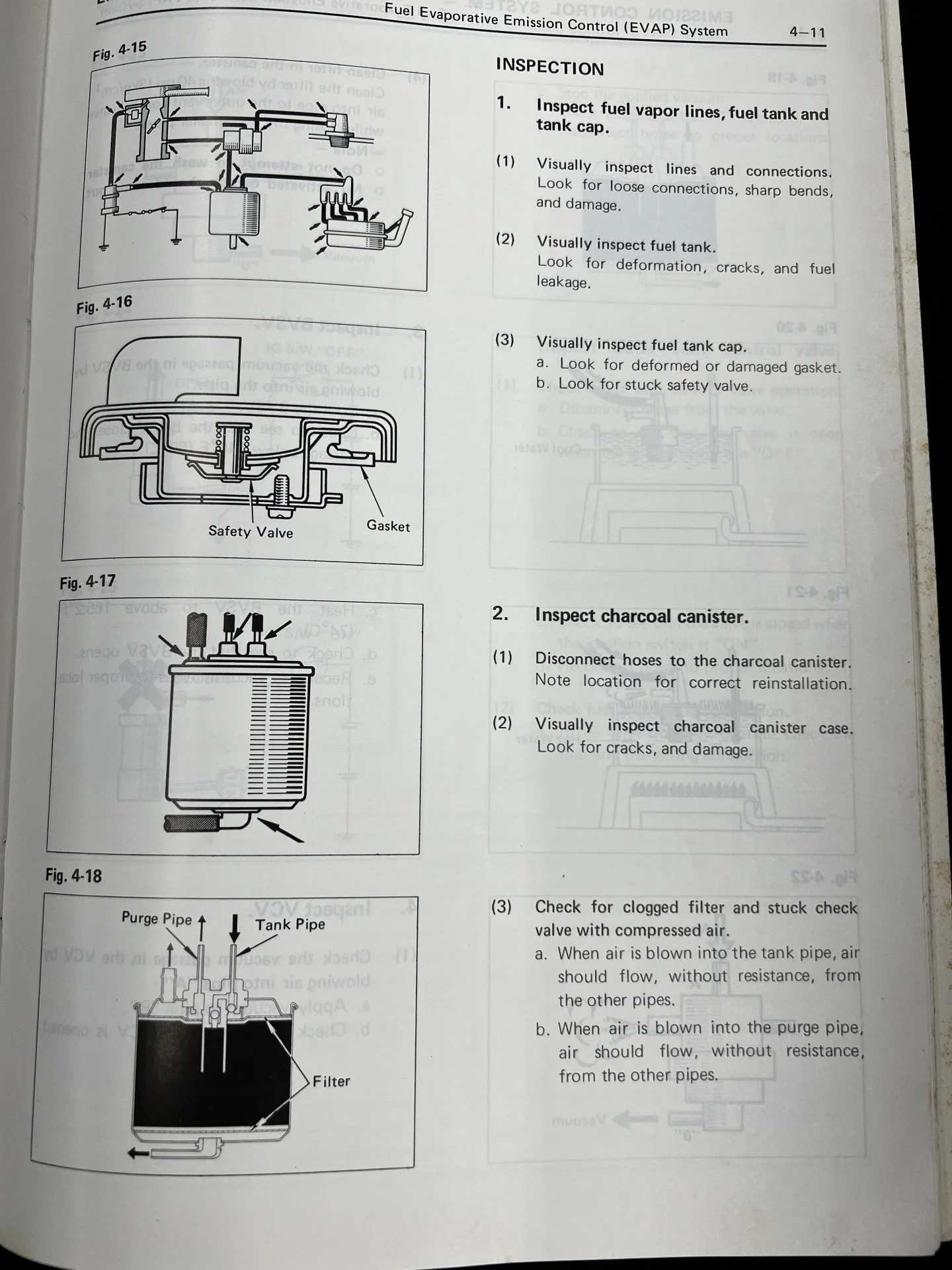

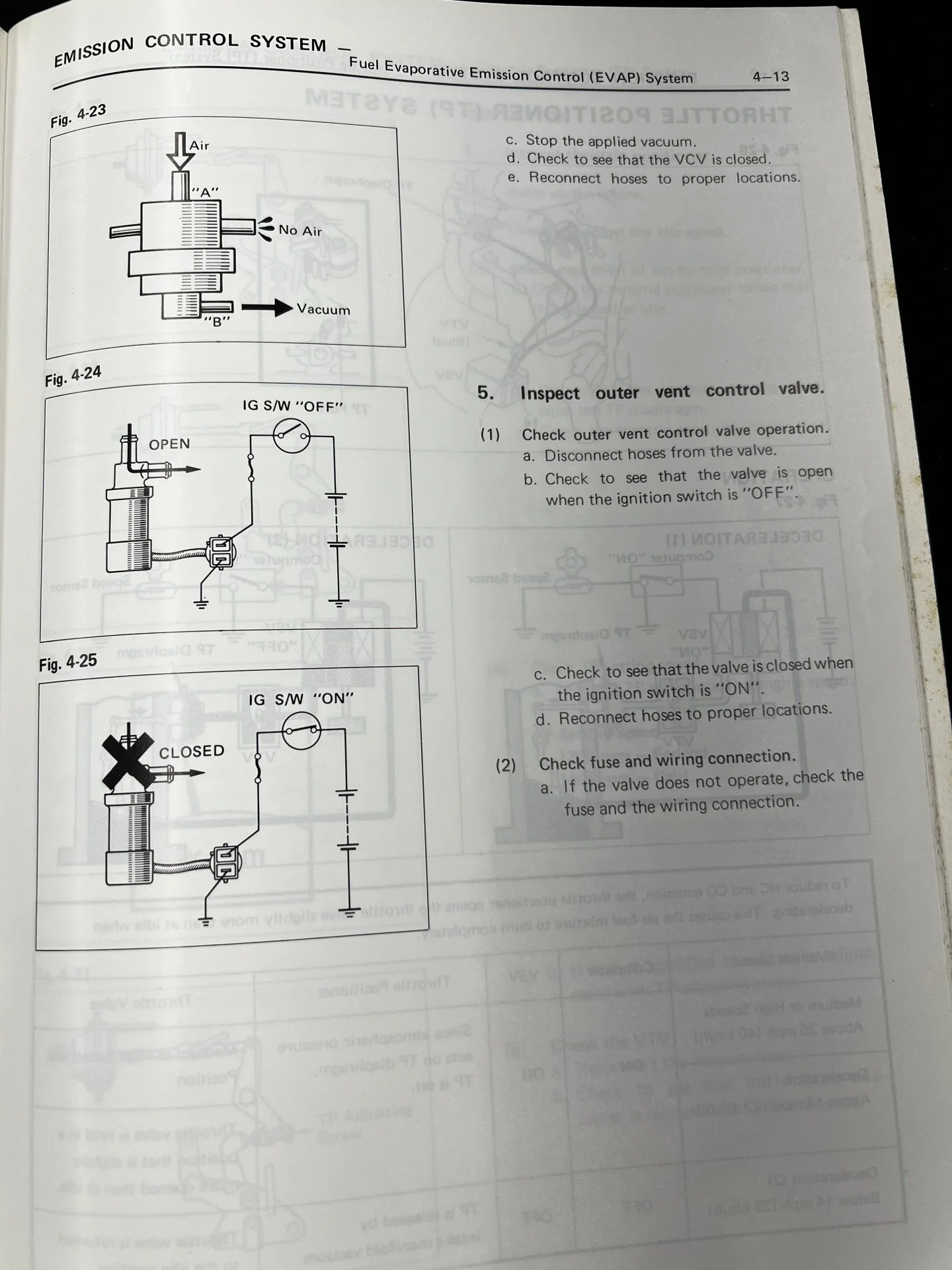

You don’t need to drill your fuel cap. You should fix the problem. Yes, the factory fuel cap lets air into the system. The EVAP let’s air escape. You’ll probably find the previous owner capped the line when he removed the charcoal canister. Try following the steps in post 5 below. You are essentially looking to find the blockage starting at the exit of the charcoal canister and working backwards until you find the blockage. Since you don’t have a canister, start by inspecting the line that should provide the input to the canister. In my case, I had a mud dauber block the input line to the charcoal canister.
Let it pressure up and take the line off the separator to tank, if it relieves pressure then the separator is blocking the out flow of tank pressure. Why can you suck vapor thru and it will not escape on its own, good ? but it does not change the fact that tank pressure is not getting to that check valve or is getting stopped there, IMO take the separator out and have a look.
Hopefully this helps:

The pressure is from the natural evaporation of the gasoline, even when parked your tank will build pressure. I think the check valve needs a vacuum signal before it will release the pressure from the tank. I remember going through similar problems with my EVAP system, it feels like the tank is gonna blow apart, but in reality it's probably <1psi in the tank. I was able to sort out my issues with the VSV and emissions computer under the dash, and it's been working fine since. Without those parts, I'm not sure if just hooking it up to the air cleaner will work, it might not have enough vacuum to overcome the check valve.
No vacuum signal needed, but I’m sure it helps the delta and scavenge a bit. Pressure just builds beyond the small amount the check valve will hold. That way you don’t stink up you garage when the vehicle sits. My system works fine and it just vents to the atmosphere post charcoal canister.
