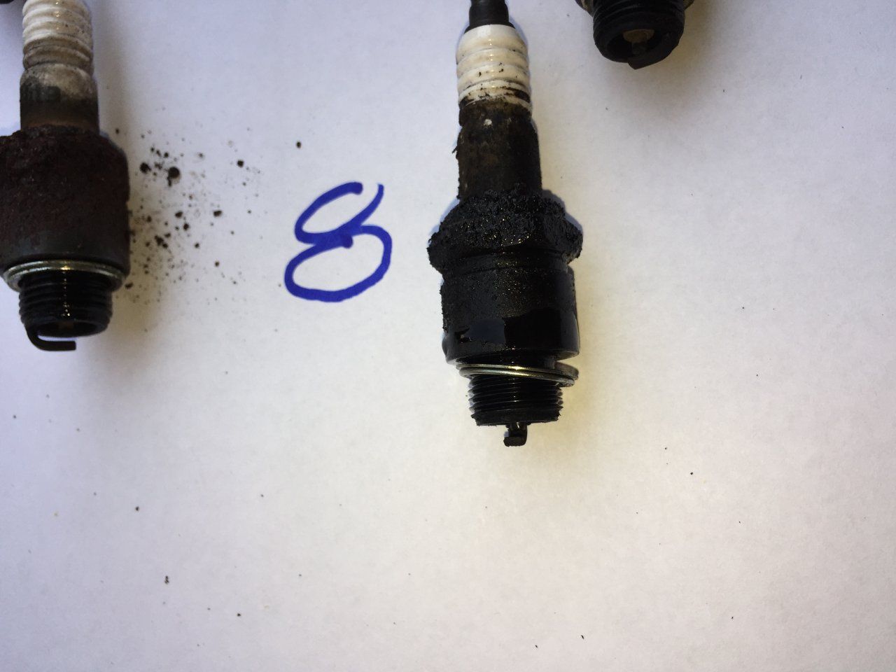

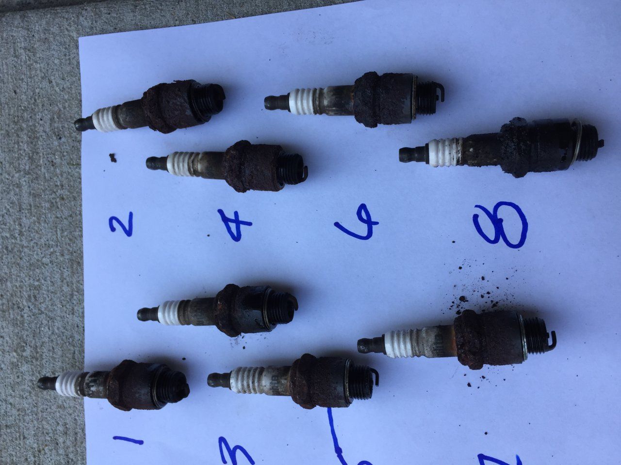

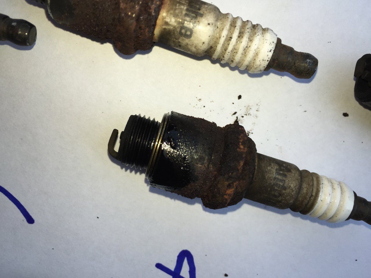

Anyway - I ran the truck up to operating temperature, then cut off the fuel supply to drain the carb until it died. I pulled all the plugs, opened the throttle plates on the quadrajet, disconnected the HEI. All of the plugs appear to have significant oil fouling. They were legitimately "wet." Granted, I have no idea how long these plugs have been in the truck. They were in it when I bought it 3 years ago. I've driven 500 miles on them in that time.

Here are some shots of the plugs:

What do you all think? Is this too good to be true or do I basically have a brand new, incredibly leaky 283?
