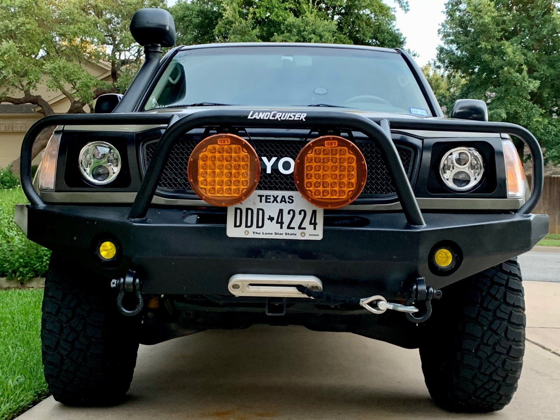

Hey, folks! Need the collective wisdom of the forum. I recently converted my '99 UZJ100 to the round 7" headlights from <www.landcruisergrilles.com>. The mounts are a very nice quality item and the installation was straight-forward, but when I plug the lights in (using the pigtails provided with the kit), both the low beams and high beams turn on at the same time, regardless of which position the OEM switch is on. How have others solved for this? My truck won't pass inspection in the state of TX without separate low beams and high beams, and while I have a few months to get this figured out, I was curious to know how others who have completed this conversion have done it.
I'm including a couple of pictures of the old girl with her new look:
show us how you plugged them in, also, show the new light's plug, assuming there is one, or is there two? You said pigtail maybe you used a splitter for both stock plugs.

Show us your wiring

I will take some pictures of the wiring this afternoon.
