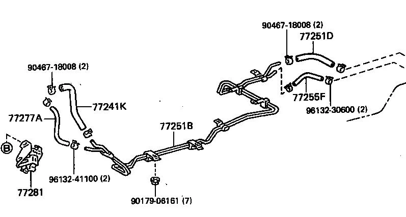

Anyone got a picture of the "correct" fuel line routing for an hd-t?
Here is what they look like on Toyota EPC.
I would bet that your lines are in the factory location, they are probably the original 3FE lines.
Pull the rear seats and carpet to access the fuel pick up to see what's going on, modified gasser pick up or
diesel pick up.
But of course run the motor out of a mason Jar first so you know which way to look.
If there is air getting into the system the first place to look is the primer pump/fuel filter cap assy, that is assuming one was installed as part of the swap.

hmmmm
going to have to get under there this weekend and see where the lines go/what pickup it has.
