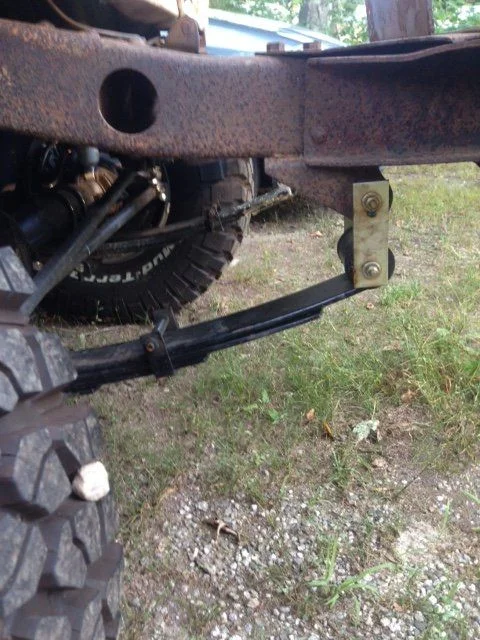

Rear and by far the worst. This is what has me worried because you can see that rather than swinging, this shackle is almost in line with the spring and thus would have no where to go except to impart force up into the frame.

[Spencer] Yea, that shackle angle is pretty bad. It's been pretty rare for that to occur but I have seen it a couple times before. Some seem to either be slightly lighter or have a slightly different shackle position and our springs end up looking short. You can remove the very bottom spring and it will soften it and allow you to not have that angle and then can be put back in once settled

The rear springs are pretty much crap from those pics. I would scrap them or use the leafs to make yourself some knife blades. The fronts could be salvageable if you wanted. Here is what I would do...with the rear I can think of two options to help yet be economical. Option 1: I would get a custom pack made. Alcan or Deaver, or some other reputable company. Tell them what you want as far as ride characteristics. A pair of custom springs run about 350 a piece. Option 2: By a pair of off the shelf 4" lift fj60 rear leafs, cut off the axle leaf perches and weld on 3-hole adjustable perches, purchase the bushings needed to install fj60 leafs on the back of a fj40(I don't remember exactly which bushings they are but a search will give you the part numbers on mud somewhere) This will give you a longer rear leaf pack, it will flex more, will move the rear axle back 1.5", and should give a nice ride. Option 2 is a bit cheaper, but involves some more fabrication. For the front, the shackle angle is not great for sua. I would take the front shackle bracket, flip it, then install longer shackles(like 6 inches eye to eye). That will help give you a much better shackle angle, increase flex, and soften the ride. Or their is a 3rd option and save up like 1500 bucks and buy a old man emu complete lift kit which rides pretty decent. I am not happy with any of the off the shelf sua lift kits for 40s. I think using lifted fj60 rear leaf packs front and rear and adding or removing leafs to make it level is a good way to get a lift, or have custom packs made front and rear.

Why not just pull the bottom leaf like they recommended? Last expensive option. I had a set of alcans that had just as bad of shackle angle as you have (the front looked like your rear shackle angle). I pulled a leaf and improved greatly. I customized springs on at least 4 of my cruisers to get the height, shackle angle and/or ride that I wanted. Also make sure your shackles are able to move. If they were torqued down in the current position it may be limiting the ability of the spring to flatten out. Good luck.

As an experiment, you can remove the longest leaf that doesn't include a spring eye. This will relax the arch and the lift and see what your shackle angle looks like.
