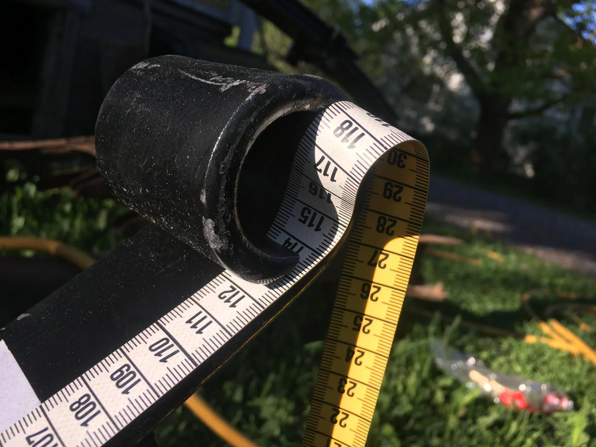

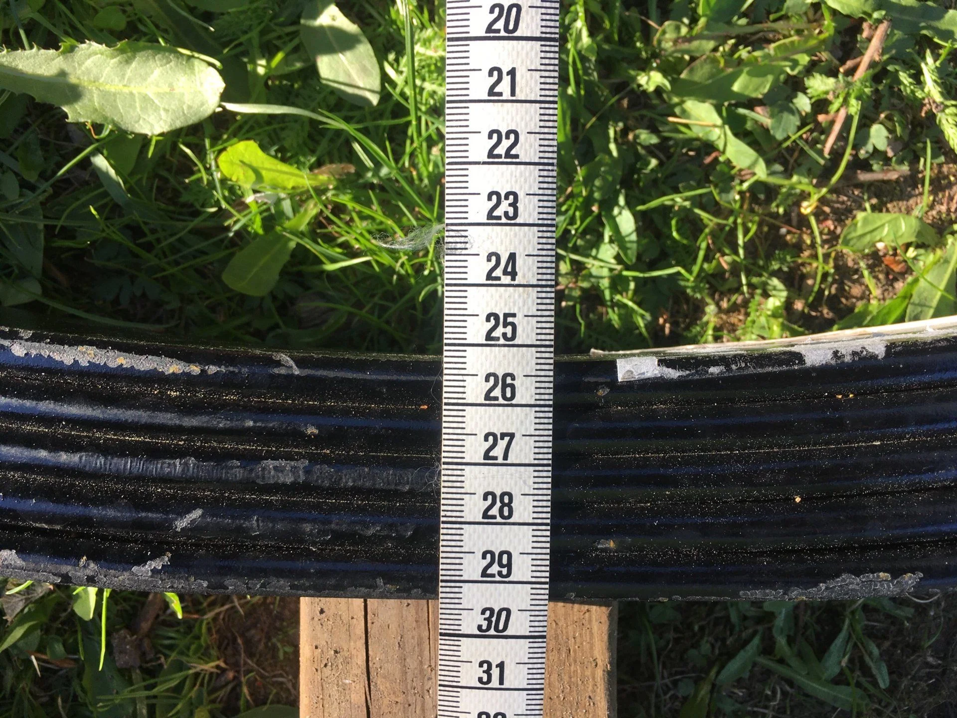

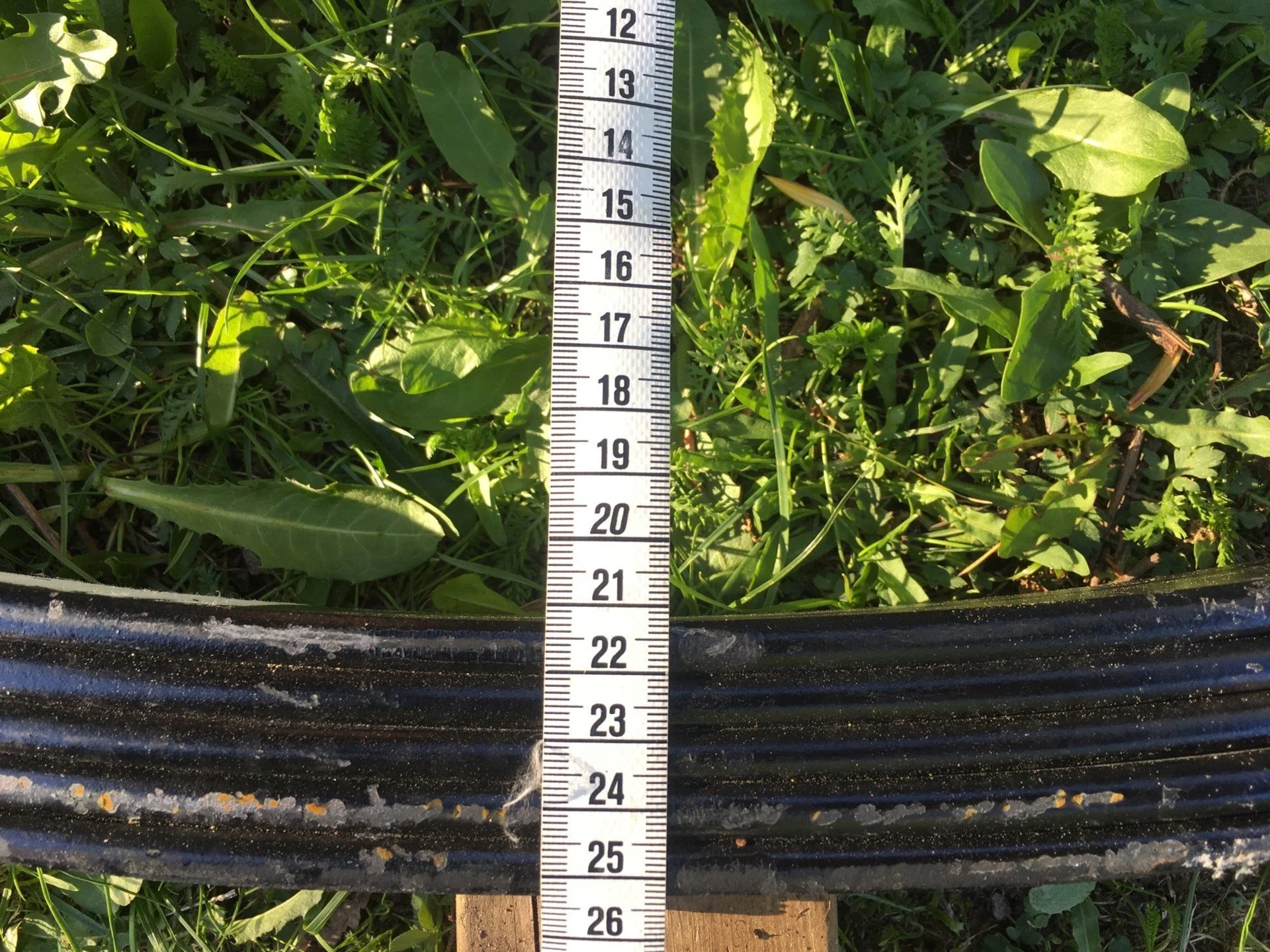

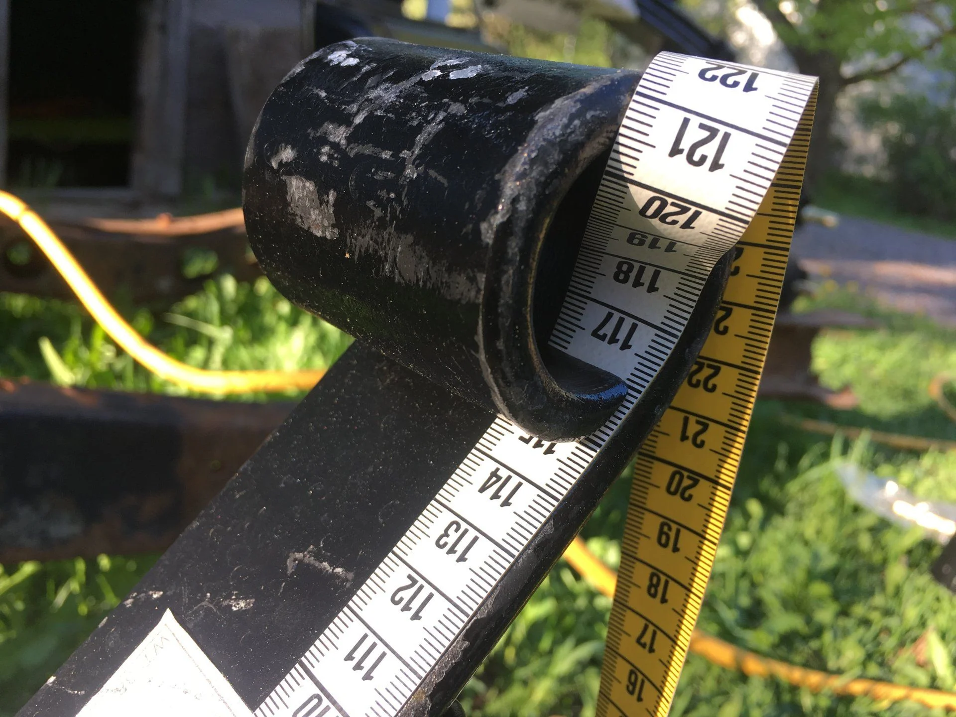

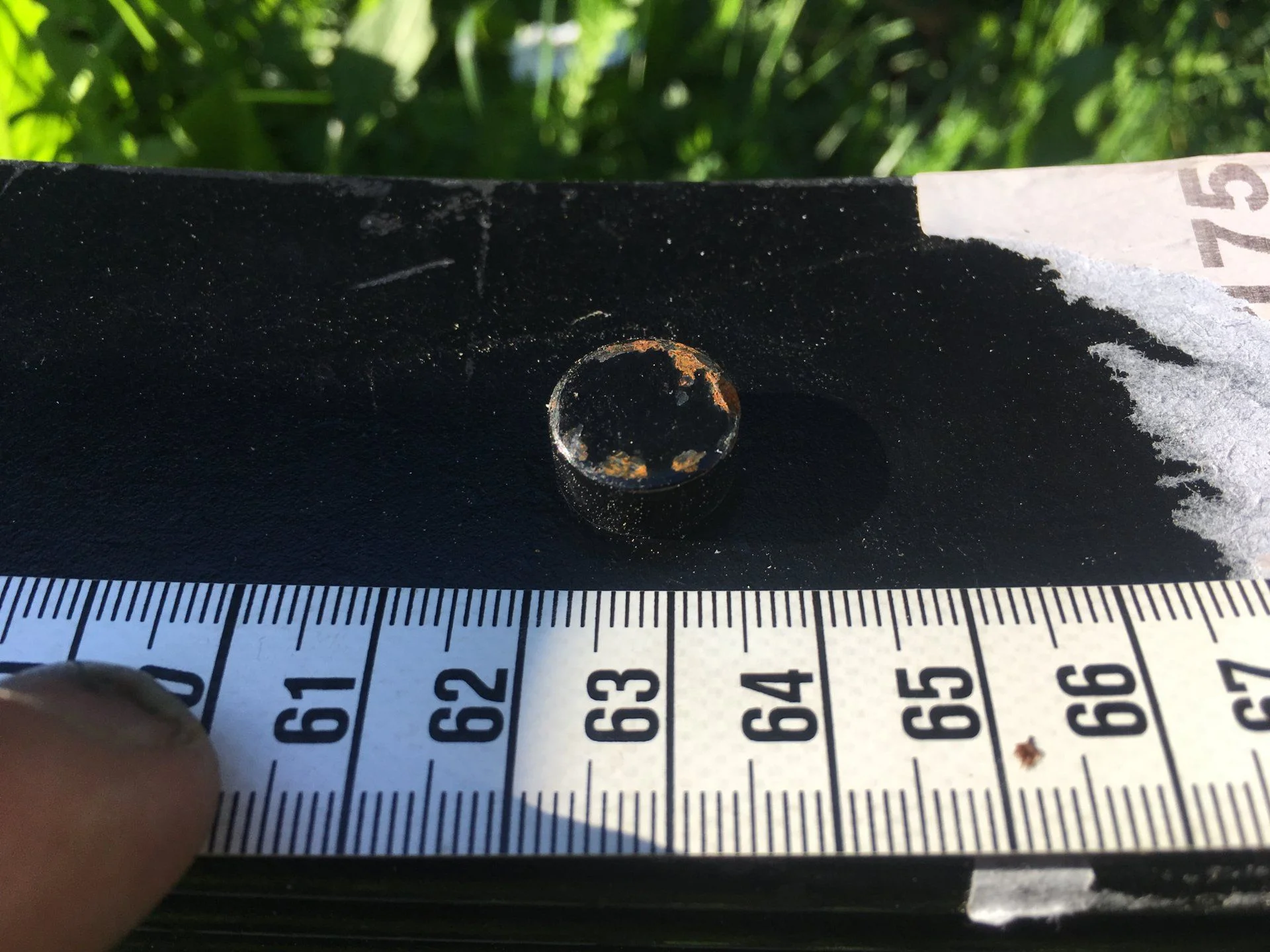

I didn’t found anywhere specs for the Rough Country 4” springs, even their customer service don’t have exact measurements.
So, I measured them if someone else would like to know too.
And yes, there is some anti-friction pads between. That was one question too without proper answer.
They came without any package/insulation from the factory, so there is cratches/chipping in the paint already.

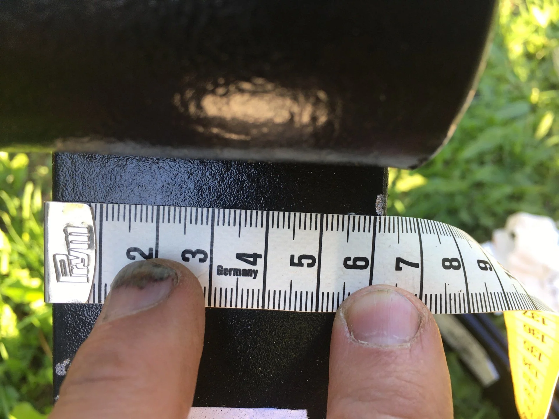

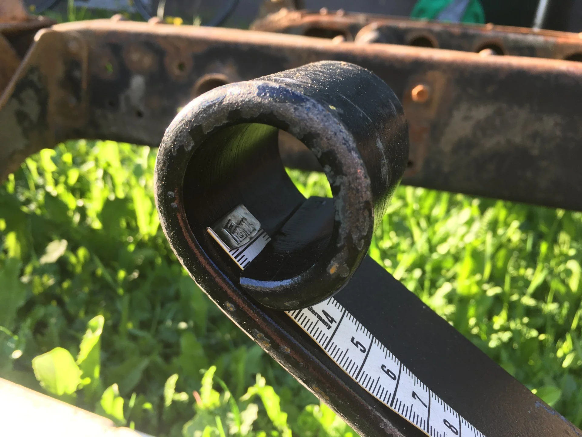

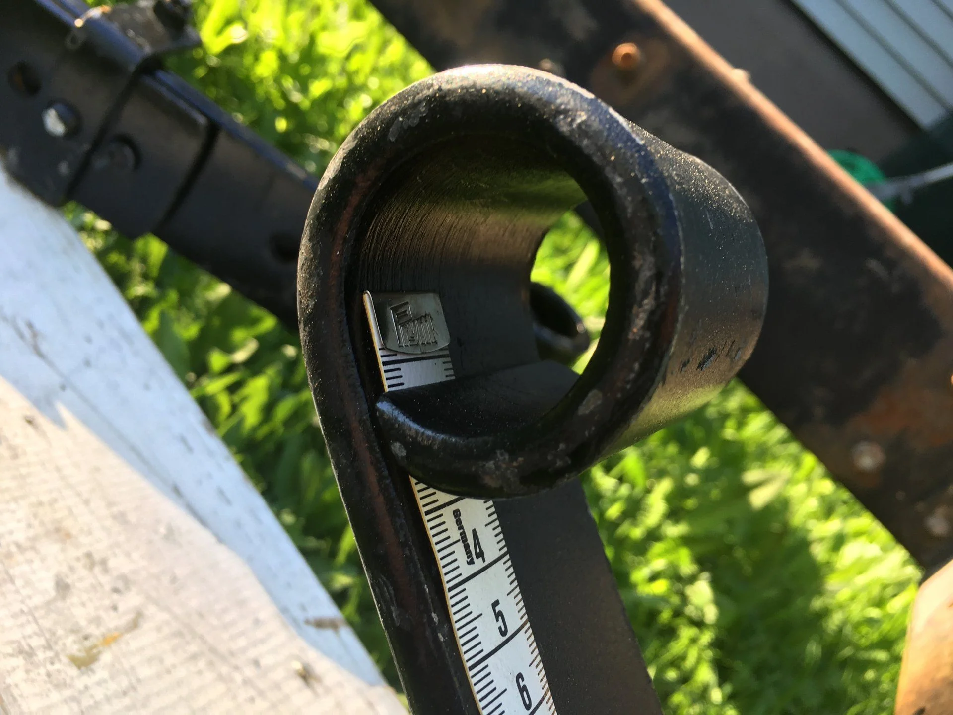

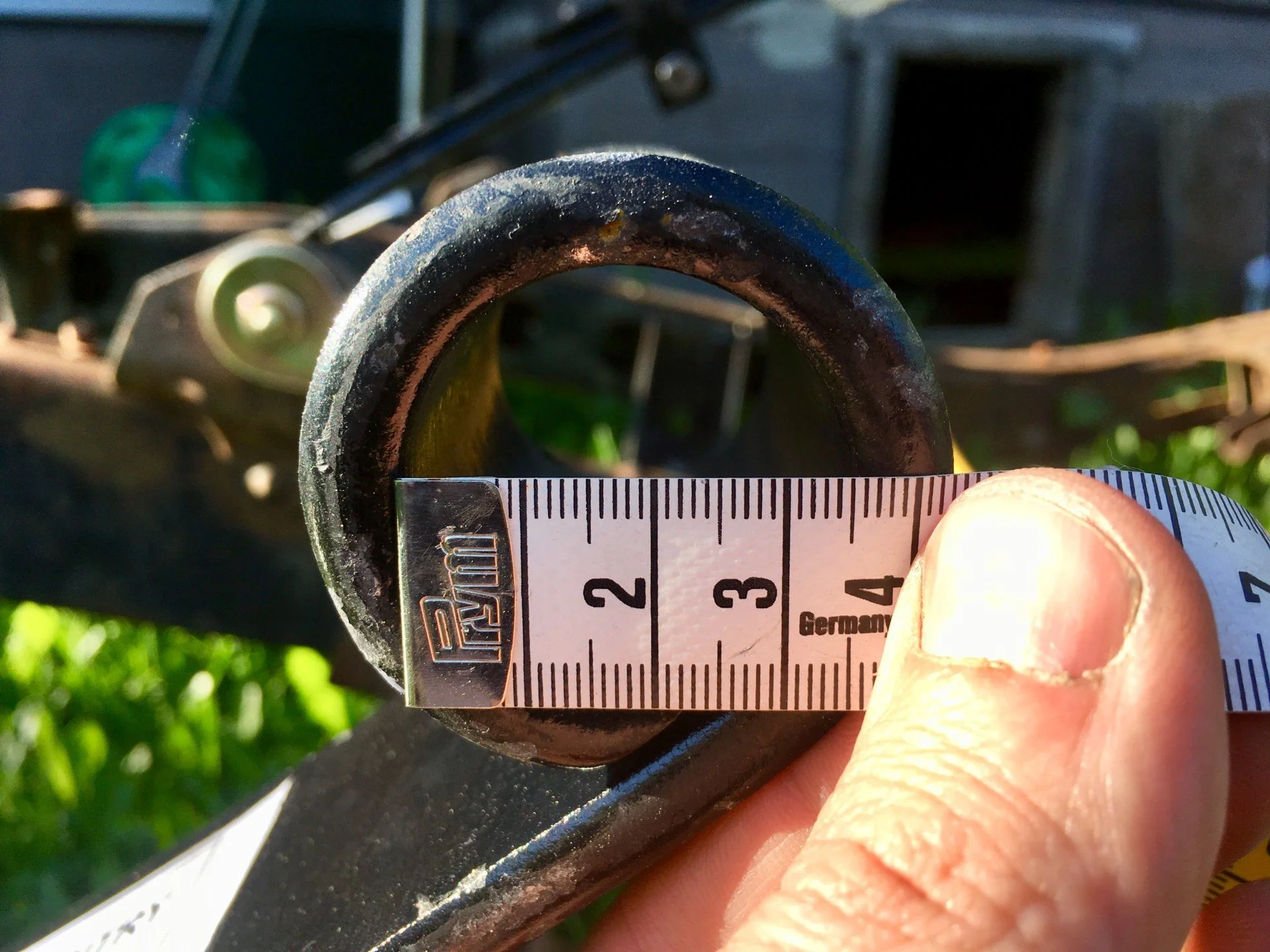

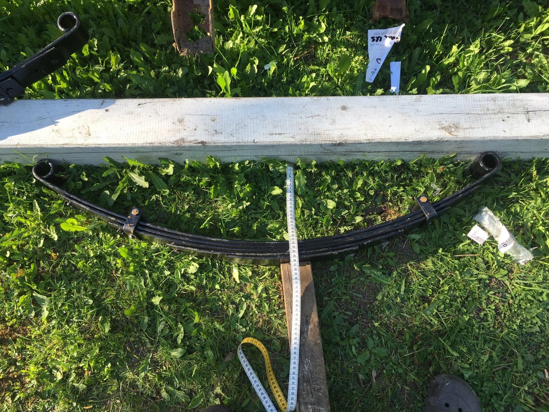

Front spring:
Spring eye Ø and width:
Eye to eye, front: 1055 mm, rear: 1030 mm.

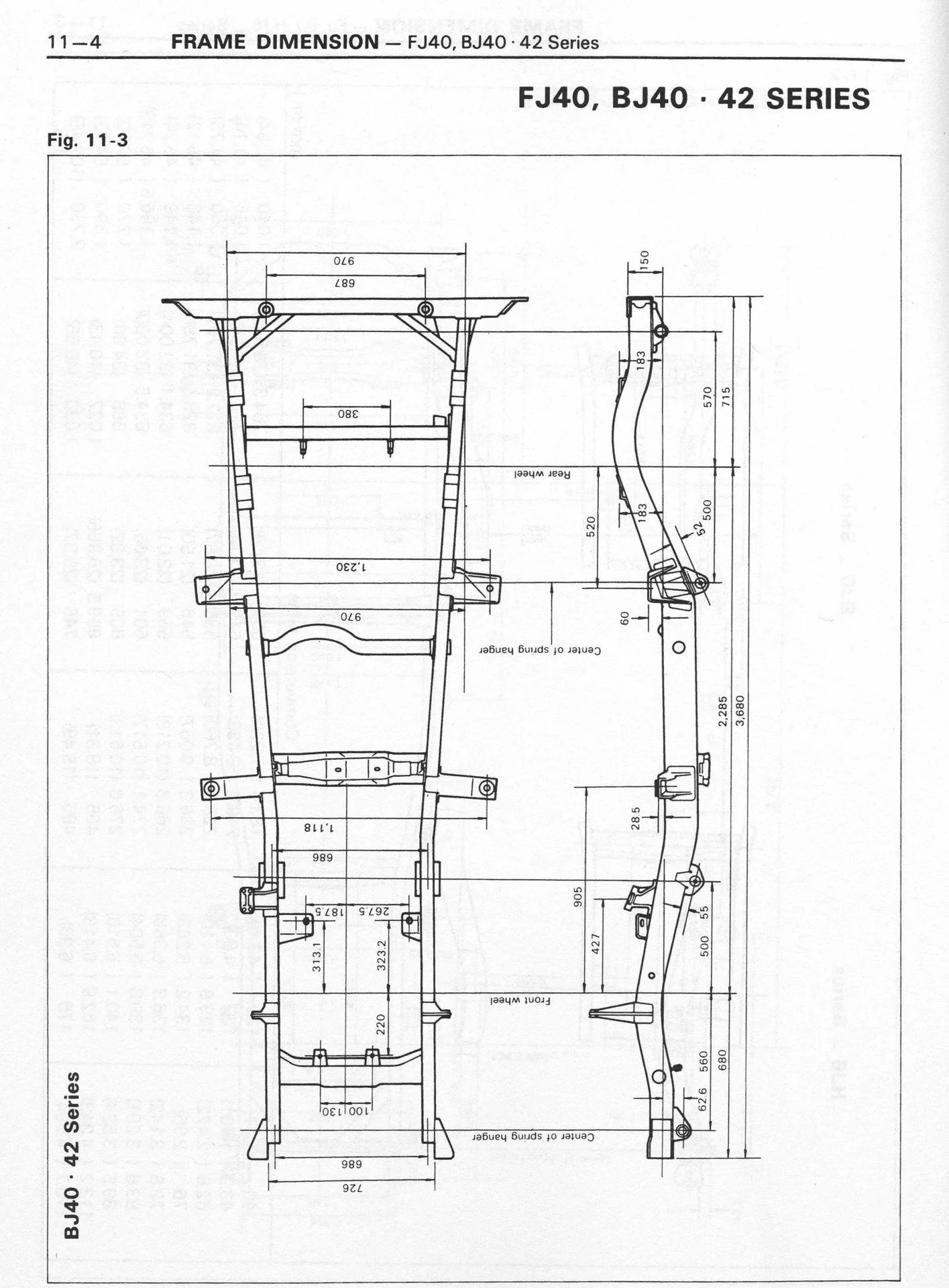

And the frame dimensions:
