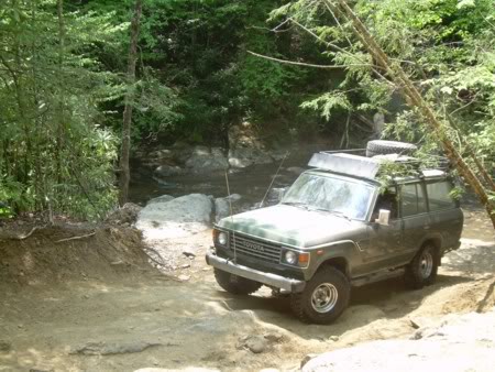

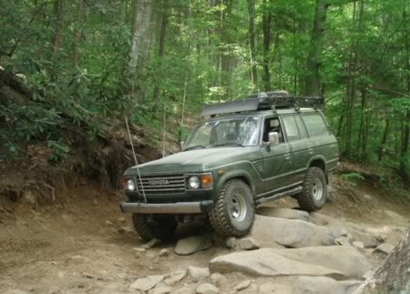

First trip out wheeling. Testing flex capabilities

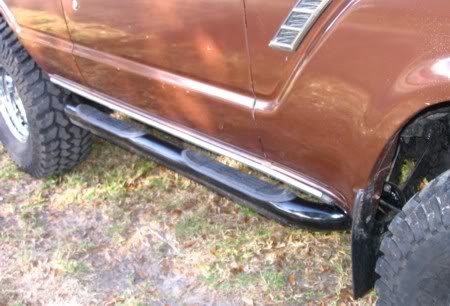

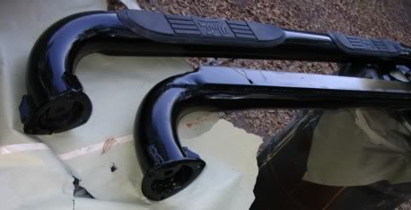

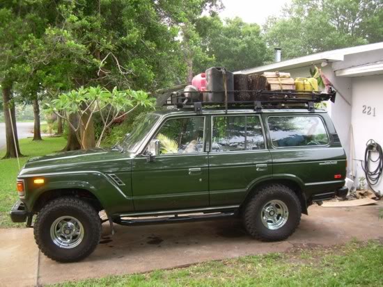

Accessorizing came next. Added an OME lift, built a roof rack, made some low budget sliders out of some old nerf bars and made some quarter panel protection out of some ¾” solid round bar.
Accessorized and buffed out.

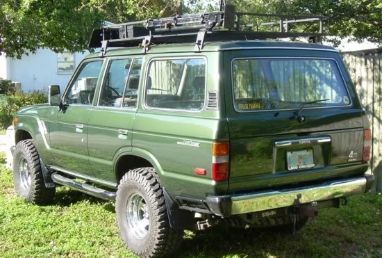

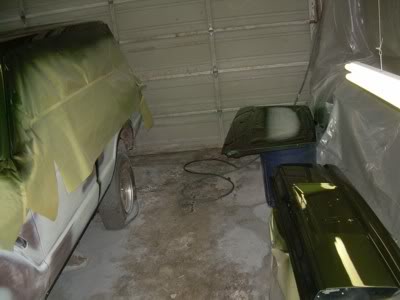

Last year rust started appearing in various places, especially along the roofline. It was like it appeared out of nowhere. It was time to restore the body and paint it. All the rusted areas were cut out, steel patched and mig welded. A little sandblasting, Ospho and POR15 were thrown in. The color was changed from brown to green. I did all the work myself at home including the painting.
Fresh paint and all back together

Nothing too hard-core, but did some wheeling in Stinky.
Tooling around the easier trails at Tellico

Looks really nice. Is there a writeup of the painting process somewhere? did you remove the doors and fenders and paint them off the truck.
Also, was any engine bay modification neccesary before you put the new motor in?
On long trips, how do you aquire and filter vegetable oil?
Looks great, I love the green.
Thanks.
I didn't write up the painting process. Fenders did get pulled, but not the doors. All weatherstripping and trim was removed and jambs painted. No mods were needed in the engine compartment which was nice.
At one time I carried a barrel pump, strainers and filters on long trips, but usually the veggie oil acquired at strange restaurants caused more trouble than it was worth. Now the roof rack gets loaded with dozens of jerry cans of veggie before a long trip.

that's one pretty lookin truck. I really like the green that you chose for the color.
what kind of mileage do you get off the veggie, and do you just get it free from some restaurant in town?
Nice looking rig. Good write up. I have a customer at work who has a diesel Suburban he runs on veg, and he often travels on long road towing his bass boat for tournaments. Sometimes as far as Oregon to Texas and back. I guess there is some network, I'm assuming internet based, of "veggie guys", that you can plan ahead of time with to hook up and get oil, already filtered and ready to go. I don't know much about it, and haven't had a need to look into it. It's been quite awhile since he told me about it, but maybe something to look into if you do a lot of long road trips. :steer:
