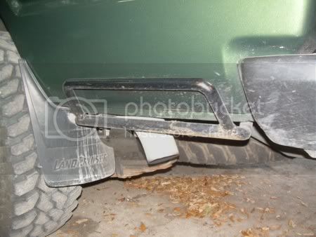

very cool. I like veggie rigs. I wish I could do the same in the future. I really like the green paint as well. Do you have any pics of the quarter protection?

cool!! I really dig your 60, and that color is awesome!!! also interested in the quarter protection it looks interesting

They aren't that much protection for hard wheeling, but serve the purpose for light use. I know they saved the lower quarter once when the rear end slid off a rock and came crashing down on another rock.
