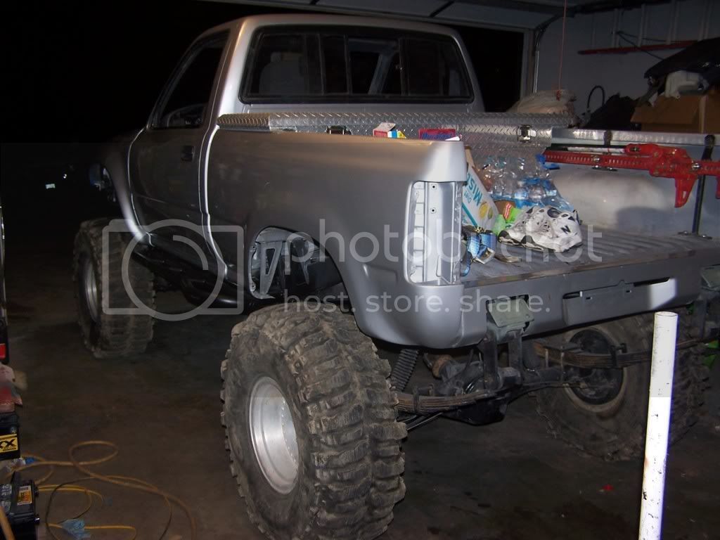

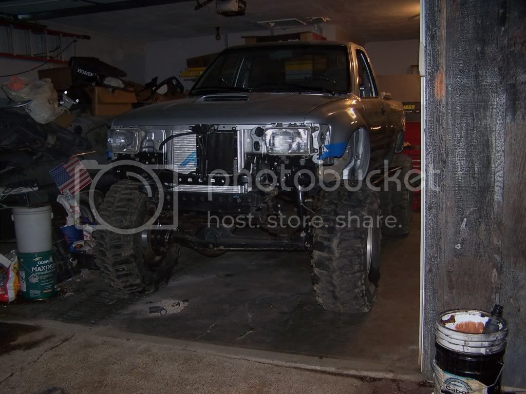

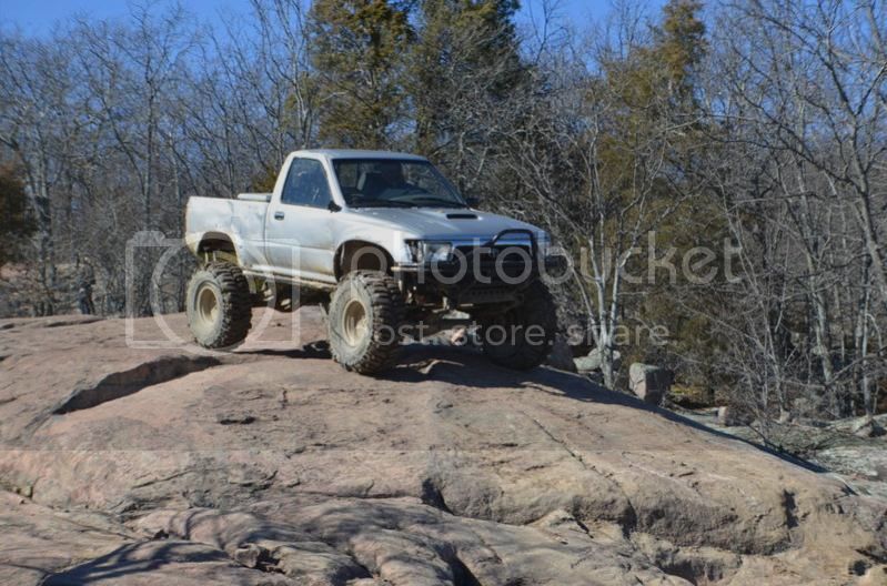

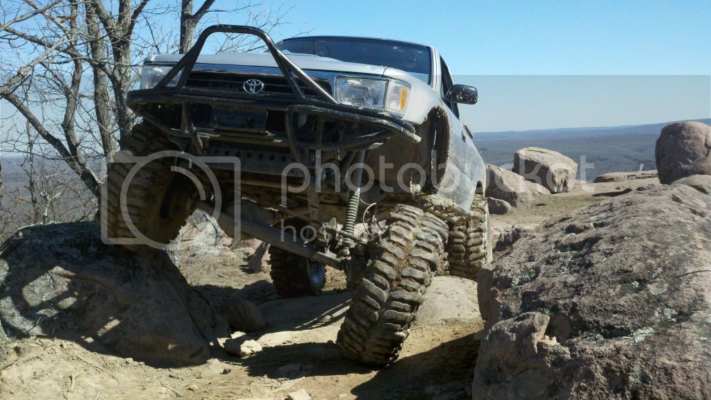

Just thought I'd revive my build thread and post a few updated pics
The truck is running great....the only mechanical problem I've had to date is the Jegs thermo switch for the cooling fan failed.
It had also become quite obvious that the power steering pump on the Lexus motor is not as good as the truck's pump....I really need hydro assist.

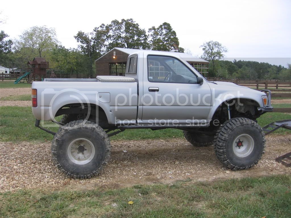

Finishing the final assembly the night before it's first trip.
Fresh off the trailer

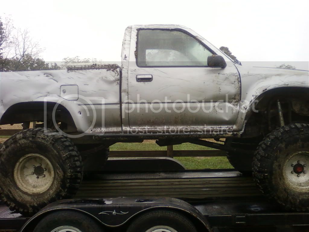

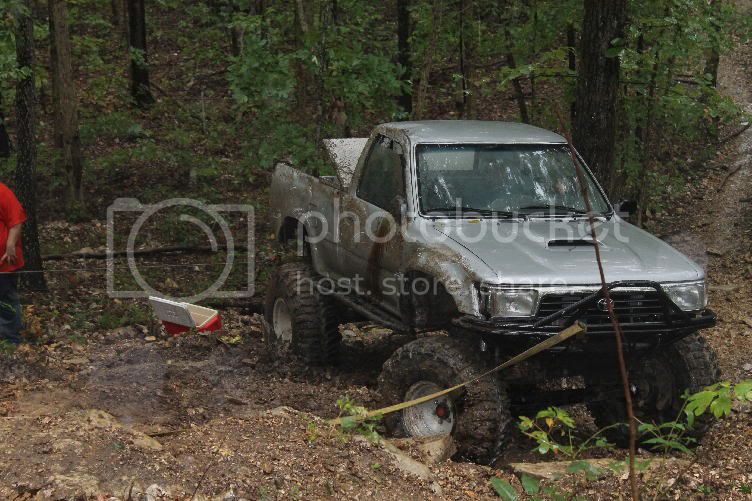

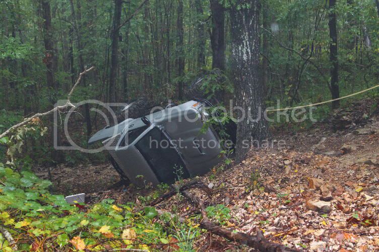

A few hours later - s*** happens. not gonna fix anything...just wheel it like it is

haha, and isn't it funny how you can put a toy on it's side and the windows don't break...my x recently sent her runner off a hill, landed on the pass. side, and it didn't even break the mirror....and it had some momentum.
Yeah my girlfriend was even standing on it when she was getting out of the truck and it never broke. the door even opens and closes just fine.
This is one of my favorite trucks of all time. i actually found a picture of it when it was white and I saved it and set it as my phone background. I had no idea it had a Lexus v8 in it. I really like the fenders and hood. I am going to have to reread the thread more thoroughly to see where they came from.
Again, awesome truck. Flop sucks, but that will "buff right out" :D
I don't know whether to stop smiling or cry about your flop. You already built it up all clean again, so I am sure eventually you'll do a cab swap.
Maybe this time follow our method,
"Rule #1. If you build it and use it, you're gonna dent or break it. Here's a ball-peen hammer, go knock a dent in it ASAP so we can have good clean fun the rest of the season."
Swap the cab and parts out, repaint it, then go smack the crap out of the inner side of the bed or tailgate w/ a ball-peen or bfh? :D
I love the flop pics! The rig looks better with a couple of dents in her :hillbilly:
This is sig line material right there.:clap:

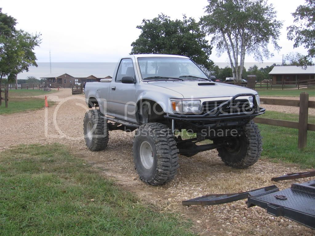

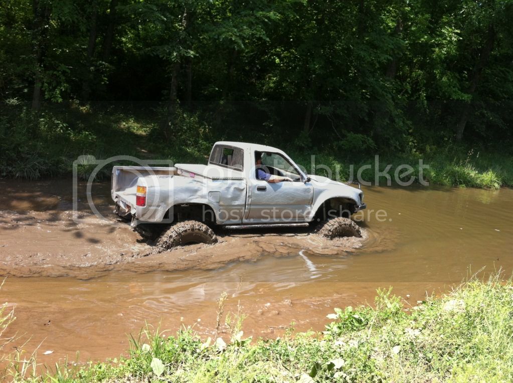

Here's a short video and a couple of recent pics.
