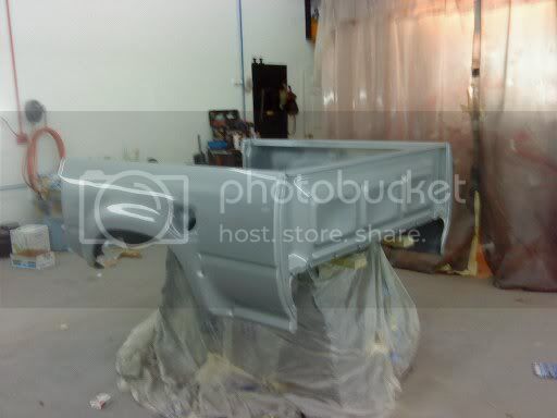

my painter sent me some pics from his phone.

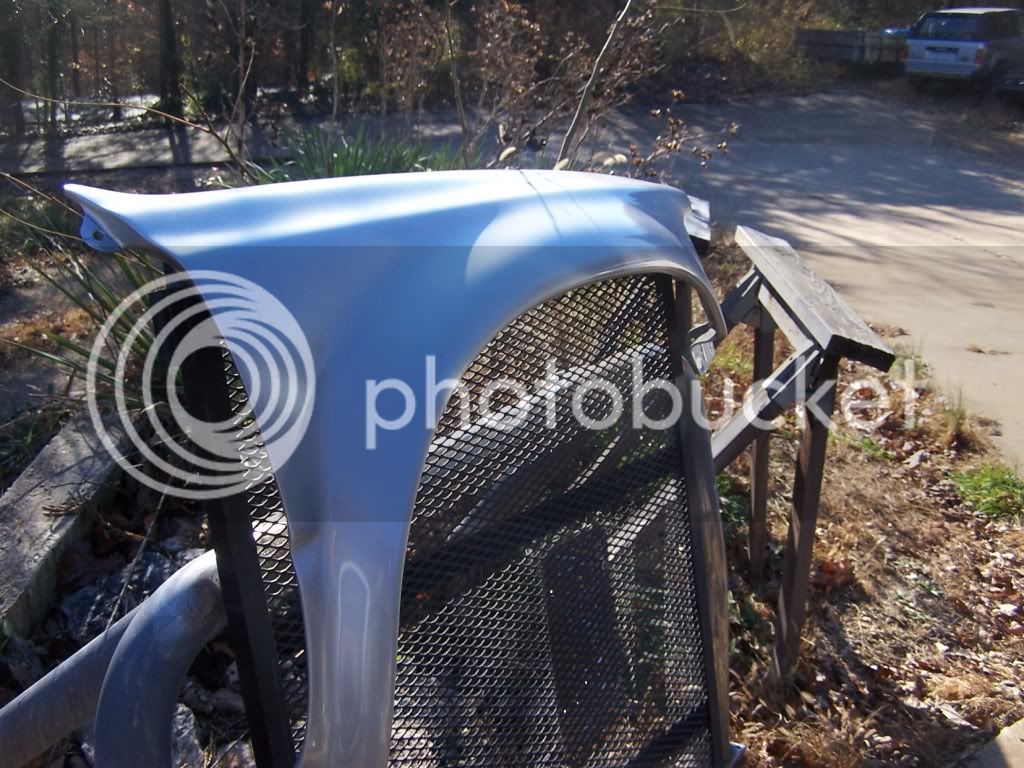

I little bit better quality pic of one of my fenders. Silver is hard to capture on digital pics.

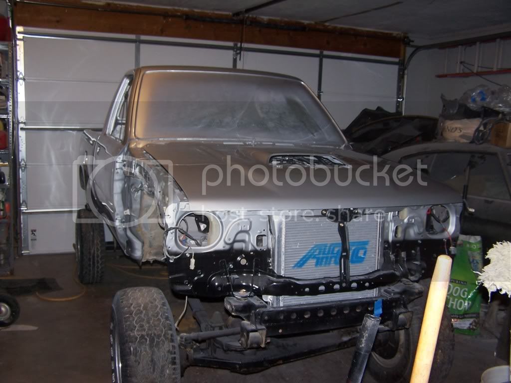

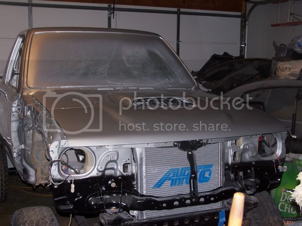

Got the truck home this weekend. *Now all I need to do is get a windshield installed and I can re-assemble everything. *
Your buddy did a clean job on the bed-bob. Nice rig!
I would be that buddy that did the first bob, this time dont wrinkle your new one all up!!!!

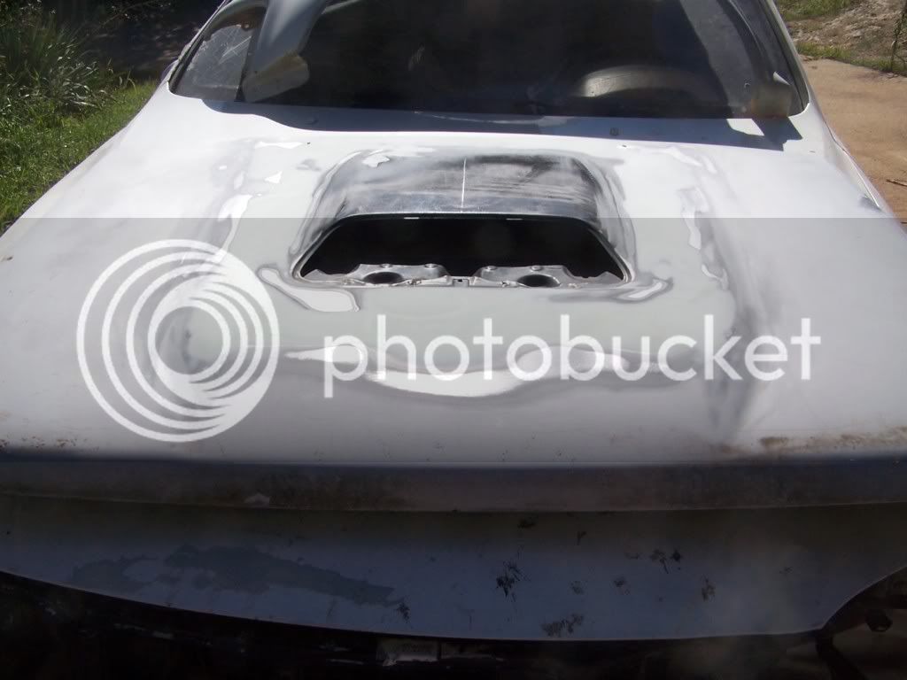

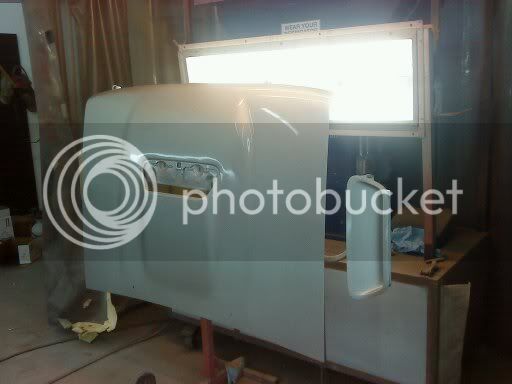

Did a bit of work on the hood today.
You need to let me fiberglass mold that hood for you so you have a spare when you need a backup!!! :)
The truck looks really good steve, My 4runner is way behind your swap.

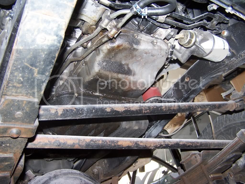

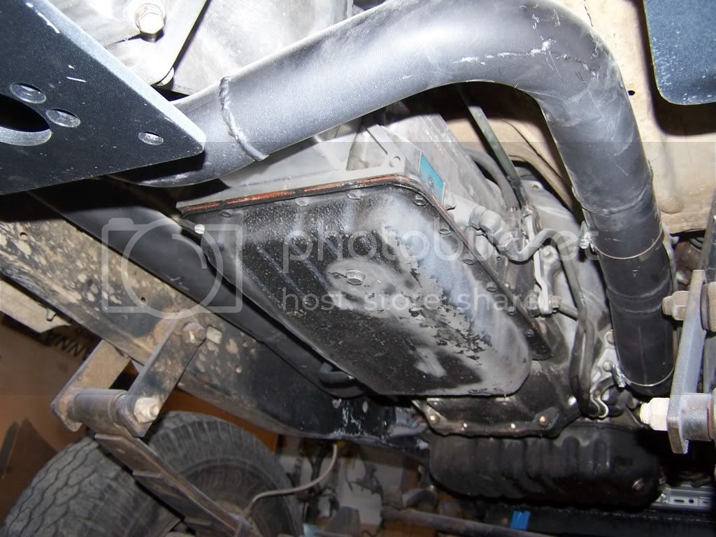

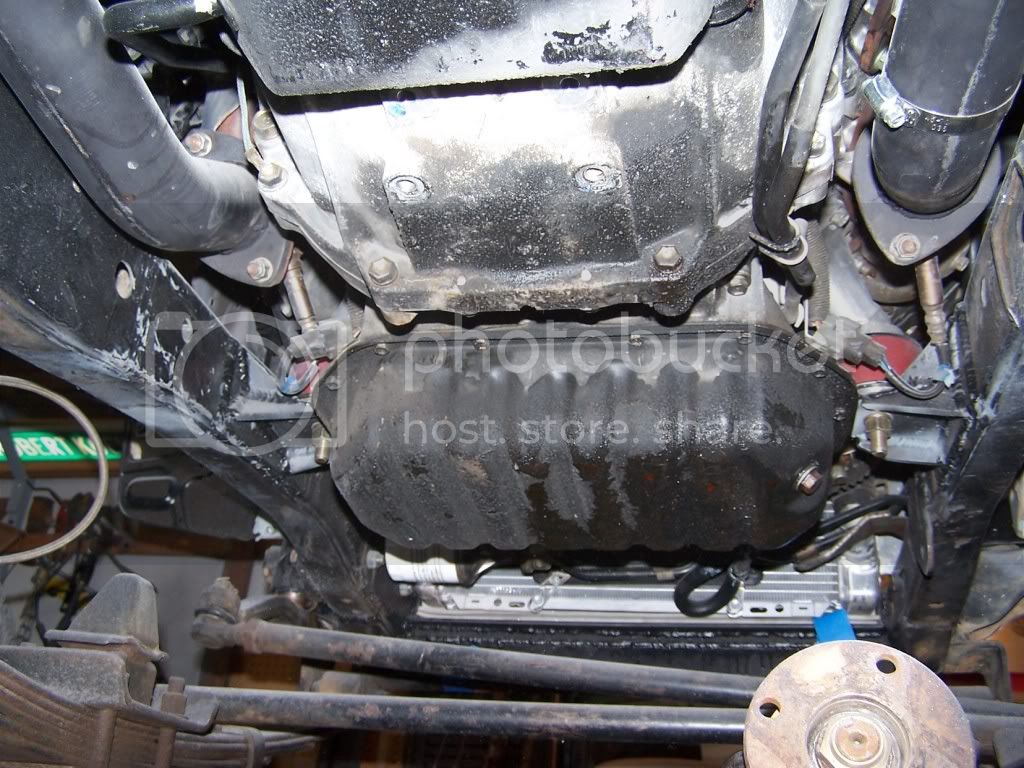

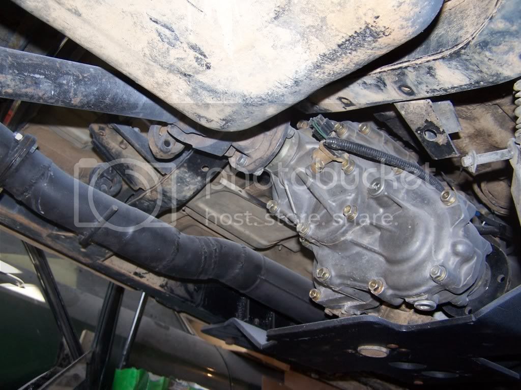

Dam big motor. I still need more pics of the underside please.
