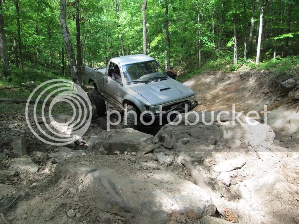

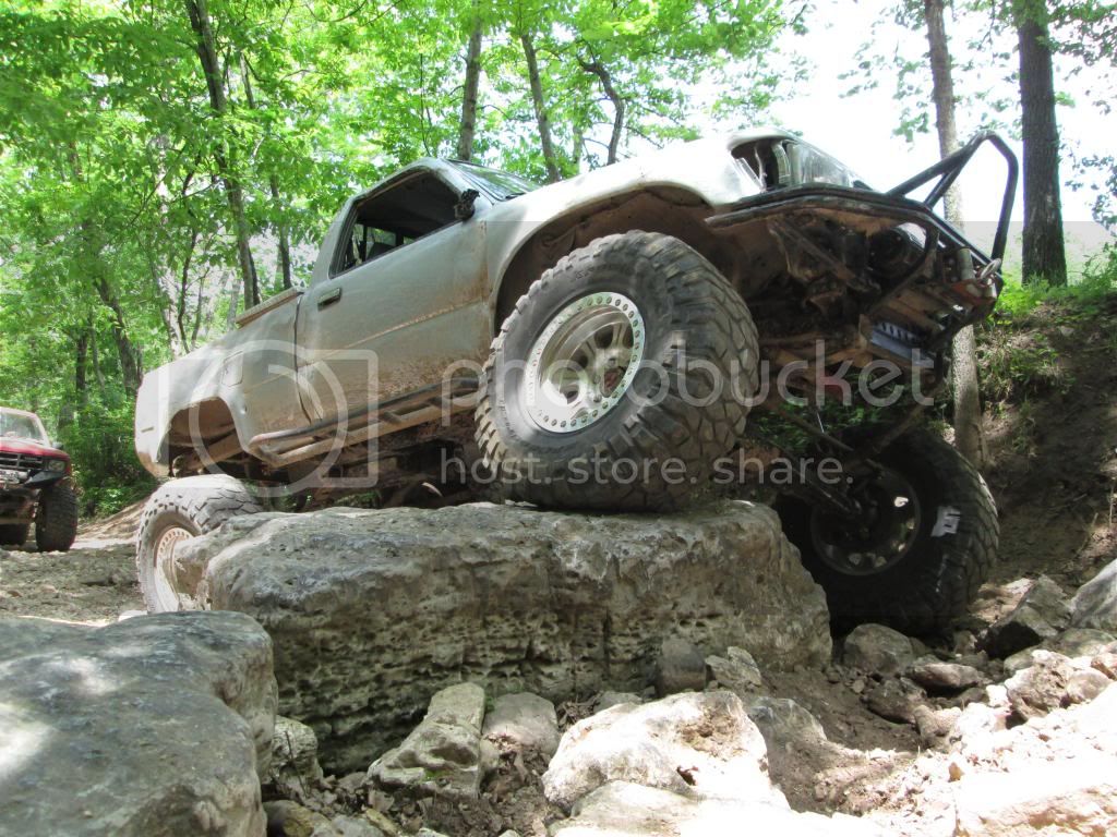

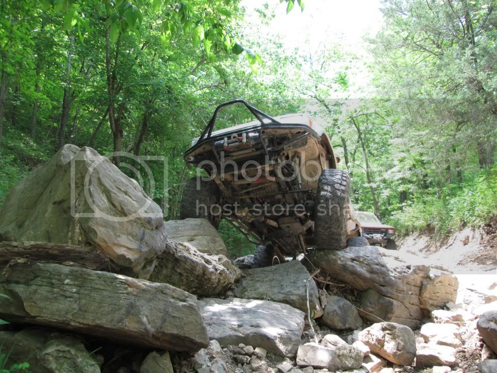

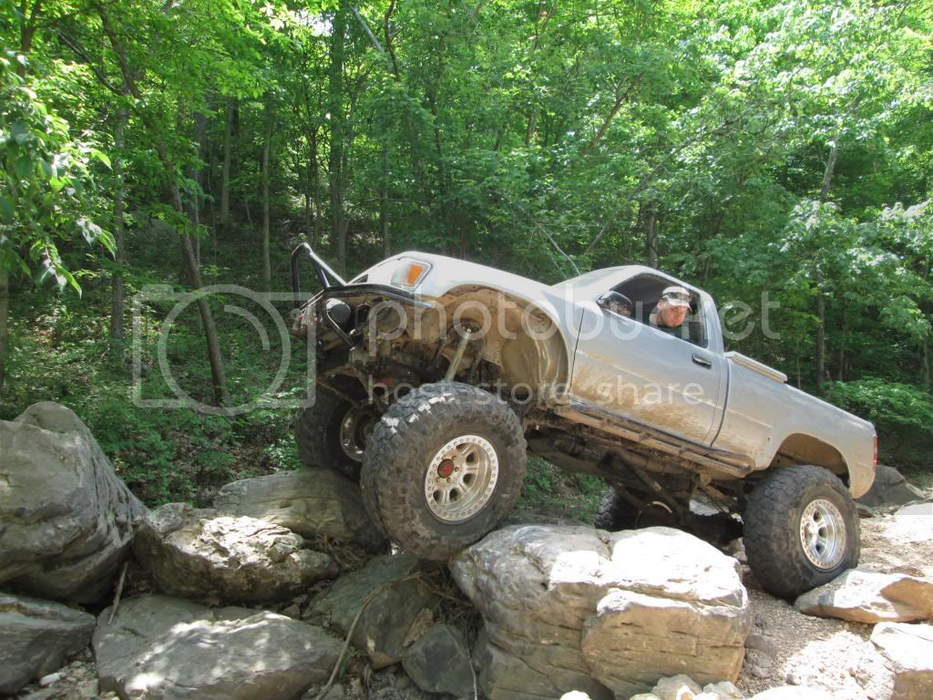

Thread revival..just a few updated pics. No V8 swap related issues to date. Everything is performing perfectly.

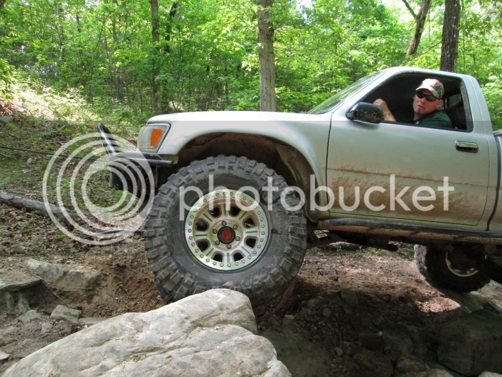

Also, are those new wheels and tires? I like them regardless.

I finally spring for some Raceline beadlocks. I needed 17" wheels for the Krawlers I got and all i had was 15's.
