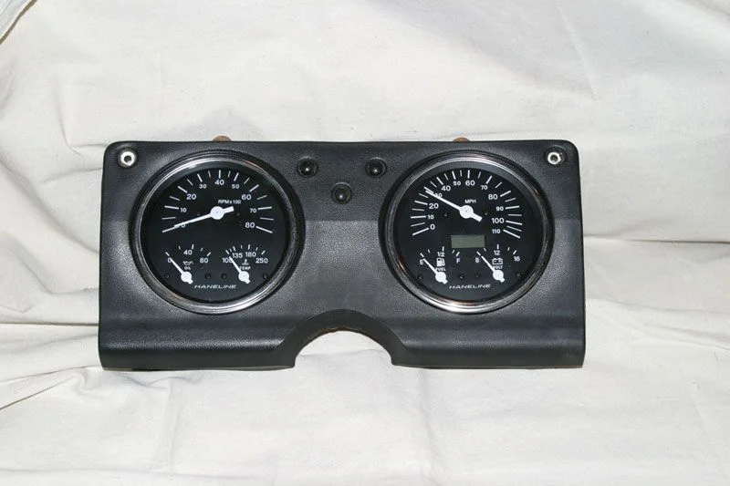

I really like the way you did the guages, i wanted to do the same to my 55 and was wondering how to do so. Can you post up exactly how you got them to fit? did you just trim out the inner portion of the circle to fit and push them in from the front? Also, what holds them in? just a press fit? or did you fashion something to attache them to the back of the pad? Also, what type of guages are they and where did you get them?
Thanks!
Noah
Noah I use a razor knife and trimed the inside ring of the pad down to the metal ring, trim very carefully, the ring under the pad limits the size, so the gauges stick out about 1/4 inch at the bottom. They fit tight but the plan is to fab a small bracket on the back, they clear the dash supports behind the pad. I got them here www.haneline.com . BTW your resto is looking good ......if I had the time , tools, a garage and few more dollars, I would do a frame off like yours but Lance at IPOR said he would cut off my left n...t if I get anymore idea's, so maybe next year. Here's the pic of the gauges,you can see how they stick out just a little at the bottom but from the driver's seat, front veiw you don't notice. The link to Haneline is not working so try this www.roddoors.com this works, go to products and gauges, I'm not sure what's up with Haneline's web page...
