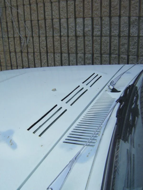

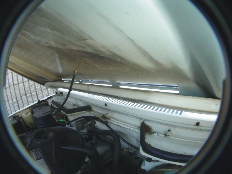

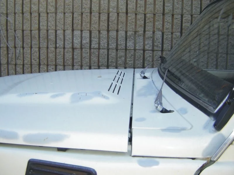

Hi Lou,
I was able to get some pics of the vents I was talking about just for reference.
The first image shows the vents toward the rear of the hood. I am not referring to the cowl vents...
attachment.php
...Note the hump in the center which provides the rearward slope for the vent slits...
attachment.php
...And note the rear bracing also acts as the channel to catch the water, letting it exit out to the sides...
attachment.php
...Where the water travels down the front A-pillars,
Pooling up at the front corners of the floorboards,
Causing complete rust-out and destroying the body mounts
as well...:confused:
But that's another story...
Hope this helps,
