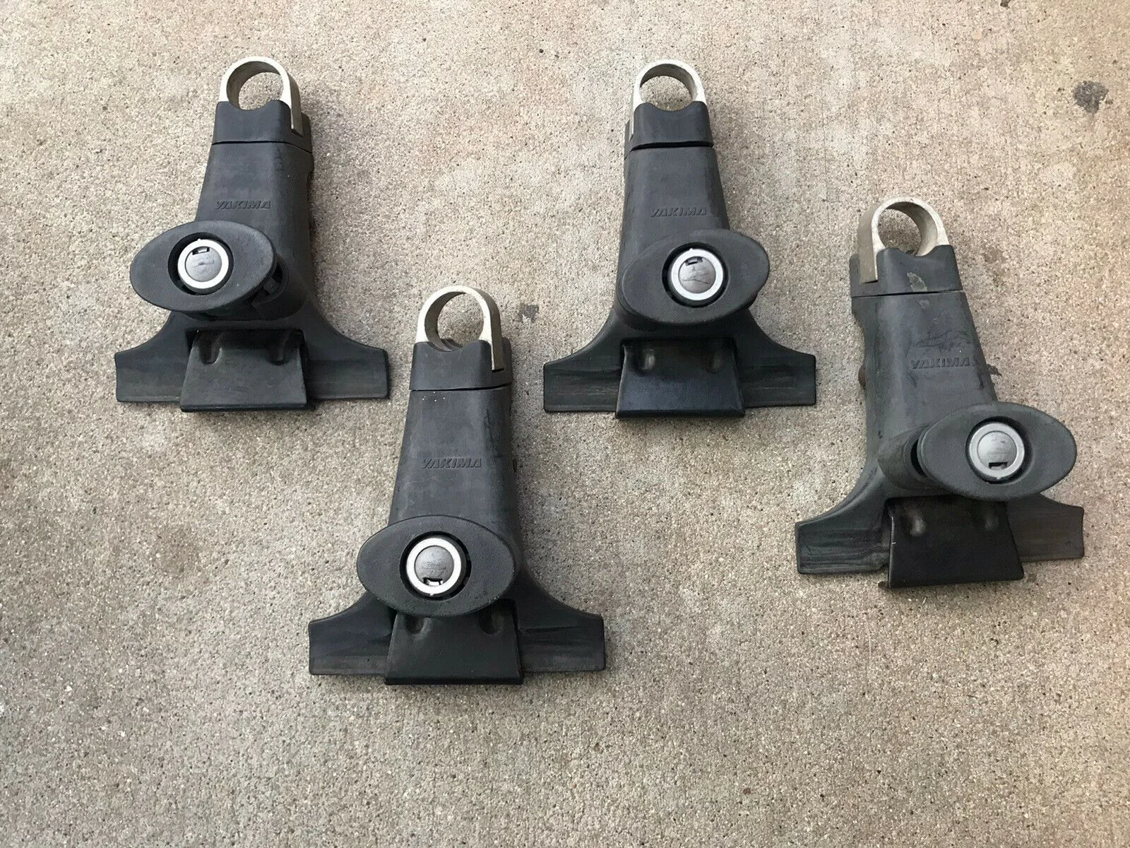

Check your local yard sales and classifieds for old Thule and Yakima gutter mounts they hold RTT nicely as well as plenty of other things and people are always trying to offload them it seems like.. I think around a month ago picked up a nice set of Yakima 1A towers with keys and bars that fit our rain gutters for $80 CAD shipped to me off kijiji our version of Craiglist. They're out there you just need to find them! heres an example of what the Yakima towers look like
I think any gutter mount has the potential to scratch/skuff/chip your paint. The Yakimas are a thermoplastic main body with rubber-coated metal clamps. Those might be less likely to scatch/skuff/chip your new paint. You could Plastidip the Gamivit ones or use some large heat shrink on them.

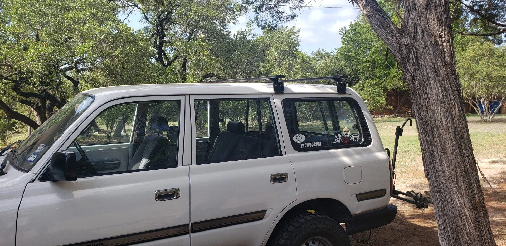

I have the Gamiviti gutter mounts. They're very stout and adjustable. I've got my "rack" about an inch off the roof with the adjustment. My "roof rack" for my tent and awning is very simple. You buy 6 of the gamiviti gutter mounts and you then buy 1 inch square bar from the hard ware store. Drill holes in the square bar and mount it up to the gutter mounts.

I'm sure those load bars are nice and light, but an easier solution is to just by 1x1" square tube from the hardware store. I have 6 gamiviti gutters and some square bar. It's light enough, and you can weld to it, to make awning mounts.
I love the simplicity of the platform style mounts. I’ve used a bunch of the gamivitI standard style Mounts (GX, 4Runner, etc). I’m optimistic my 80 will fit in the garage with just the gutter mounts on, andI can quickly Install/ remove a roof rack When I need to use it.I haven’t measured it yet, but 37’s and standard door height, not much extra room.

Ya honestly kinda would agree with this, Thules stuff is pretty junk for gutter mounts and cross bars in comparison, I’ve always found the round Yakima bars way stronger in comparison, but I do love Thule ski boxs compared to Yakima haha. Change my original statement. Look on classified for the 1A towers and then if you snag some 58” bars which aren’t super common grab those if not new ones are like 100 bucks and then your golden!
The only time I’ve seen a Yakima 1A tower fail is when a tree feel on the truck, slightly bent the Yakima bar and then the 20 year old plastic of the tower broke... heck saved the truck so it can support a RTT in my opinion
