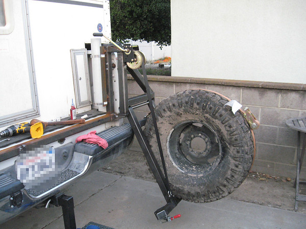

I don't particularly care for swing-out tire carriers because they are always in the way. They are, unfortunately, one of the better solutions. I built one for our CTD/Camper. I don't like lifting big tires & I knew that my wife never would be able to. The binding ratchet strap rolls the tire up off the ground into the mount and the strap winch lifts the assembly up to horizontal. The latch is oriented to draw the stop up tight against the main tube and provide some additional support for the swinger assembly.
This set-up now has several thousand miles, on and off highway, on it. A friend suggested a small mod to better stabilize the spare so that it can't rock. Other than that it just needs paint.

NTSQD--Wow-that is very creative and well thought out--thanks for posting those pics--should get a few guys thinking of options; smart to consider your wife having to change the tire if she's driving the rig too. I may have to go to a bumper/rear mount style but not yet--sorting through the variables and ideas to try and get the roof mount to work--so far it has been on the roof for a couple of years..so a whole lot less need for access as compared to getting into the back of the rig multiple times a week. Again--thanks for posting--excellent ideas!
