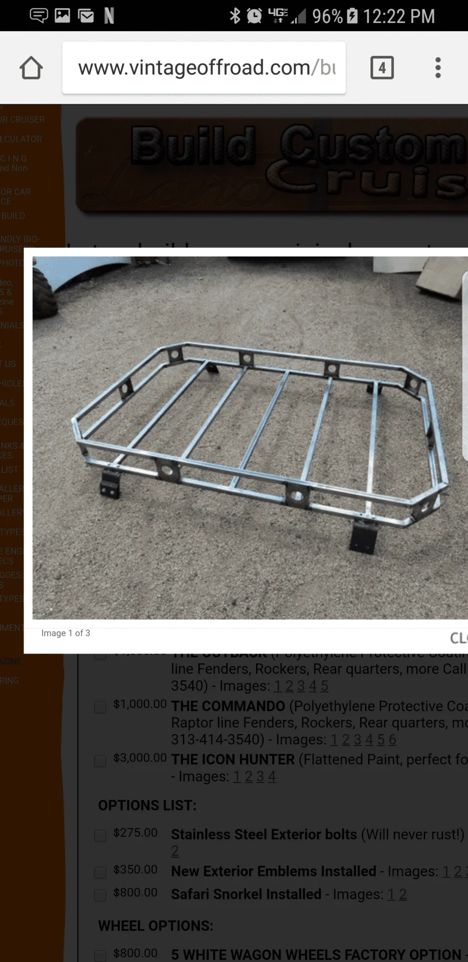

You are right. I was trying to visualize how the squared angles would look against the roundness of my 40. I just YouTube'd " how to bend square tubing. Looks easy enough. Also saw this rack made vintageoffroad. Not round angles but not squared off ones either.. just trying to think about putting my own little touch to seperate my rack from the rest. But then again, if it was that simple, it probably would have been done by now
The other point is that square corners are more likely to grab things - such as tree branches and limbs - where a rounded corner is more likely to let things slide by.
Round in the front, square in the back?
that looks pretty slick,, i like it. my brother is CAD designer and gonna give him some ideas to play with. He designs lighting fixtures for hotels and such. Even some of the littlest changes he makes to his old designs make a huge difference.
