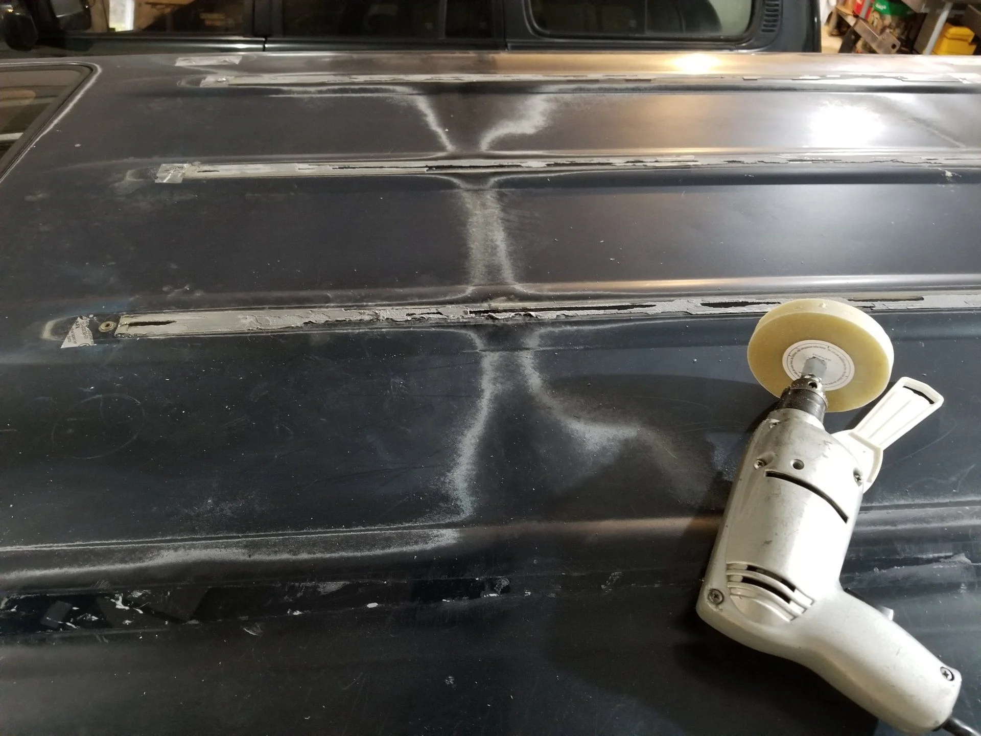

Did this today after failed attempts w/o searching first. The paint is already shot on my Cruiser and it gets wrapped Monday, so I just needed the adhesive off.
Scraper - plastic or metal - NO
Turtle Wax sticker remover - Kinda, but NO
Acetone - NOPE
3M Adhesive Removal wheel as Delancy suggested - YES
My tape was on there solid, saw some people talking about using 3 wheels, so I bought 3 and used 1.
I could use the Turtle Wax cleaner now and get it 100% clean, but its good enough for the wrap installer to clean it up if needed.
